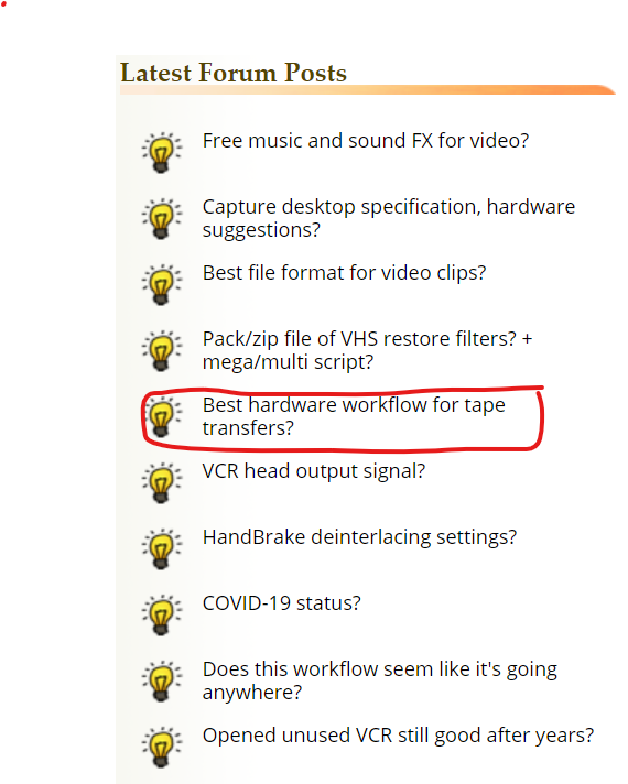

    Homepage of digitalfaq.com
    [Attachment 53261 - Click to enlarge]
    BTW, lordsmurf is an admin at digitalfaq!
