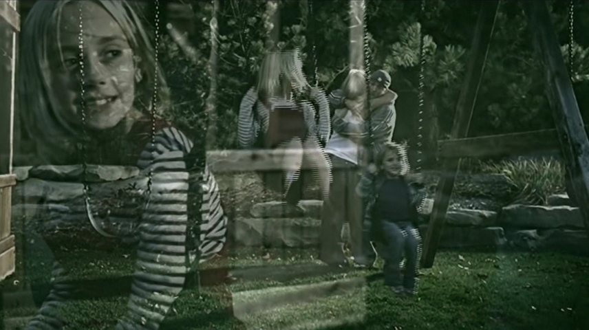

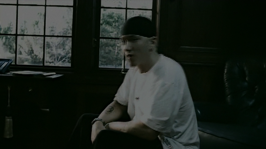

  1. I have a H264 encode of a music video from VEVO. This encode is sourced from the Universal Music Group master file. Apparently, someone at UMG or VEVO didn't deinterlace BEFORE resizing (my bets are on UMG because THIS master had the same problem) which leaves these horrible teeth or combing artifacts all over the video, but they are especially visible during fades, transitions, or scene changes. Perhaps this is a different phenomena then the post referenced above entirely and if so feel free to enlighten me, but either way, these artifacts are a pain and its the only thing making this video stand out from my collection. I was told before to use svpflow to interpolate frames. I'll take blending over combing anyday. It worked in some cases, however, often the artifacts would appear in sequences of 3 or more frames or the frame would be right before a scene change so it would it simply duplicate the frame after it, which ended up looking more noticeable then the combing. Is there anything, and I mean anything at all, that I can do remove or if not reduce the appearance of the combing? At this point, I am willing to pay to have the artifacts removed.
    Examples:
    [Attachment 52957 - Click to enlarge]
    [Attachment 52954 - Click to enlarge]
    [Attachment 52955 - Click to enlarge]
    Video:
    https://drive.google.com/open?id=1ASYICq9-e-mCx1sWrtIKnnrTiZ3nrCI0

    Perhaps you don't see the combing. I know that the fades are intentional... I changed the first picture to a better example. The second one its on the girl on the swing.

  7. The cure is probably going to be worse than the problem. To get rid of those comb artifacts will require downsizing to a height that blurs them away (about 160 lines) then upscale back to full height. That will leave you with a blurry picture and blend deinterlacing artifacts. Since it's only a few frames here and there you can try using a smaller height (a size that results in near normal comb artifacts) as a test clip with the runtime filter IsCombedIVTC:
    LSmashVideoSource("1.mp4")
    patch = Spline36Resize(width, 160).Spline36Resize(width, height).Subtitle("patch") # subtitle to make the patched frames stand out.
    testclip = Spline36Resize(1920,328).Sharpen(0.0, 1.0)
    ConditionalFilter(testclip, patch, last, "IsCombedTIVTC")
    #Overlay(last, testclip, y=32) # for debugging, so you can see the testclip
    You can try using different heights and sharpening for testclip. Enable the Overlay() line to show the testclip over the resulting video. That caught most of the frames with residual interlacing. It also screwed up a few frames without interlacing because something in the picture fell in the right frequency range. You might also try using a mask of where the comb artifacts are to limit the patching to just those areas.
    [Attachment 52975 - Click to enlarge]
    The video probably also needs decimation down to 24p.
    Thanks! I would much prefer a slightly blurrier frame
    I have a question. The video was originally SD (854x480). Should I de-bicubic down first before I do this?
    And if I do masks, it would probably be in another video editor, though.
    Also, when I use tdecimate(cycle=25) there are still a considerable amount of jumpy sections do to left over duplicates. Any ideas on how to fix this?
    Also, just for future sake, do you know the technical reason why this happens during fades and scene changes? I probably wont understand what you say, but you can try lol.
    Also (sorry lol), what about the frames that it dosen't detect automatically?

  12. Whatever the OP is seeing here is pretty subtle.
    I disagree that its subtle. And its not just me seeing it. Everyone in this thread has seen it.
    I'm pretty certain it was never interlaced in the first place
    How is there combing if the source material was never interlaced?
    Also, thanks for clarifying it wasn't a result of resizing before deinterlacing. But does that mean this thread wasn't either?
    OK, with deinterlacing turned off, I do see some slight combing during the transitions
    Wait... so if you have deinterlacing ON you don't see them???

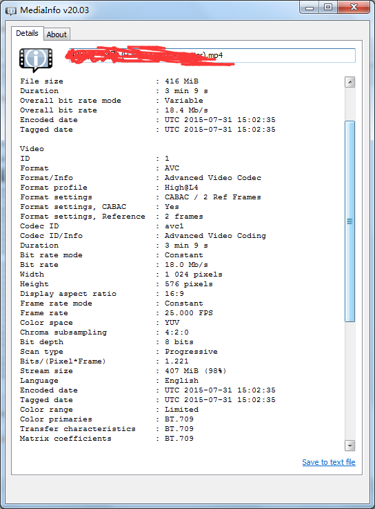

    I'll add a few words since the OP was courteous in his response.

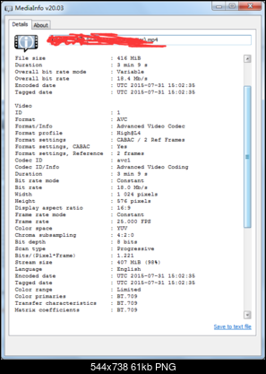

    I checked the VEVO link. Maybe 854*480 is the original (just as with that other promo) but it is actually the only one that my capture software did not pick up. But it did pick up 640*360,960*540,1280*720,416*234,480*270 AND 1920*1080.
    I did, out of interest, grab the 1080p version and, yes, it is 25fps but, strangely, the bitrate was slightly lower than that available above. And the final file is 162 mb
    There is even a 1920*1080 mpeg with vbr naturally higher than the AVC. And the vid is over 500 mb.
    My obvious conclusion is that it is VEVO (just as yt does) that does the re-scaling. It may even, in this case, have screwed up with the frame-rate. Maybe the label was instrumental in cropping from an original 4:3 'Master' or maybe even VEVO can also do that on-the-fly.
    I realise that little, if any, of this helps you but this was really for my own curiousity. I even now wonder if that other promo is also available from this source.
    Yeah, I'm pretty sure UMG sends out a master file that is 854x480 to all of their partners (youtube, vevo, etc) and vevo in this case made different conversions with a corresponding bitrate, similar to YouTube. However, unlike youtube, vevo automatically upscales SD sources as opposed to simply having a higher bitrate.
    There is two 1080p versions you can grab. One with a bitrate of 4200 and one with 5200. I think you just grabbed the wrong one.

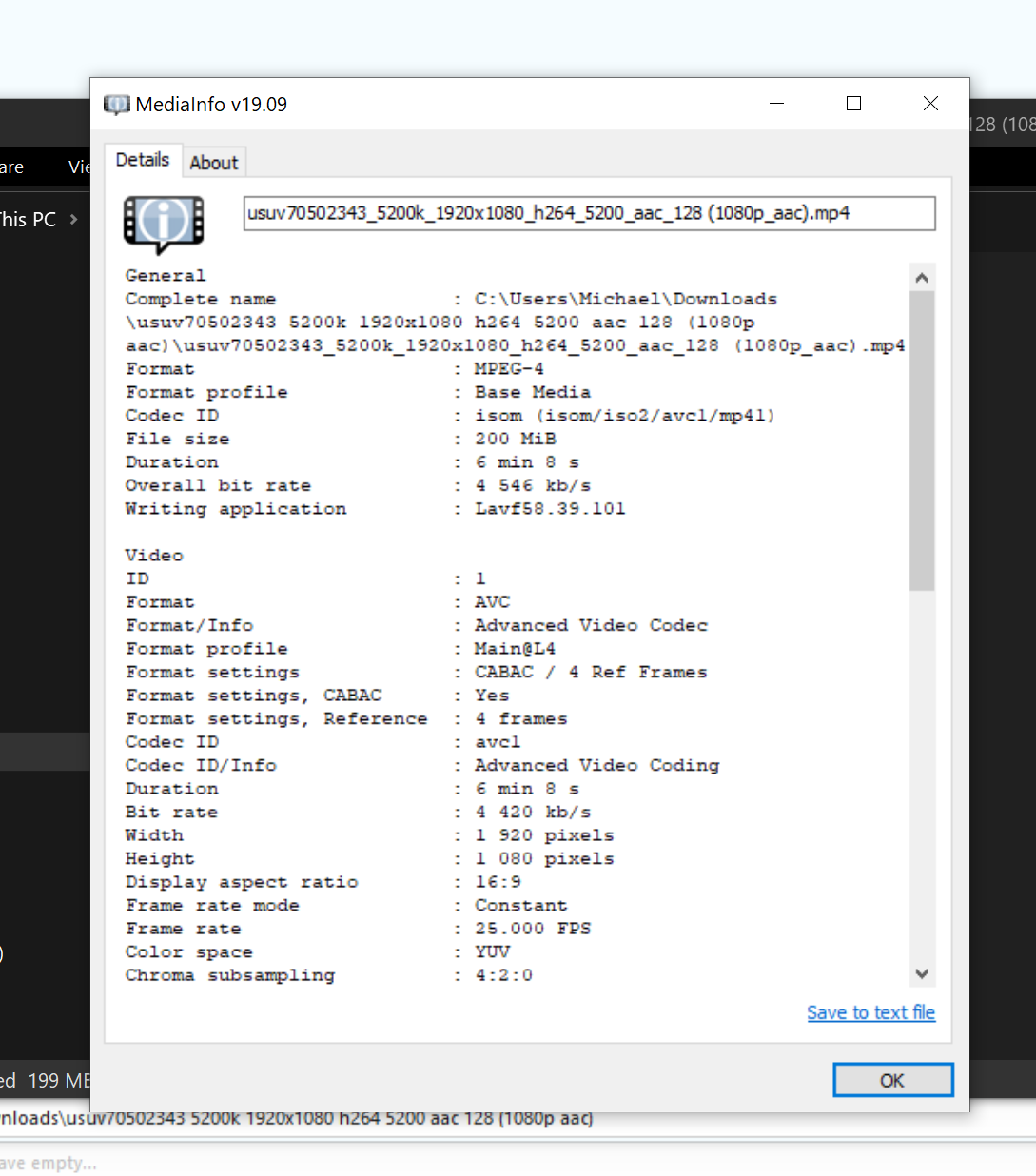

    Yes. The 4200k is the AVC. The 5200k is the mpeg2. There was no reference to another AVC to give a file size of 199mb. Yet those numbers are misleading since the mpg2 has an avg bitrate of 11mbps.

    Music videos like this are typically telecined from film then edited as video. Shots are slow down or sped up as interlaced video to match the music. So you can't get smooth motion of all shots at 23.976 fps. This video has the additional problem that it was partially inverse telecined and converted to 25 fps with an addition frame every 24 frames. If you had the original 30i video you could smart bob it to 60p. But you don't.
    My guess in this case is they had a mix of telecined film and 30i camcorder video. Then cut/pasted without consideration for the pulldown pattern and crossfaded between shots as 30i. So it's not possible to cleanly IVTC blended sections.

    There is a very slight variance between my 1080p AVC
    This is the 5200K that I downloaded
    http://22-fa-168198817351468082649c6ba82cee92.vip2-ams1.dlvr1.net/35593fc2-89ef-11ea-a...0_aac_128.m3u8
    and despite the link stating h264 it is mpeg2 unless mediainfo has it wrong (yet they recc the others as AVC so that is unlikely)
    None of this really matters though
    I did check out the other promo now with this new link and all the versions available are mpeg2 AND 25fps. Weird.
    ??? im not sure whats going on here? can you send me this file???

    Is it the vevo still existed?
    I'm in China.I wanted to collect the HK vevo MVs,but I couldn't connceted to VEVO even in a HK route or USA route VPN.
    It will turn to youtube when I click the links like "vevo.ly/xxx"
    As I know,there are some ways can download high bitrate files in vevo.com.I get a file of this kind from others and I know the file is from vevo.com certainly.
    But nobody would tell me the secret of download methods.
  25. Originally Posted by hintlou View Post
    [Attachment 52987 - Click to enlarge]
    [Attachment 52988 - Click to enlarge]
    If there is a way to get a higher bitrate from VEVO, I would love to know, but I don't.
