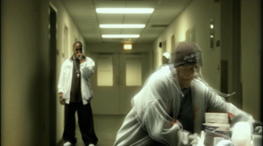

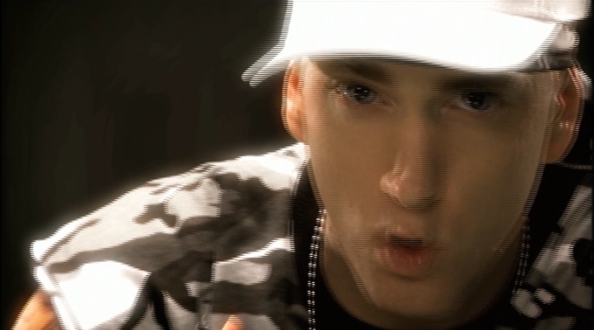

  1. I've been restoring some old Eminem music videos and I came across an AVC master of "Like Toy Soldiers" which looks much better than the VOB dvd rip.
    The only problem is this master seems to have combing in it even though mediainfo reports it as a progressive stream.
    Just in case it was lying, I ran QTGMC anyway and the artifacts are still there. I then RAN tfm() to see if it was telecine artifacts, nope.
    I can only assume it was poorly deinterlaced.
    Is there any way I can remove these artifacts or at least suppress them?
    Here is my AviSynth script now where these artifacts are still present:
    FFmpegSource2("1.mkv", atrack=1)
    TDecimate() #restores to film frame rate
    nnedi3_rpow2(2, cshift="Spline64Resize", fwidth=1920, fheight=1080) #upscale to 1080p
    LimitedSharpenFaster() #sharpening
    The video: https://drive.google.com/open?id=15koLCH0QKexBSq1P6xr7e1LGPBHvmgzy
    A compressed version: https://drive.google.com/open?id=15Q70RCSwBTdPnLiowTdSGyEYd4LkX3WR
    The artifacts I'm talking about:

  5. The video in post #1 was resized vertically while still interlaced. So the two fields can no longer be properly separated for deinterlacing.
  6. Originally Posted by jagabo View Post

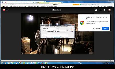

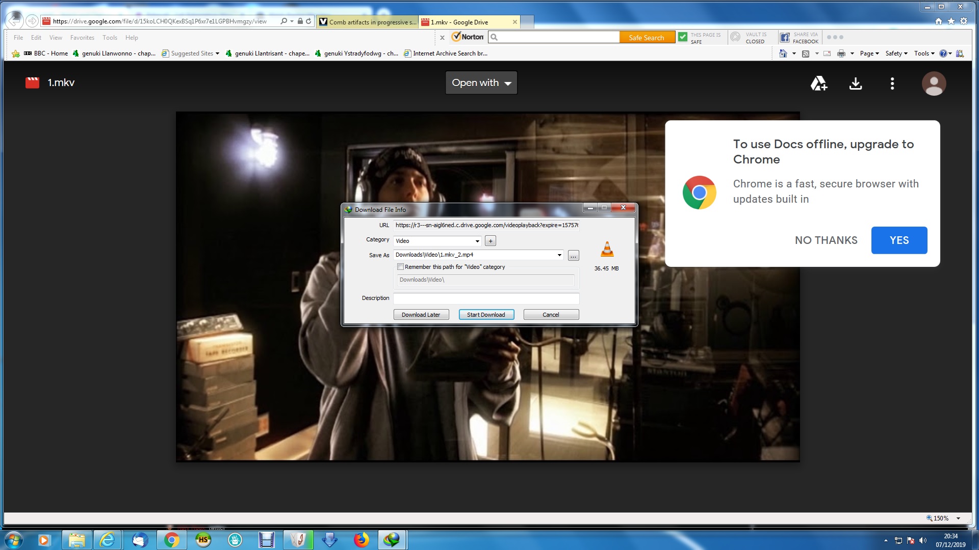

    Now do check out the screen I see when I go to download the 'original'

    Lol that is simply incorrect. Download the video with chrome and click the white download button. Perhaps its time to stop using IE.
  15. Member DB83's Avatar
    Jul 2007
    Ok. IDM was downloading a 'conversion' by Google for playback purposes.
    Just getting the original upload now.

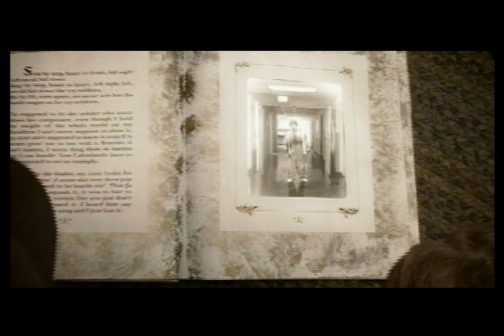

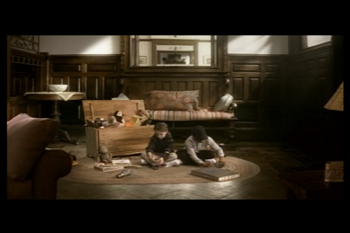

    Ugh I guess I have to prove it.
    The DVD rip is here: https://drive.google.com/file/d/1bweDaclNbjQZE-giZSQBoOz9CoI5ZsbY/view?usp=sharing
    Screenshot from the DVD rip:
    Screenshot from the master:

    You're saying the screenshot of the VOB that is 720,480 resized to 1920,1080 would be the "correct" aspect ratio?
    My point was: you said the DVD rip is of equal quality, and I proved you wrong. What are we discussing?
    A master is something to be transcoded to other formats so logically the video should look the best and the audio should sound the best.
    I think the record label / whoever has the original analog transfer encoded it, I don't think they distributed it. Things like this are retrieved from online trading or buying.
    I forgot what we are even discussing it's almost as if your lowkey changing the subject.
