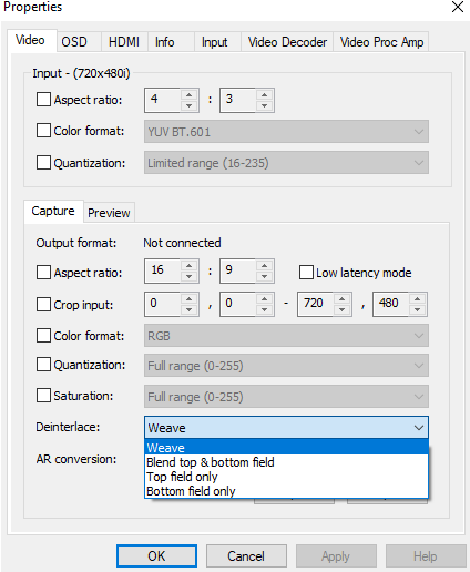

    Video>Capture Filters>Video in VirtualDub show a "Deinterlace" option with no checkbox and no option for leaving interlaced:
    [Attachment 52943 - Click to enlarge]
    Am I looking at the wrong menu option?
  2. Weave is the option you want.

    That was the secret... "weave" means "interlaced." Changed to look at 500 frames:
    [Parsed_idet_0 @ 0000018f5670abc0] Single frame detection: TFF: 180 BFF: 0 Progressive: 0 Undetermined: 321
    [Parsed_idet_0 @ 0000018f5670abc0] Multi frame detection: TFF: 485 BFF: 0 Progressive: 0 Undetermined: 16
    Thanks for getting me past that hurdle!

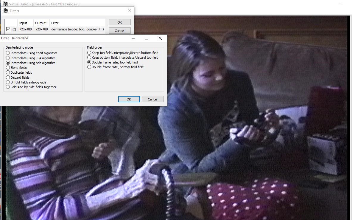

    By the way, VirtualDub seems to recognize the file as interlaced, since it seems to properly deinterlace in "Preview" using Bob.
  6. On second thought... maybe not "properly." This is a "deinterlaced" screen capture from the VirtualDub2 "Output" display. I know the lighting is terrible, but that applies to a lot I the material I have to work with. Maybe the sawtooth edges are inevitable?

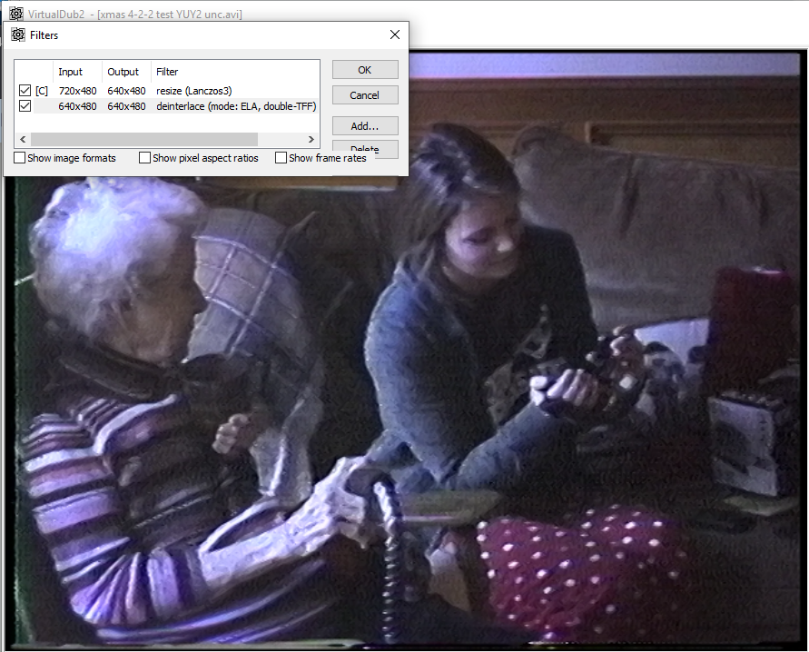

  7. Sawtooth edges eliminated using ELA deinterlace:
    [Attachment 52958 - Click to enlarge]

    Is the Magewell capture card impacting quality of the archived video by not giving a "no deinterlacing" option and doing weave "deinterlacing?" This would be very disappointing...
    I don't see a "no deinterlacing" option in the pulldown you pictured, only Weave, Blend, Top field only, Bottom field only. Of those only Weave is lossless -- it contains all the information that was captured.
