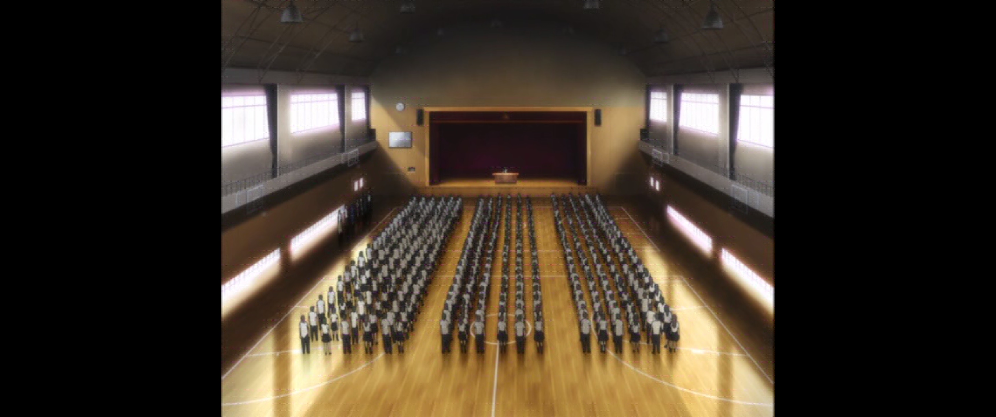

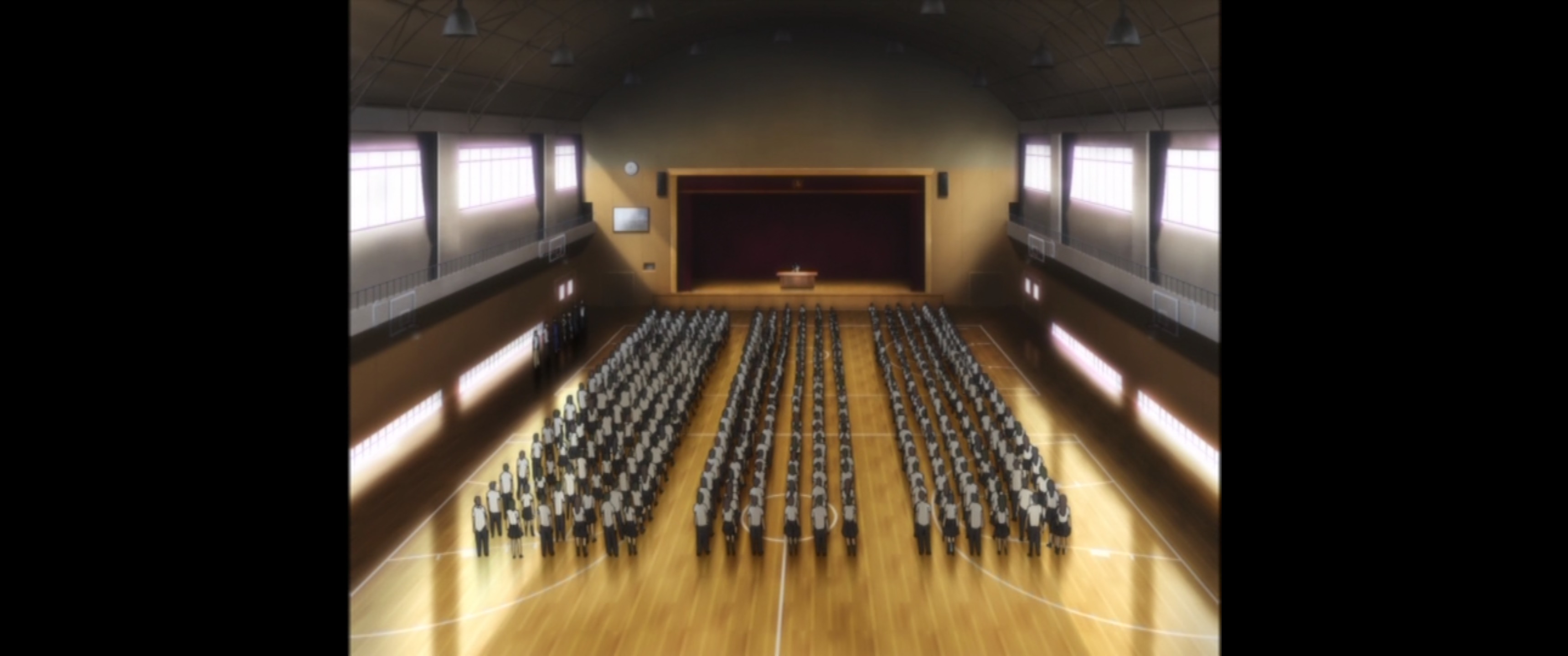

    I'm trying to rip an anime series and this is my first time dealing with the whole encoding process. As of right now I've ripped the first disc of the series and I'm not happy about the quality. I've been browsing the forum and seeing people say things like "Handbrake isn't enough" and "Use AVISynth+QTGMC" for best results so I figured I'd reach out for some help.
    I attached a couple of photos (one of the DVD, and one from the copy) to this post so everyone can see what's going on. My biggest issue is I'm getting these weird lines + blocks in the image which I'm assuming is a de interlacing issue. I also attached a log from handbrake so you can see what settings I used.

  2. Those are probably aren't deinterlacing artifacts. Post a short sample of the original DVD video (not reencoded) and your reencoded video.

  15. Your "Encoded Sample 2.mkv" doesn't show the distortions in your original post. If you are still seeing those distortions when paying that video you have a playback problem.
    Also, the DVD has simple 3:2 pulldown (though it wouldn't surprise me of some other parts of the video is different) so it should be encoded at 23.976 fps. That can usually be done adequately with Handbrake.

    "Encode Example 3.mkv" does not show the distortion in the image in your first post. Again, you probably have a playback problem. Try turning off hardware decoding in you media player.
