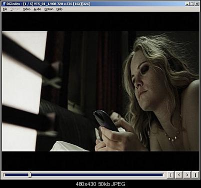

    1. Create a folder in your PC called "DGindex".
    2. Download DGMPGDec into that folder. Get it here: https://www.videohelp.com/download/dgmpgdec158.zip
    3. Unzip the downloaded .zip into the DGindex folder.
    4. Open the folder and double-click DGindex.exe to run it.
    5. In the DGindex window, upper left, Click "File" -=> then "Open"
    6. Navigate to your MPEG or VOB file, select it, and click "Open"
    7. You'll see a new window with the path and name of the file you selected. Click "OK".
    7. You will see an edit window like this one, with the first frame of your video:
    Scroll thru the video with the scroll control along the bottom.
    The "<" and ">" keys on the lower right will move the video in groups of keyframes. Move to a keyframe in the portion of the video where you want to begin your cut ("<" and ">" automatically stop only on key frames). Mark the start of your cut by clicking "[". Now click the forward ">" button until you have several seconds of video, then click "]" to mark the end of your cut.
    When you've selected your cut, click "File..."-> then "Save Project and Demux Video".
    Voila! In a few seconds you will have a few new files in the same folder where your video is located. There will be a .d2v file, a .log file, and an .m2v file. The m2v is what you want to post here. Forget the other stuff.
    Log into the forum and start a new reply in this thread.
