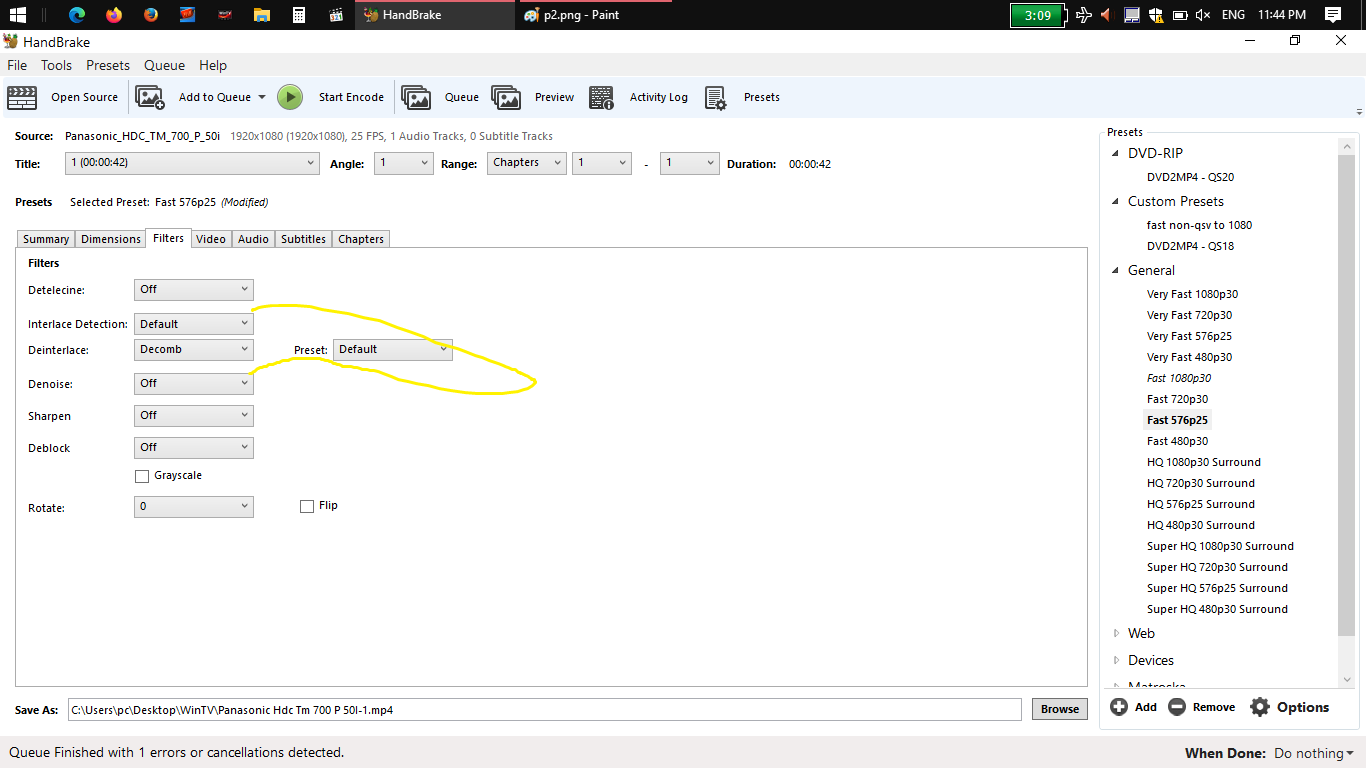

    1. Use handbrake.fr and push it through.
    You can use a standard preset, but to keep the most quality, go to the video tab and
    A.slide the quality bar up to 10 to 12.
    B. High, 5.1, film
    C. Frame rate - constant, same as original.
    Audio tab.
    Rather than reencode to aac, pass-through.
    First tab, no automatic crop. Custom with 0,0,0,0 for top, bottom, left, right.
    That'll general give you a good mp4 for editing.

    Deinterlacing in Vegas isn't always that great.
    For weddings I've done, depending on motion, sometimes blend is better, sometimes interpolate.
    Check the moving people and scenes to compare.
    If you reencode first in handbrake , Adobe media encoder, etc, the deinterlacing is much better.
    Upper = top field. But you'd notice right away with anything moving - jagged edges - if you get this wrong.

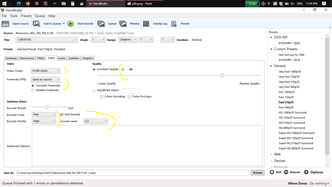

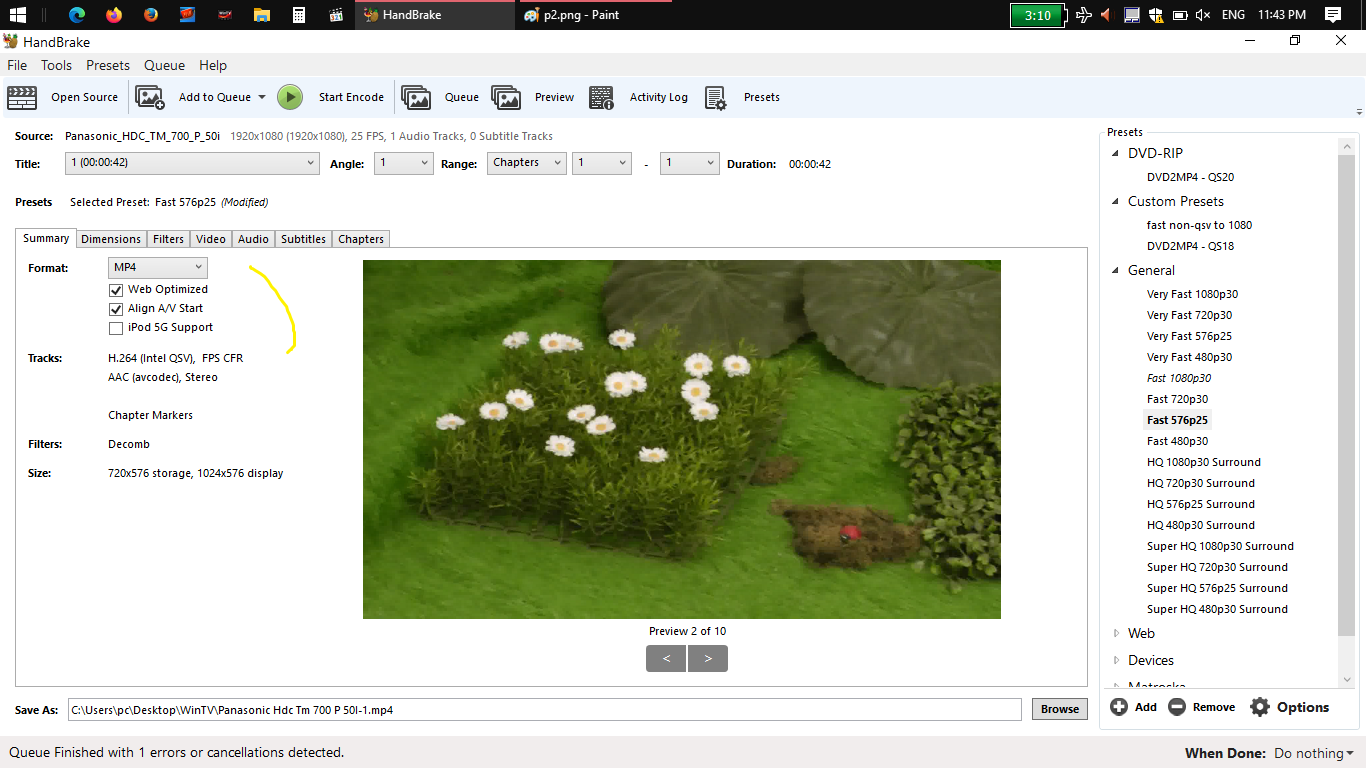

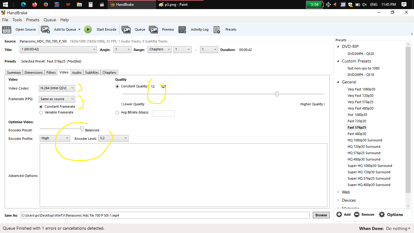

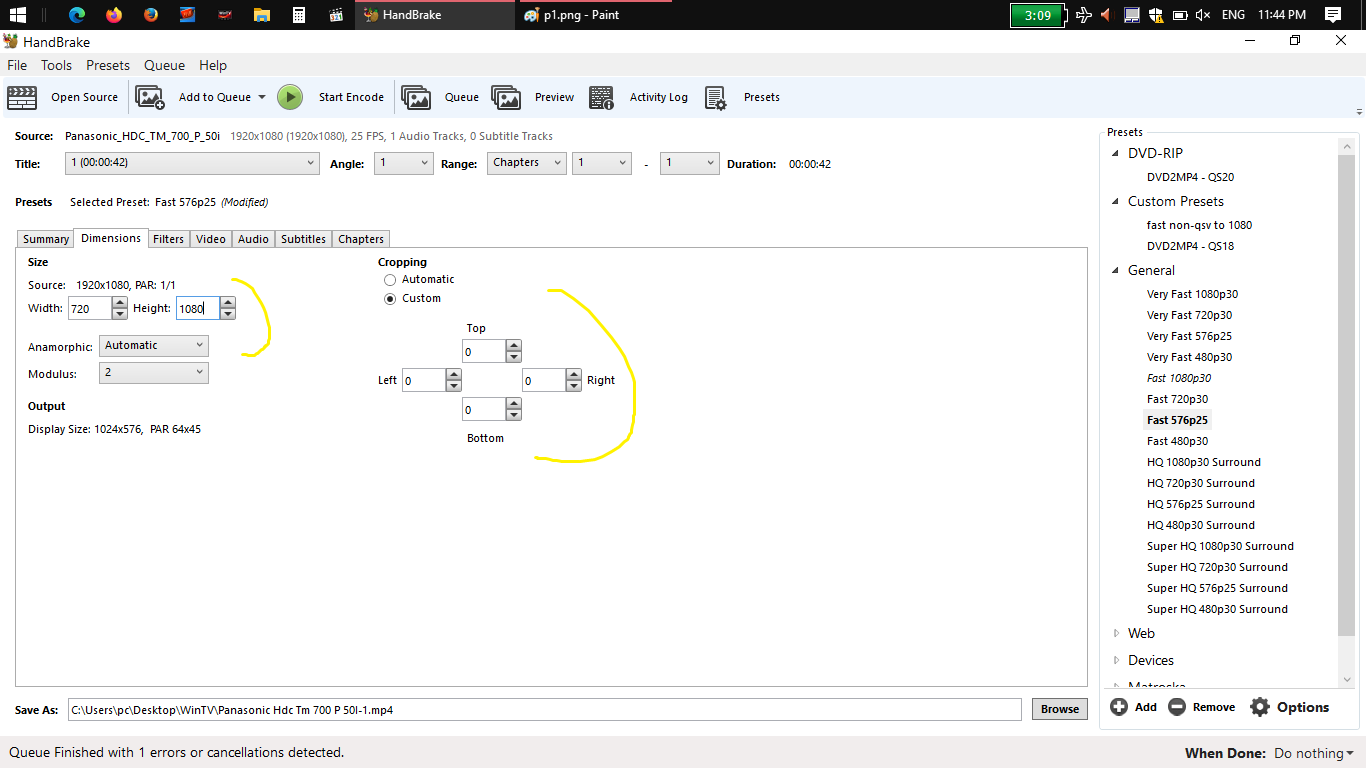

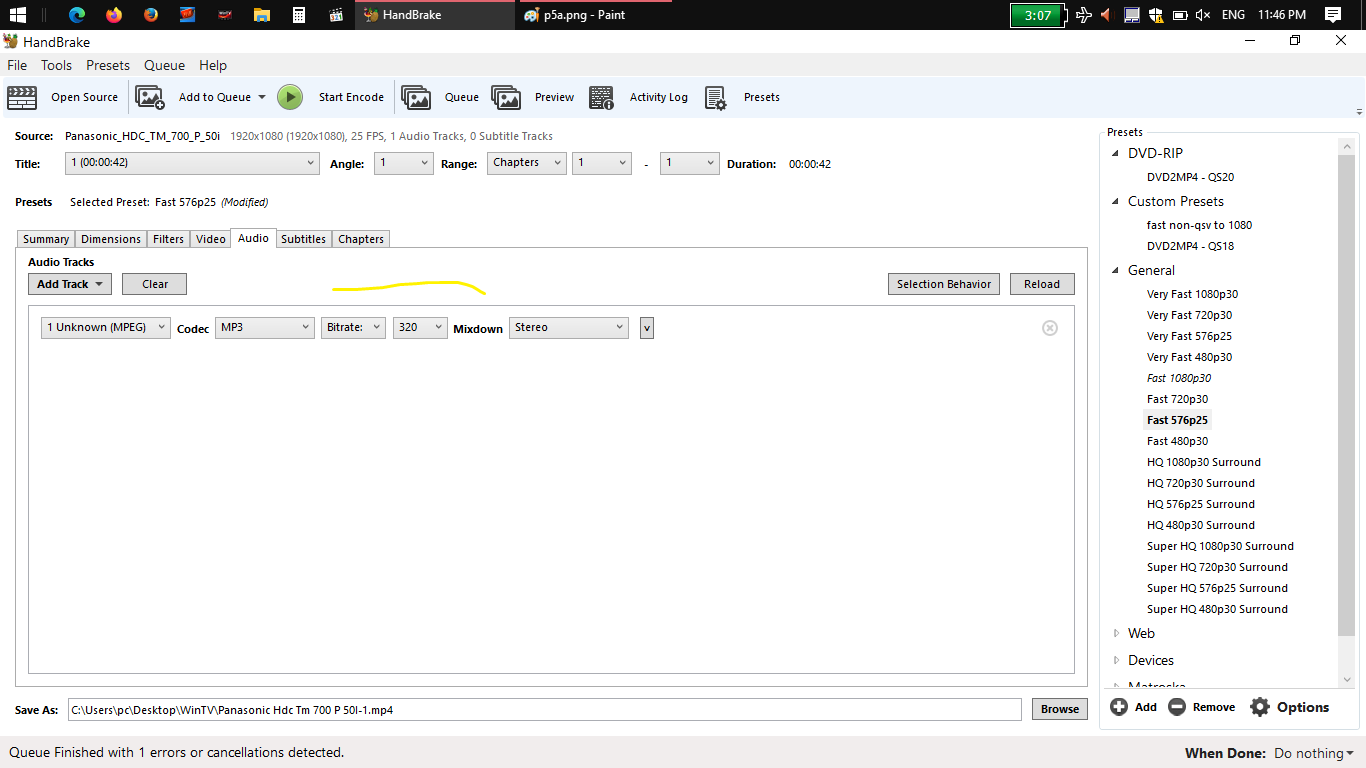

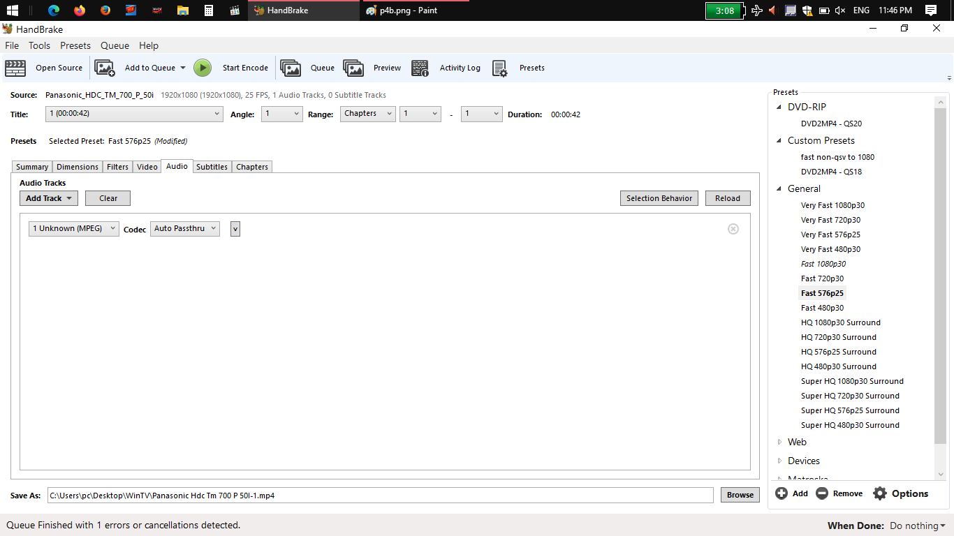

    If you have an Intel Quicksync capable CPU, you can accelerate the encode significantly (minutes instead of hours) by turning on Quicksync in the Handbrake settings, then picking H.264 QSV encoder. Otherwise, the default H.264 encoder works fine.
    Slide that quality up to 12 to increase the quality significantly - identical for most intents.
    (You can test all you want or just slide it up more to like 10, even 5.)
    HIGH 5.2 is important - this increase the MP4 encoder quality a lot.
    audio can be the original (test to see if it causes issues), or simply reencode to 320Kbps MP3 for maximum compatibility in a MP4 file.
    tested it with a panasonic hdc-tm700 pal video clip I found online, works fine.
  27. trying different settings in latest handbrake (also with 5.2 encoder level,...with no success.
    Windows on yellow house (sample clip) are just not same as original.
    Seems big drop in quality if ask me. FPS, quality bps do not matter.
    Regards,
    Boris.
  28. if using Video codec: h.264 (Intel QSV) there is no generated file. Only error in bottom line "Queue finished with 1 errors or cancellation detects.
    It's ridiculous how much time takes this finding of proper settings in my case .
    btw everything running on not top notch Pentium 4200, 1.1GHz (I know it is not kind a processor monster but rendering time is not crucial for me as running pc overy nights is not a problem)
    p.s. Babygdav thank you for screenshots...unfortunately ... ....
