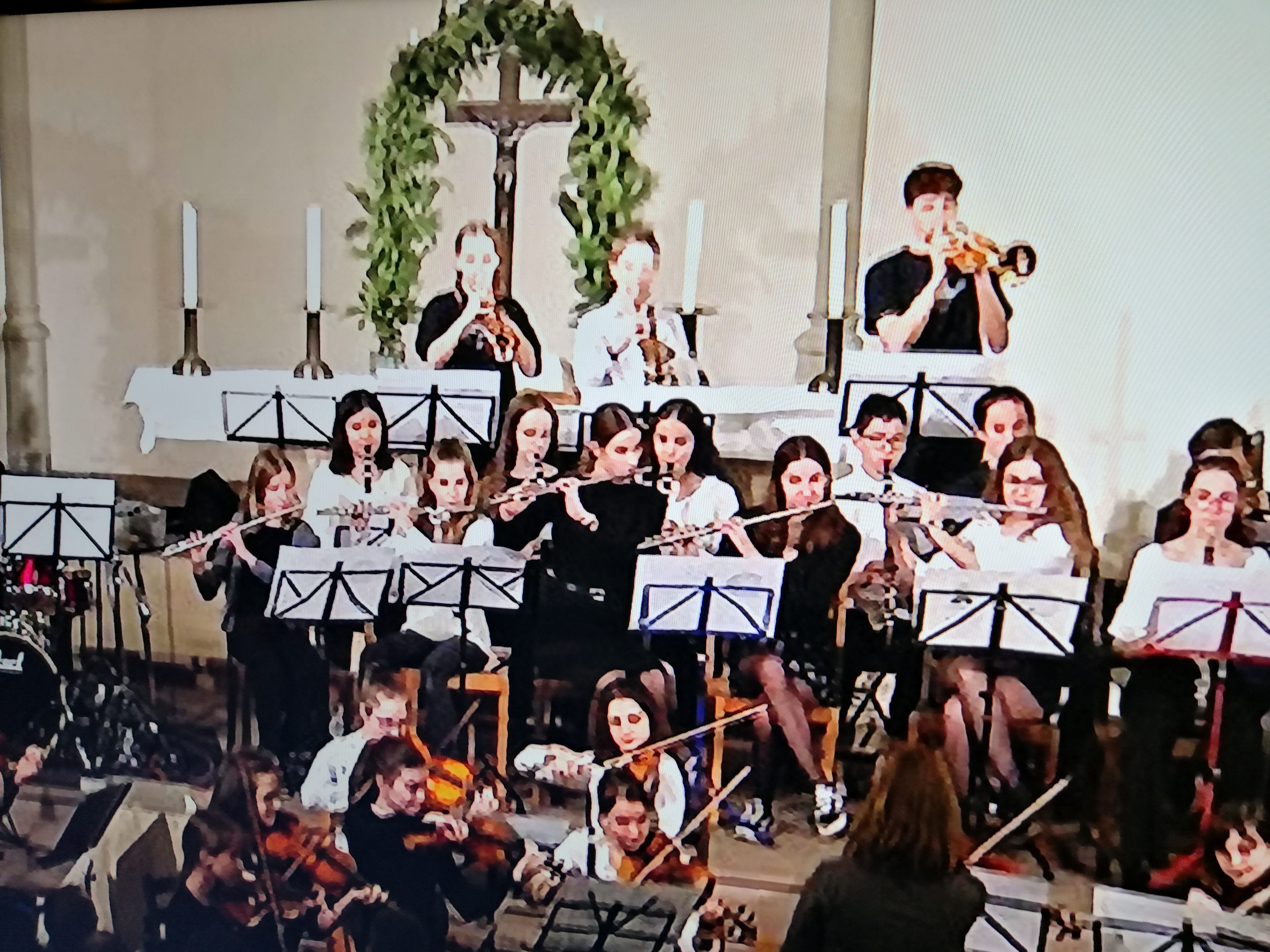

    The result on my 4K-TV was creepy again. I will try to attach screenshots from this horror show - look at the faces !!!
    To answer some outstanding questions:
    Of course I can do use some of the possibilities which babygdav mentioned, but what I want to do is to use this high quality footage to produce DVD with a sharp picture. Reason for that is, the this video was taken from a christmas concert of my sons school and want to give away some copies to the teachers who conducted the performances and some friends and relatives (as manono already correctly suggested). Since I do not know, if every one has a Blue Ray player (my mother is already happy, when she manages to send an SMS) I was looking for a medium that everybody can play - which is DVD.
    @manono: What kind of output would you need: the .mp4 of the second attempt is about 4GB and the resulting VOB is about 1MB
    the VOB of the first attempt is about 1GB.
    I'm really very thankful for all your comments and inputs, but I'm beginnign top think it is almost impossible to use 4K footage for producing a DVD - although commercial DVD do this. But what is the way ?
    Regards
    Delta

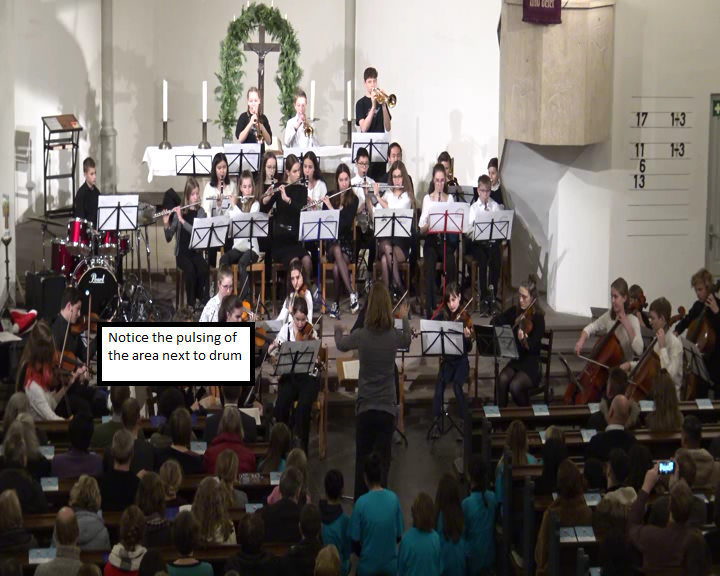

  13. Member DB83's Avatar
    Jul 2007
    But how did the initial mpeg files from avstodvd appear ?
    The above images are not at dvd resolution. They have been up-scaled but I guess your player and or your tv does upscaling better than this pc generated image.
    Now back to avstodvd. Just for one moment forget about VideoStudio and create the dvd direct in that program as a test for your player/tv or in another free program such as dvd-styler which will not recompress your video - it makes absolutely no sense to take VBR mpegs and re-encode them as CBR. There is already quality loss with the encode. And if you really must filter/stabilise then do not do it from mpeg but as high a definition as you can.

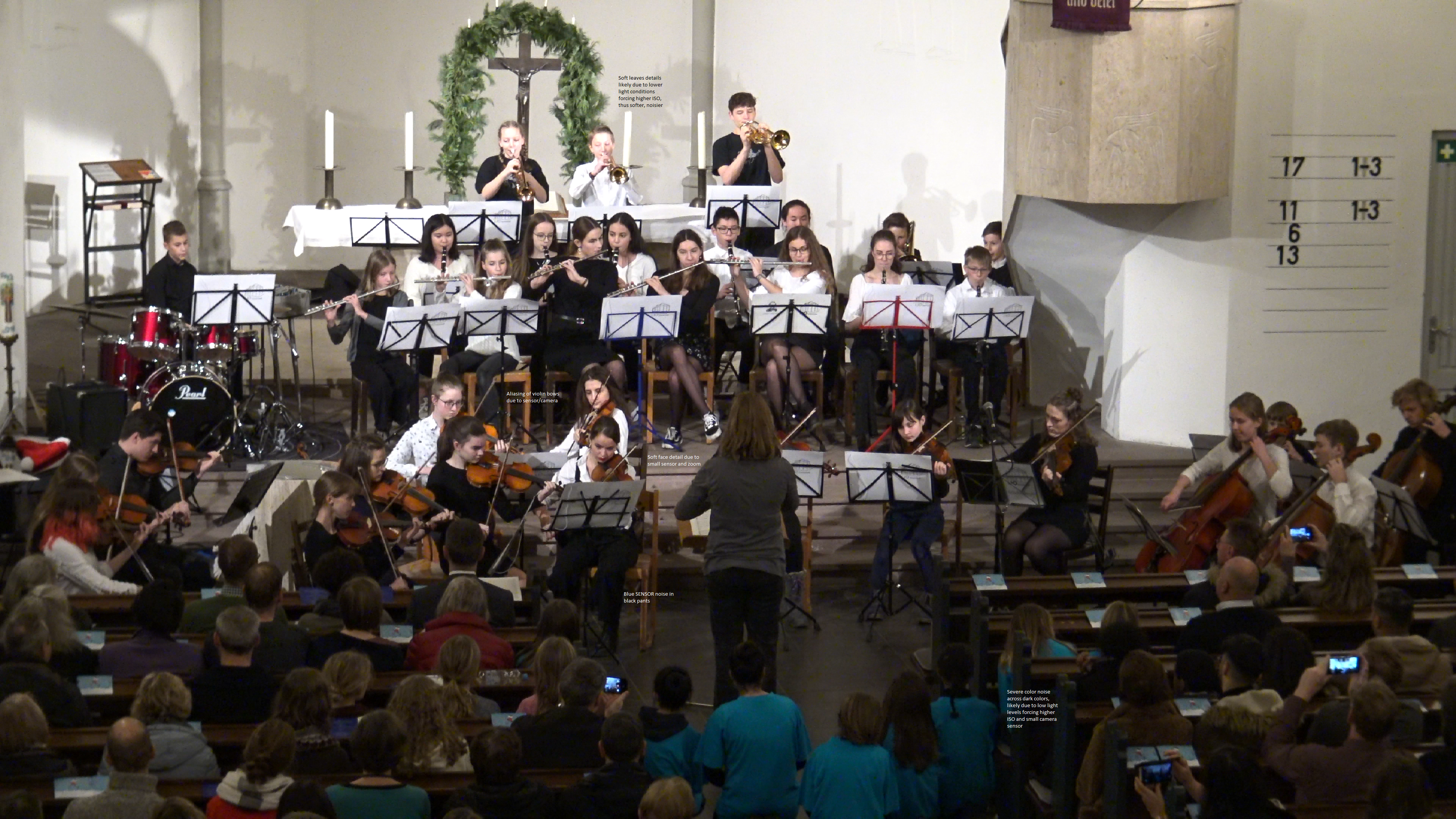

  15. Send a screenshot of your VideoStudio program when you have this project loaded.
    Are the two screenshots from the TV? Or from your PC monitor?
    For the video that we see in the screenshots, create a new project.
    Cut 10 seconds out of the clip around the scene we see.

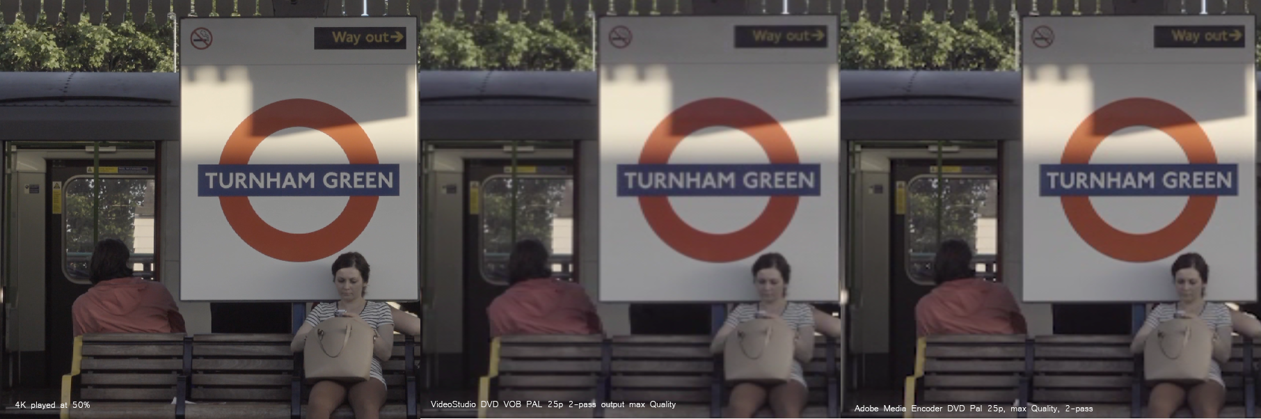

    Okay, I took another 4K Sony XAVC 25p file (RX100 iv 4K 25p SLOG 2 S-GAMUT Native 4K XAVC-S file) to test.
    The 4K video has the full 4K resolution and detail, so no worries about the input.
    imported it directly into the timeline of VideoStudio. (File -> Insert media into timeline, answer yes to adjust timeline specs to match footage).
    Verified it's at 4k (Settings, project properties, MPEG-4 Files
    24 bits, 3840 x 2160, 25 fps
    Frame-based
    H.264 High Profile Video: 99999 Kbps, 16:9
    48000 Hz, 16 Bit, Stereo
    LPCM Audio: 768 Kbps)
    Tested a MP4 export to 1920x1080 25p. Looks fine.
    Tested a DVD export to folder using both CBR and VBR with 2-pass modes, 8000kbps (Also, tried setting frame interlace output to auto instead of bottom/top field).
    Uh, oh!
    CRAPTASTIC OUTPUT!!!!!
    Vegas Video 17 output for Pal 25 FPS DVD on the left, Videostudio on the right.
    Look at the woman's shirt (one on the left on the bench). Or even the bottom of Turnham Green on the sign.
    CRAP! Can't see the lines on her shirt, bottom of the text is mushy.
    PROBLEM SOLVED!!!
    You're using a crappy program for DVD output.

    Originally Posted by babygdav View Post
    [Attachment 51361 - Click to enlarge]
    https://ibb.co/2WTmqRQ
    Frame-based
    Uh, oh!
    PROBLEM SOLVED!!!
    might just be a crappy de-interlacer on your video preview.
    mostly it looks ok for dvd spec video. you've only got less than 1/16 the resolution of 4k to start with and bad de-interlacing on top.

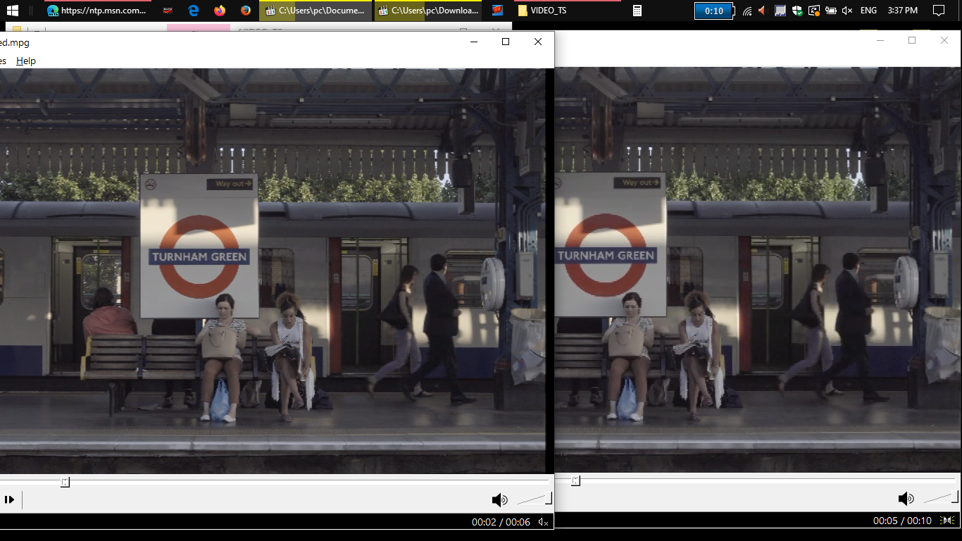

  23. Image
    [Attachment 51362 - Click to enlarge]
    Okay, here's a 25p (PAL non-interlaced) 10 second 4K sample input file to try out.
    I pushed it through both Adobe Media Encoder (output as MPEG-2 DVD 25p Pal using quality 10/max, render using best, VBR 2-pass, etc)
    and VideoStudio (output to DVD FOLDER - 25p Pal, quality 10/max, VBR 2-pass).
    100% playback, screen captured each three, layered them in Photoshop side-by-side with an area of interest to compare all three.
    Note that the 4K (left of three images) is naturally quite detailed and sharp - you can see the rivets on the roof of the train, the leaves of the tree, the wood grain in the bench, the stripes on the woman's shirt.
    Note that the DVD quality renders (middle, right) are both less detailed and sharp than the 4K.
    The difference is that the Adobe DVD render is sharper/more detailed in the leaves and the bench, and the stripes are less mushy/blurry when compared versus the Corel output.
    Anyways, if this is not the mushy quality you are talking about, take the 4K sample, drop it into your VideoStudio timeline (new project), then burn to DVD (25p, 2-pass, pal, VBR, quality 10/max/100% - you'll need to go into the DVD settings to adjust these).
    What does it look like on your TV?

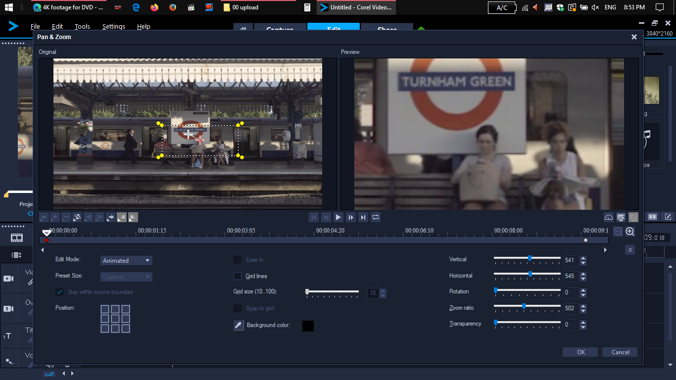

  24. Are you doing a "crop" / "zoom" in on a specific face or person in VideoStudio on that second photo?
    If you have converted the video from 4K to DVD resolution, then imported it into VS, then you're only working with a 720x pixel resolution video that cannot stand that kind of zooming/cropping. You'll need to go from the original 4K video, import that into a 4K timeline, then zoom/crop.
    (In the photo example, right is using a 4k input, cropped and zoomed in on, output to DVD - good. Left is using 720/DVD resolution input, cropped and zoomed, output - bad.)

    Hi all,
    here are my answers to the questions that arose since my last post:
    - the photos I posted are taken with my mobile sitting in front of the screen. On the first photo you can see a bit of my TVs frame in the upper left corner. The second photo is taken while zooming in with my mobile again. So thjis really what my 4K tv shows. These pictures haven't been processed on a PC and there is no "artistic wate color filter" put on - although I have to admit, that it looks like that...
    Insert DVD - press PLAY - press PAUSE - take photo with my mobile - that's all I did to get these pictures.
    The two screenshots are taken from the same (paused) scene, the second one is zoomed in with my mobile
    I made a new short video from the same clip with DVDStyler (see dvdstyler.iso) which looks the same kind of ugly on my 4K.
    I also put the DVD output from AVStoDVD (see DVD_from_AVStoDVD) on the drive, which also looks horrible.
    Please find also the video made from the station clip together with the photos I again took with my mobile in front of the TV screen.
    Could it be, that what I see is not caused by my video editing but by my BluRay player or my TV ?
    But I checked all the settings on both devices and it made no difference.
    And why do commeercial DVDs look normal.
    When comparing my videos to babygdavs station4k.MP4 or stationDVDadobe.mpg there are worlds between !
    Any help is highly appreciated !

    [Attachment 51385 - Click to enlarge]
    1. There's nothing significantly "wrong" with the source given the sensor size and age of the camcorder.
    It is a 5 year old model that uses a standard 1/2.3" point and shoot camera sized sensor, attempting to produce 4k video.
    The areas I've noted in text in the screenshot of the original video show you what areas of the image suffer due to the small size, low light, etc.
    ie. The only way to improve future videos (better 4K detail, lower noise) is to upgrade to a 1" 4K Sony Camcorder, or better, far larger 4/3rds/APS/Full-frame dslr camera with 4K video.
    2. When downsizing video (eg. going from 4K original to 2K or DVD output), much of these noise and other artifacts are eliminated or reduced due to the way downsizing works (blends things together).
    So, for your DVD output (in the ISO you provided), it generally looks fine and as "detailed" as you can expect for a DVD and your source video.
    ie. It looks like a very good home video on my TV.
    3. The VideoStudio encoder does produce artifacts on its own.
    [Attachment 51388 - Click to enlarge]
    If you examine the dark area to the right of the drum (play it on a PC, 200% zoom if needed), you can see that this area PULSES.
    This pulsing is not present in the original video, so it is something the VideoStudio encoder introduced.
    Besides this very visible artifact however, the rest of the video looks like any regular home video on the TV.
