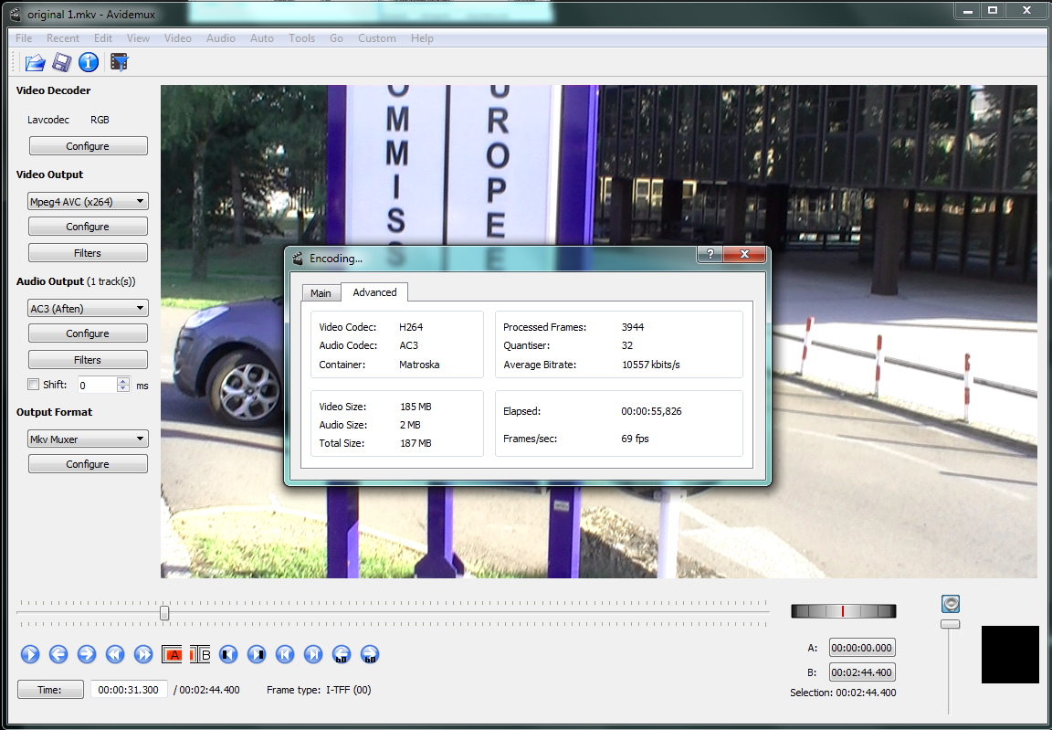

    it took 4 minutes with an old i7 2600k.
    [Attachment 52618 - Click to enlarge]

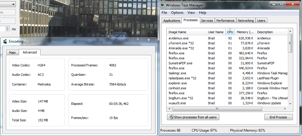

    I uninstalled my old Avidemux and installed the newest version listed on this site. I don't know if it deleted my Preferences. The x264 profile it loaded was Custom based on ultrafast. Then I changed those 2 settings you mentioned.
    Approx 5m37s using this old Win7 machine built in... 2010? AMD Phenom II X4 965 BE, 8GB DDR3.
    [Attachment 52619 - Click to enlarge]

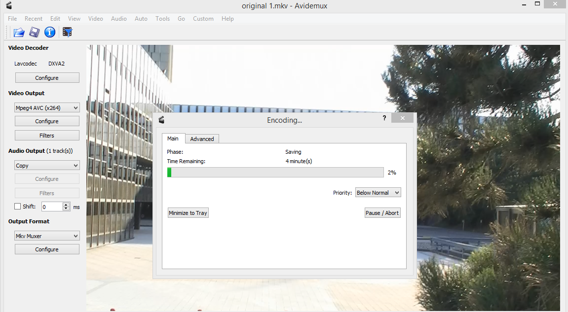

    Avidemux 2.7.1 x64
    After the input from jagobo about default being x264 Medium, I just manually used medium x264 - tuning none - profile baseline - IDC level 4 - crf 23
    Encoding time was just a few seconds under a minute. (around 58 seconds)
    AMD R5 3600
    [Attachment 52624 - Click to enlarge]
    If I change the profile from baseline to high, I have an encode time of 1 minute 8 seconds.
    Through the encoding I only got around 80% CPU usage which is unusual for me with x264 on medium, but I don't ever use Avidemux.
