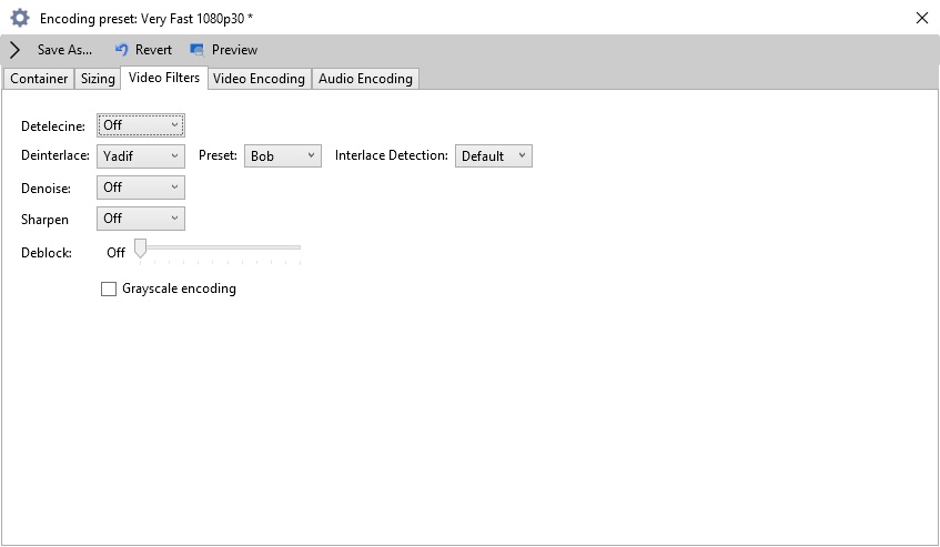

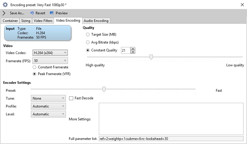

  2. Maybe the problem comes from the Variable Frame Rate of the 'original' (reported as 50/25fps). Is the original file from your camera really an .mkv?
    Mar 2008
    Possibly the TV doesn't like the MBAFF scan type (just a guess). I played them on my 2017 LG 4k TV
    and they both looked good.
    Here's a small section converted to Progressive @ 50 fps, encoded in Vidcoder
