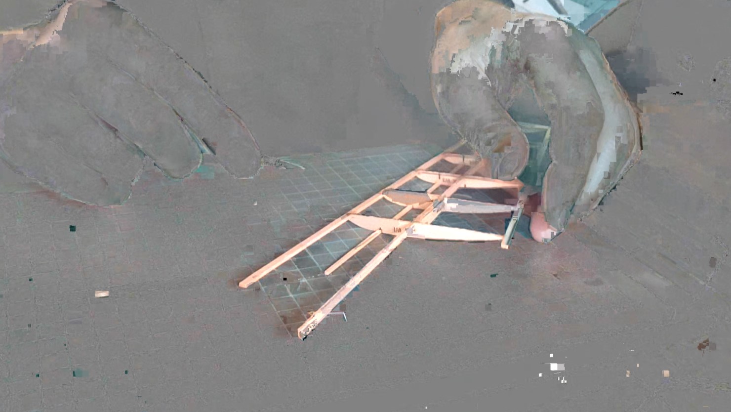

  1. This is very weird, I've recorded probably hundreds of videos on my S8 and downloaded them to my PC (Windows 10) with no problems. Yesterday I downloaded five short videos to find when playing them they suddenly go all sort of reverse image for a second or two then return to normal then reverse image again. The sound is ok.
    I've recorded test videos now on the SD card and the phone's memory and they play correctly on the phone but once transferred to the PC the problems begin. From this I deduce it's the PC that's at fault. I've changed nothing from the day before when the downloaded videos played as usual with no problems.
    Could it be some sort of driver issue?
    Any ideas, I'm at a loss?!

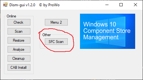

  5. Check your pc whith my Dism-Gui. Do a systen file check (see pic below). Then do a scan of the component store (scan, on the left).
    https://forum.videohelp.com/threads/396496-Dism-Gui-Maintenance-of-Windows-10

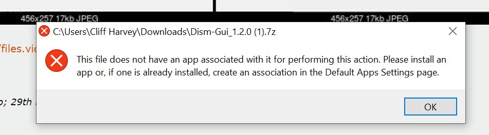

    Thanks, but what do to do with this?
    [Attachment 52610 - Click to enlarge]
  8. Image
    [Attachment 52611 - Click to enlarge]
    Originally Posted by vaporeon800 View Post
    Originally Posted by cliff1959 View Post
    Here's a clip anyway
    https://youtu.be/_ILd-yoWIrQ
    I did notice by the way that the pixeling starts to occur around my mouth and eyes, ie the bits that move the most before the whole image goes awry, then returns to normal, them goes again etc.
    A YouTube post won't help with diagnosis, due to their re-processing. Needs to be an attachment to the forum. ("Go Advanced" -> "Upload files/Manage attachments".)
    And yes, what you're describing is the effect I expected. Something like https://www.youtube.com/watch?v=7-lGmErj3t4 ?
    Video from my phone
    new test video.mp4
    This instantly pixelates on my pc.
    Rather oddly, the video I took the day before is fine, could my pc have updated and changed something, it's just the video from today!!

  12. Thanks, but what do to do with this?
    [/QUOTE]
    This is a compressed container, like ZIP od RAR. You can open it with 7-zip.
