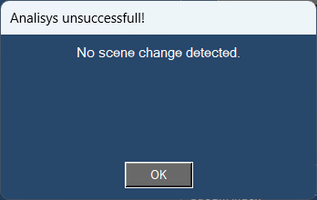

    v3.4.6.11 feedback
    Not sure if this was mentioned earlier .. but
    'Analisys' should be 'Analysis' .. and
    'unsuccessfull' should be 'unsuccessful' .. one L
    Technically, the analysis completed [was successful], but detected no scene changes,
    so, may be, change the box title to just 'Analysis' or 'Detection Unsuccessful'.

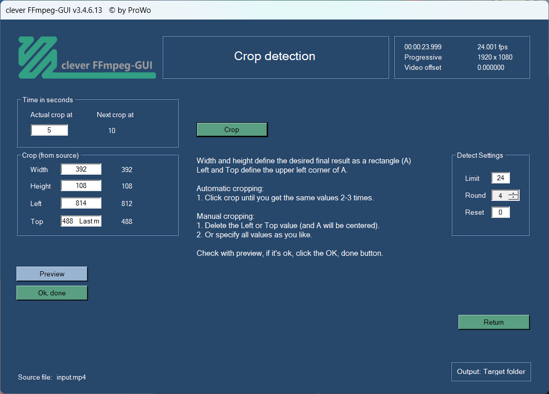

  7. Strange value in Crop -> Top, use crop detection. The test file has been cut with the app.
    [Attachment 89351 - Click to enlarge]
    The entire text: "488 Last message repeated 1 times"
    The preview cannot be played until the characters are deleted.
    Of course video encoding doesn't work either.
    (link removed)

  9. Originally Posted by Findu View Post
    Thx for the hint and the test file, never seen this, but I'll fix it.

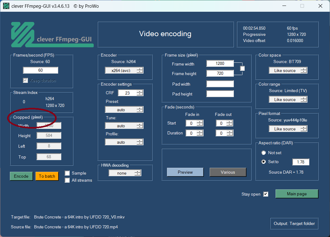

    Video encoding page:
    The frame text "H accelerated decoding" should be "HW accelerated decoding" or "HWA decoding".
    Could you move the entire encoder settings frame up a little so that the HWA frame can grow in height?
    And can you also add (pixel) to the Crop frame text.
    Will be done.
    Where?

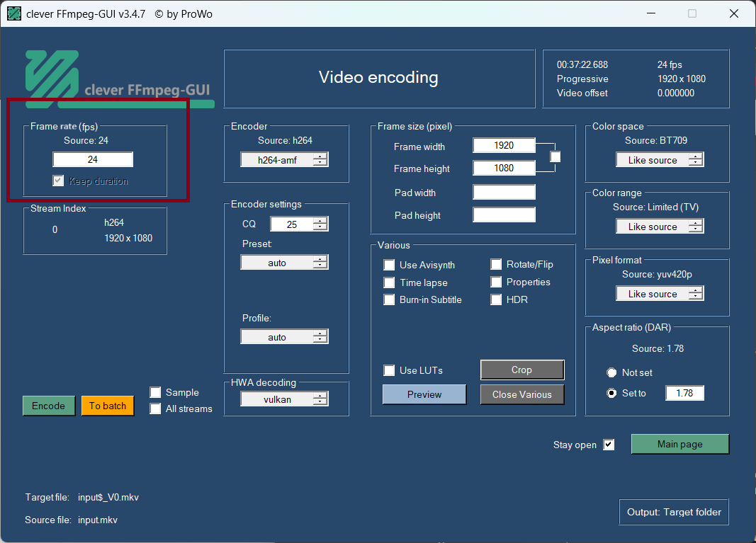

  17. You won't see the frame often, but when you do, it will be consistent.

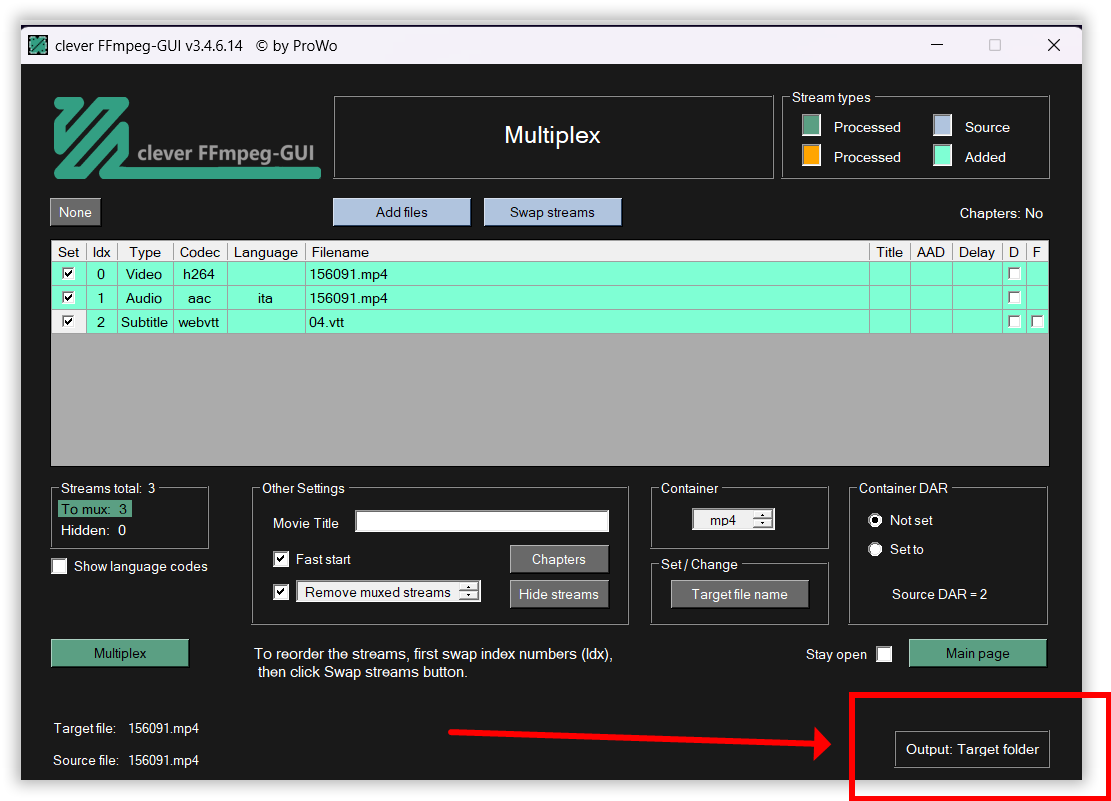

  18. sorry @ProWo if i ask such a stupid thing but i can't find a way in Multiplex to choose the output folder ...
    click on Output nothing to do. and the file is saved into clever folder. how change output folder ??
    [Attachment 89383 - Click to enlarge]
  19. @lomero
    On the Multiplex page, you can use the Target file name button to change the output folder and file name once. So this change does not apply to further multiplexing.
    You can switch between output to target and source folder using the Toggle destination button on the Main page. This setting will then apply permanently.
  20. @ Prowo

    How about changing the name "Target file name" button on the Multiplex page to "Target folder/file name"
  21. Originally Posted by Findu View Post
    @lomero
    ok, thanks

    The values and settings in Lossless Crop remain till restart of the app. Even a different source file will not reset them.
    When you open Crop, you see the button "Ok, done" (without a cropped frame). Normally, you hide it till a crop has been found.

    How about using "Frame rate (fps)" as the frame text?
    The tooltip could be "Target video frame rate in frames per second (fps)"
    [Attachment 89394 - Click to enlarge]

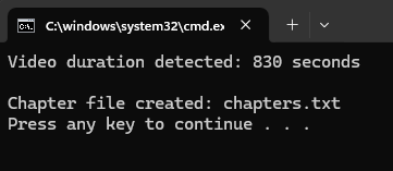

    Try this batch > TXT below

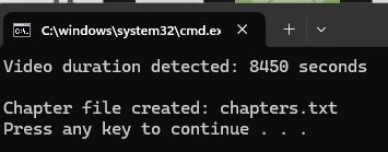

    You have done the above for the same "F1 Sample" again and again but it formed the chapters for each between 12:53 and 14.34 b'cause the chapters formation has been done on "Scene Detection" for the same video clip based on "PTS" or PTS_TIME".
    Try the new batch based on video duration. Last chapter in casting end will not be formed. (TXT of batch(.bat) attched below.....
    Just make the (.bat) file of the TXT Drag and Drop your video on that batch file. Chapters.txt will be formed. Finally you can mux it in multiplex by selecting "External File" under chapters section.
