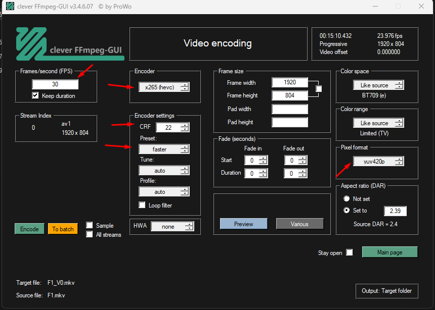

  3. OK go it but by giving the same parameters of ffmpeg - i command >>>
    ffmpeg -hide_banner -y -i "input.mkv" -filter:v "fps=30" -map 0:v -map 0:a:m:language:eng -c:v libx265 -preset faster -crf 22 -pix_fmt yuv420p -threads 0 -c:a copy -sn -movflags +faststart "D:\UTDL\FFmpeg Output\output.H265.mp4"
    in CFFmpeg GUI > Btopen.txt >>>
    Video ---> x265 (hevc) - Stream ID 0 from?C:\FFmpeg\bin\F1.mkv?910432?-hide_banner -loglevel error -stats -y -fflags +genpts -i "C:\FFmpeg\bin\F1.mkv" -vf fps=30000/1000,format=yuv420p -map 0:0 -c:v:0 libx265 -preset faster -crf 22 -aspect 2.39 -an -sn -dn -metadata:g encoding_tool="clever FFmpeg-GUI" ?D:\UTDL\FFmpeg Output\F1_V0.mkv?1?
    I get the ouput video with more brightness which unbalance the video but with ffmpeg -cli command it's perfect.
  4. Originally Posted by sam12345 View Post
    That doesn't make sense because the two command lines are identical except for the container.

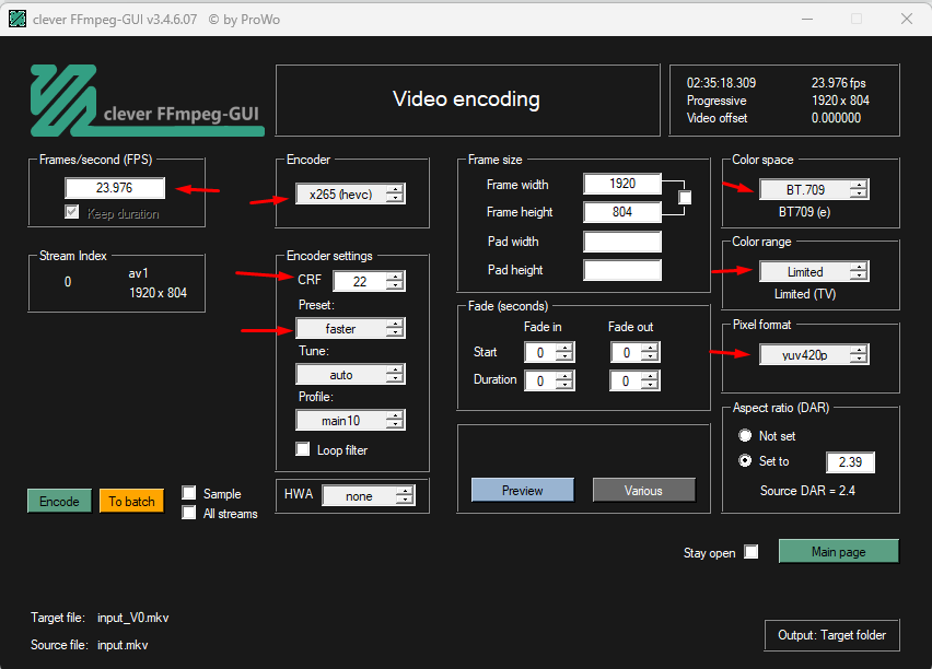

  5. I have found it. It's to keep the original frame rate as source video i.e. 23.976 and not to change to 30.
    Color space to BT.709 and color range to Limited and pixel format to yuv420p in the CFFmpeg Gui. Resulted video perfect.
    I have to remove the -filter:v "fps=30" from FFmpeg -CLI too.
    Kindly tell about the frame rate. My source video is 2.40.1 and the gui forces to 2.39 and does the gui uses all the threads for CPU encoding : -threads 0
    Lastly, Does the gui Multiplex do [-movflags +faststart] for .mp4
  6. Originally Posted by sam12345 View Post
    If your cli commandline is ok for you, so there is no need to change the color space, nor the color range (already limited) in the gui.
    You mean the aspect ratio, not the frame rate.
    There are no films with AR 2.40, but with 2, 2.35, and 2.39.
    Therefore, the correction is correct.
    Yes.
    Yes, you'll find this option in the multiplex window.

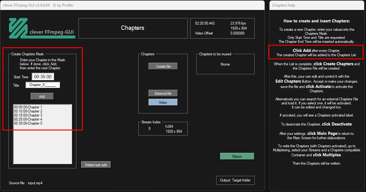

  10. Originally Posted by ProWo View Post
    can you embed this batch command for autogeneration of chapters in GIU.
    Automatically generated chapters at fixed intervals do not make sense.
    Chapters should be there to separate scene changes and similar.
    And these are different for every video.
    EDIT
    This batch Script works fully as per Scene Detection. Request you to embed the same in gui for automatic chapters generation.
    Attaching the TXT file of the batch (.bat)
    Test the video here
    PS: Download the video
  11. Originally Posted by sam12345 View Post
    This seems ok to me. Will implement it.

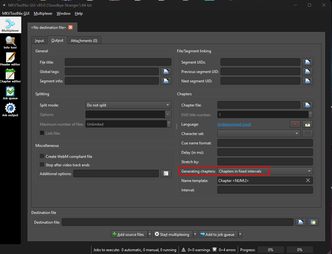

  12. MKV Toolnix has the option to Generate Chapters at regular intervals.
    [Attachment 89240 - Click to enlarge]
    Wondering if you can implement that to. It will be a great convenience for auto generation of chapters > even at regular intervals instead of adding them manually.
    Auto generation of chapters at 10 minutes regular interval TXT of the batch (.bat) enclosed herewith

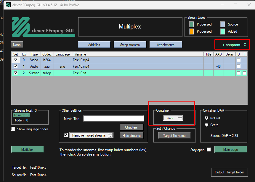

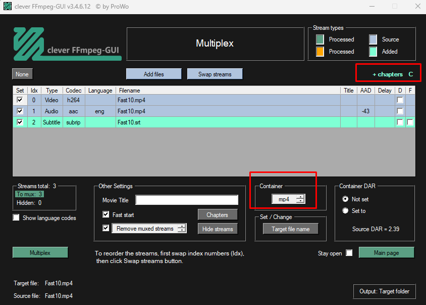

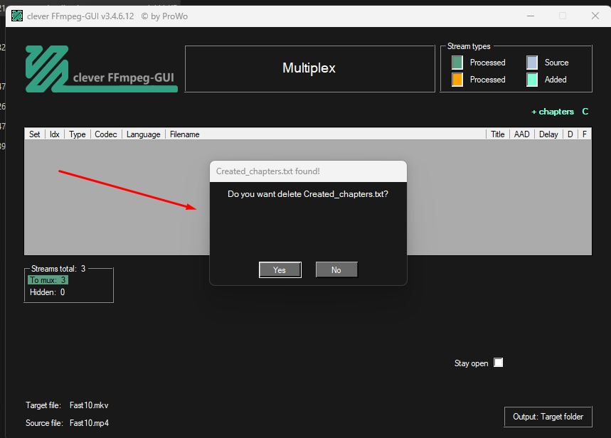

  18. @ProWo
    I know the procedure but multiplex is not doing short videos in mp4/mkv. Image
    [Attachment 89343 - Click to enlarge]
    [Attachment 89344 - Click to enlarge]
    [Attachment 89345 - Click to enlarge]
    Output reslut is null
  19. Originally Posted by sam12345 View Post
    It works as aspected here with me.
    Could you upload this video and post the link here?
    I have to test this with your video.
  20. @ProWo
    It's here Without chapters
  21. Originally Posted by sam12345 View Post
    Download the video
    Thx, tested with your video and found the bug.
    It was reading pts instead of pts_time.
    Fixed now, update.
  22. Tested, 3.4.6.13. OK; working.
    THX
