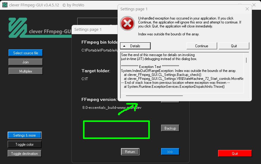

  2. @ProWo
    v3.4.5.11
    .11 feedback .. Still crashes ..
    @ProWo, please check index values before calling or using arrays.
    Originally Posted by videoAI View Post
    @ProWo
    v3.4.5.09
    Deleted my old backup file to make a new one.
    ************** Exception Text **************
    System.IndexOutOfRangeException: Index was outside the bounds of the array.
    at clever_FFmpeg_GUI.CL_Settings.Backup_check()
    at clever_FFmpeg_GUI.CL_Settings.VB$StateMachine_72_S tart_controls.MoveNext()
    --- End of stack trace from previous location where exception was thrown ---
    at System.Runtime.ExceptionServices.ExceptionDispatch Info.Throw()
    ************** Loaded Assemblies **************

  6. Originally Posted by videoAI View Post
    v3.4.5.11
    Not helpful.
    Please provide the exact steps that led to the crash.
  7. @ProWo
    v3.4.5.12
    Kindly click on my previous post .. it is all there ..
    396490#post2782491
    [Attachment 88658 - Click to enlarge]
    v3.4.5.11
    Not helpful.

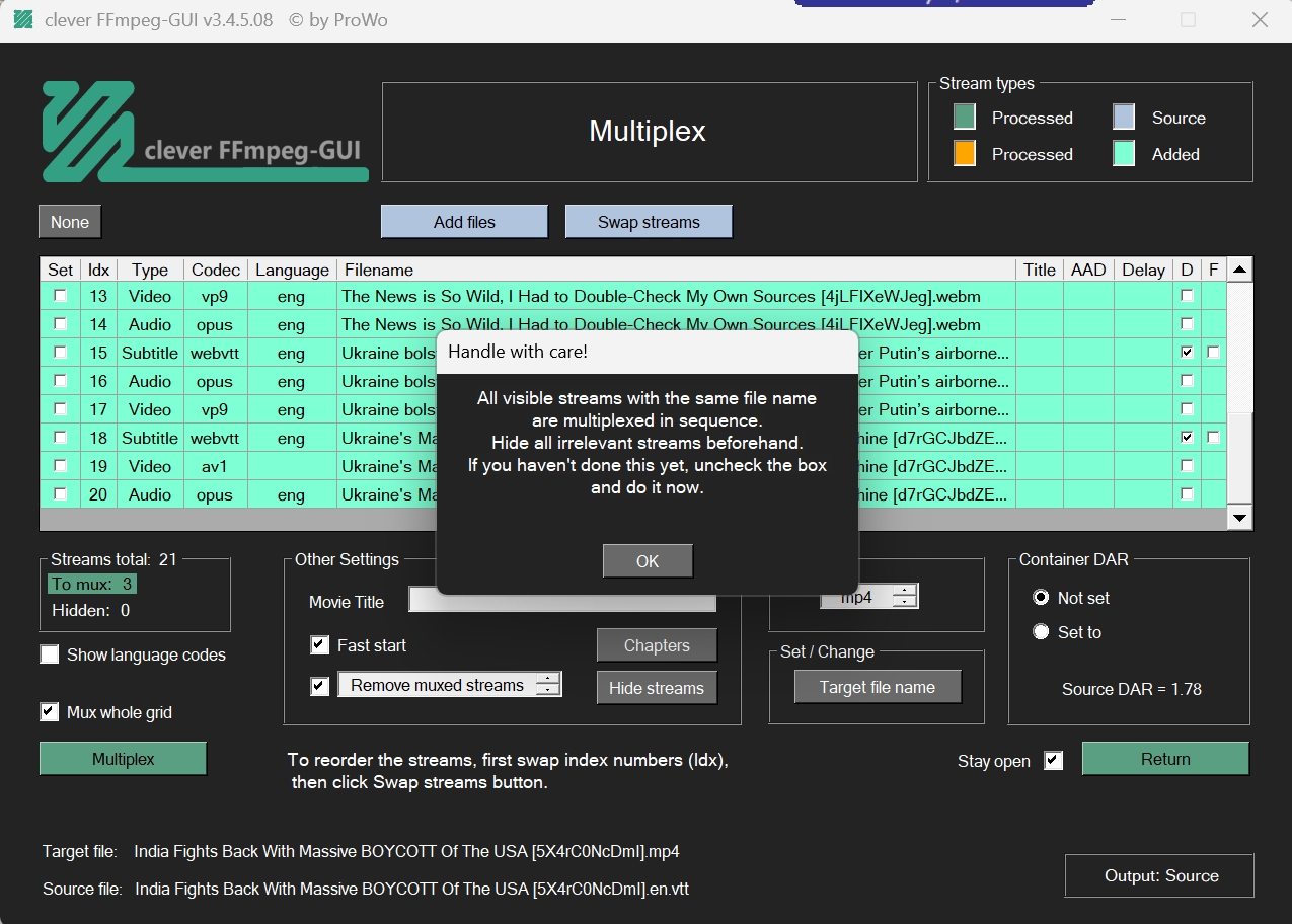

  8. Is this message necessary? I just want to get things done without having to click through pop-up messages.
    [Attachment 88659 - Click to enlarge]
  9. Originally Posted by davidt1 View Post
    Yes, this is necessary to avoid unwanted results.
  10. Originally Posted by videoAI View Post
    v3.4.5.12
    .. Still crashes ..
    The crash happens when you delete the backup?
    You seem to be the only one this happens to.
    All your crashes are strange.
    Check if you have a “clever FFmpeg gui” folder in
    C:\users\yourusername\appdata\local
    ; if so, delete it.
  11. Originally Posted by ProWo View Post
    Most software displays messages when you put the mouse over the button. It's more standard that way.
  12. @ProWo
    v3.4.5.13
    issue closed
    Edit#1 .13 does not crash if backup deleted at the disk level.
    !!! Thanks .. for .. fixing !!!
    It wasn't my environment after all ..
    As always .. there is nothing wrong with my environment
    To duplicate, exit clever, delete backup file, reopen clever, go to settings, ***CRASH***
    v3.4.5.12
    .. Still crashes ..
    The crash happens when you delete the backup? [y]
    You seem to be the only one this happens to. [don't think so, maybe I am the only one who deleted section #1 in settings]
    All your crashes are strange. [thanks !!]
    ; if so, delete it. [I didn't, maybe I am the only one who deleted section #1 in settings]

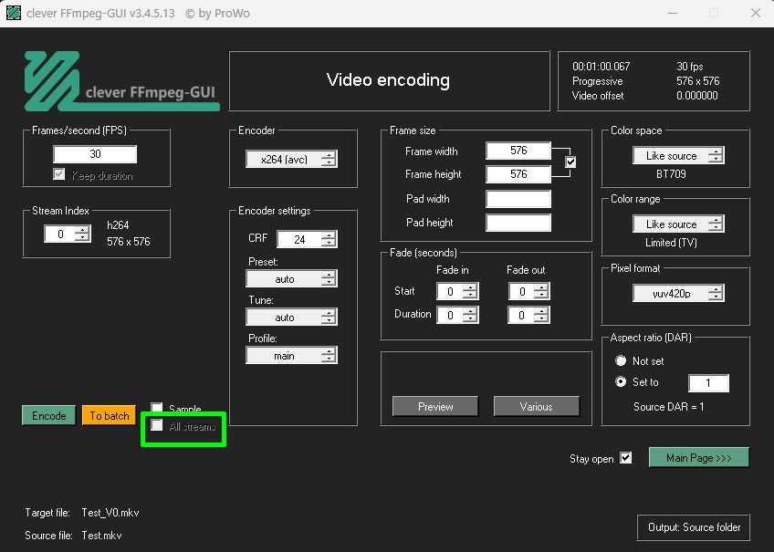

  13. @ProWo
    v3.4.5.13
    v3.4.5.13 Feedback ..
    New Issue: The video Encode Progress bar isn't working correctly [mp4],
    it goes to100% in 2 secs, then stays there for the encoding duration. [15 min]
    Q: under what scenario is the 'All Streams' checkbox grayed?
    Multi Video; Multi Audio streams?
    [Attachment 88661 - Click to enlarge]

  15. Originally Posted by videoAI View Post
    Are you playing with a multivideostream file again?
    This happens, because the correct duration can not be found.
    Multi videostreams.
    Background: Streamcopy can not work with filter_complex.

  17. My replies ..
    video Encode Progress bar isn't working correctly ...
    Are you playing with a multi video stream file again? [NOOOOOOOO]
    It is happening with some files .. and they are not multi-stream ..
    will test a bit more and revisit the issue ..
    Multi videostreams.
    Thx

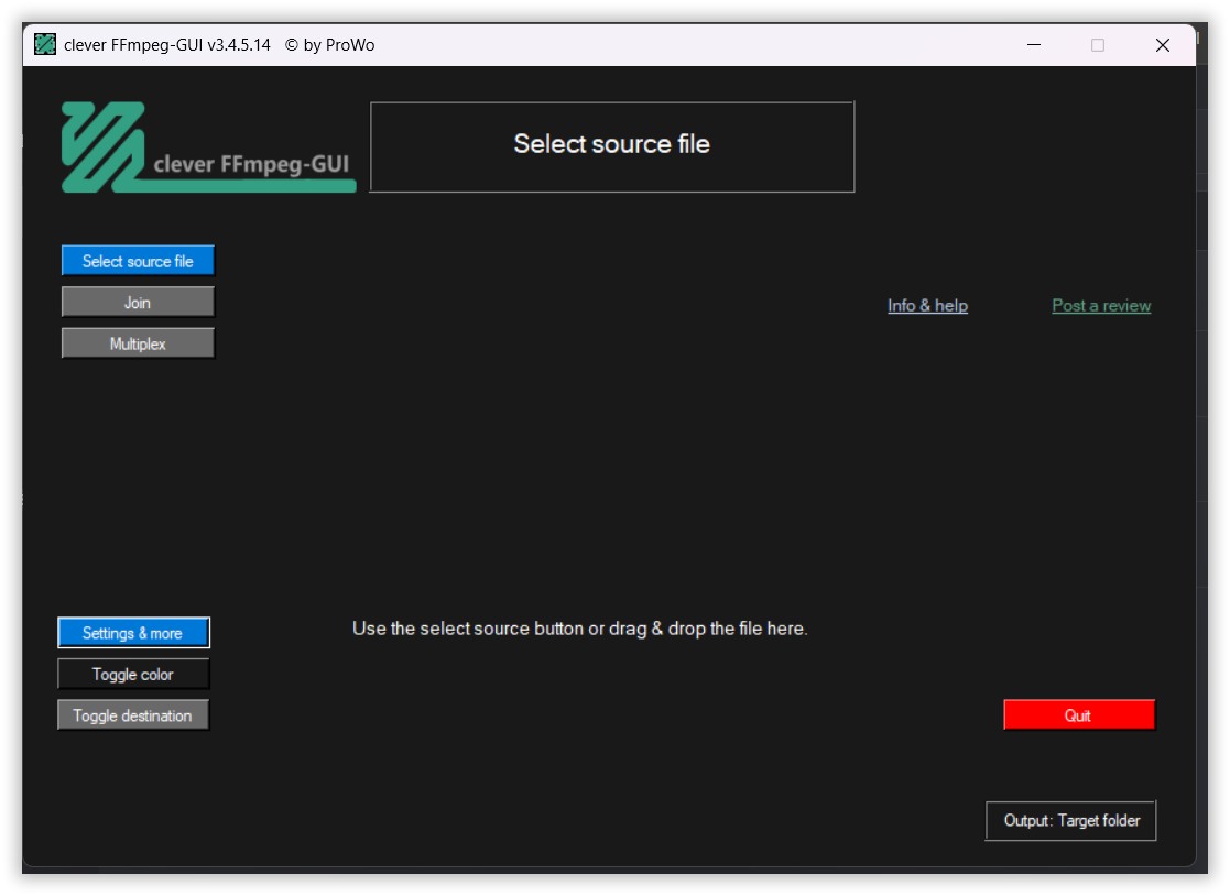

  22. from latest v3.4.5 nightly missing update feature ... why ?
  23. Originally Posted by lomero View Post
    You're on the last release (3.4.5) or on a nightly (3.4.5.x)?

    nightly 345.14
    before (344 version) from main page have update feature. now from setting&more (page 1 and 2) missing update feature ...
    also: with new portable.config blurry characters (i talk about win11, need override high DPI scaling from Tab properties)
    [Attachment 88691 - Click to enlarge]
  26. Originally Posted by lomero View Post
    nightly 345.14
    Settings & more is right, but you'll see the update button only, if an update is available.
    Do you have this file
    clever FFmpeg GUI.exe.config
    in your clever folder?
    If not, download the 3.4.5 release and extract it from the zip.

  30. Originally Posted by ProWo View Post
    ah ok. clear now. on prev version update was always present
    Do you have this file clever FFmpeg GUI.exe.config in your clever folder?
    oh yes, you're right. i'm new for 345 version (a lot of changes from prev 344). now all solved. thanks
