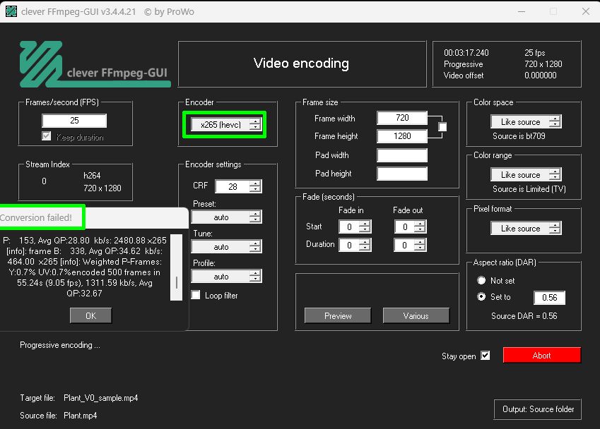

  4. @ProWo
    v3.4.4.21
    Tested yuv420p10le with different settings, all gave errors.
    Kindly remove it from the dropdown for both H.264 AMF & H.265 AMF.
    H.265 AMF:
    Video ---> hevc_amf - Stream ID 0 from?C:\T\Test\Test.mp4?10000?-hide_banner -loglevel error -stats -y -fflags +genpts -i "C:\T\Test\Test.mp4" -vf fps=30000/1000,colorspace=all=bt709:iall=bt709,format=yuv420p10le  -map 0:0 -c:v:0 hevc_amf  -rc 0 -qp_i 30 -qp_p 31 -aspect 1 -an -sn -dn -metadata:g encoding_tool="clever FFmpeg-GUI" ?C:\T\Test\Test_V0.mkv?
    Error log for H.265 AMF ..
    [hevc_amf @ 000001cc1133a680] 10-bit encoder is not supported by AMD GPU drivers versions lower than 23.30.[vost#0:0/hevc_amf @ 000001cc0f6f9340] Error while opening encoder - maybe incorrect parameters such as bit_rate, rate, width or height.[vf#0:0 @ 000001cc1133aac0] Error sending frames to consumers: Unknown error occurred[vf#0:0 @ 000001cc1133aac0] Task finished with error code: -1313558101 (Unknown error occurred)[vost#0:0/hevc_amf @ 000001cc0f6f9340] Could not open encoder before EOF[vost#0:0/hevc_amf @ 000001cc0f6f9340] Task finished with error code: -22 (Invalid argument)[vost#0:0/hevc_amf @ 000001cc0f6f9340] Terminating thread with return code -22 (Invalid argument)[vf#0:0 @ 000001cc1133aac0] Terminating thread with return code -1313558101 (Unknown error occurred)[out#0/matroska @ 000001cc0f6eee00] Nothing was written into output file, because at least one of its streams received no packets.frame= 0 fps=0.0 q=0.0 Lsize=0KiB time=N/A bitrate=N/A speed=N/A
    Originally Posted by videoAI View Post
    @ProWo
    - According to the research, there are compatibility challenges with H.264 AMF
    & H.265 AMF encoders using 10-bit pixel format yuv420p10le
    But I'll insert yuv420p10le (for 10 bit encoding) in the next nightly (for h264_amf and hevc_amf, to test).

  7. @ProWo
    v3.4.4.21
    I am getting a 'Conversion Error' when using the x265 HEVC encoder.
    The conversion status completes to 100%, but an FFmpeg / clever
    conversion failed error is generated as shown.
    all the settings are at auto, tried mp4/mkv containers, even different Pixel format settings.
    all produced the same conversion error.
    The error log does not show any errors !! Different AI services say there isn't any errors
    in the log. I see no errors. The resulting video file seems to be OK & playable, but Clever
    insists on deleting the file after the 'error'.
    Any idea what's going on. Log file attached.
    Clever Command:
    Video ---> x265 (hevc) - Stream ID 0 #FF# from?C:\T\Keep\Plant.mp4?20000?-hide_banner -loglevel error -stats -y -fflags +genpts -i "C:\T\Keep\Plant.mp4" -vf fps=25000/1000,colorspace=all=bt709:iall=bt709 -map 0 -c:a copy -c copy -c:v:0 libx265 -crf 28 -aspect 0.56 -dn -metadata:g encoding_tool="clever FFmpeg-GUI" ?C:\T\Keep\Plant_V0.mp4?
    [Attachment 88324 - Click to enlarge]

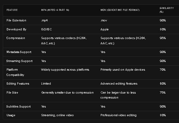

  8. Comparison between MP4 and MOV Formats
    File Extension and Compatibility
    MP4 files use the extension .mp4, while MOV files use .mov.
    Both formats are widely recognized, but MP4 is more universally
    compatible across various platforms and devices, making it the
    preferred choice for online streaming and playback. MOV, on the
    other hand, is primarily optimized for Apple's ecosystem, which
    can limit its compatibility with non-Apple devices.
    Development and Standards
    MP4 was developed by the ISO/IEC, while MOV was created by
    Apple. This difference in origin contributes to their varying levels
    of support across different operating systems and applications.
    MP4 is often favored for its broader acceptance in the industry.
    Compression and Quality
    Both formats support various codecs, including H.264 for video
    and AAC for audio. They can achieve similar video quality;
    however, MP4 files tend to be smaller due to more aggressive
    compression techniques. This makes MP4 more suitable for
    streaming and online use, where file size can be a critical factor.
    Editing Features
    MOV files are designed with advanced editing capabilities in mind,
    making them ideal for professional video editing environments.
    They offer features that facilitate high-quality editing processes.
    In contrast, MP4 files are more straightforward and may lack
    some of the advanced editing functionalities found in MOV.
    Metadata and Subtitles
    Both formats support metadata and subtitles, allowing for rich
    information to be embedded within the files. This feature is
    essential for both formats, especially in professional and
    streaming contexts, ensuring that users can access additional
    information and captions.
    Usage Context
    MP4 is commonly used for streaming and online video distribution
    due to its smaller file size and compatibility. MOV is often used in
    professional video editing and production settings, where
    high-quality video and advanced editing features are required.
    Overall Similarity
    The similarity between MP4 and MOV can be estimated at around
    80-90%. While they share many technical specifications and
    capabilities, their intended use cases, platform compatibility, and
    editing features create notable differences in their applications.
    [Attachment 88326 - Click to enlarge]
  9. Originally Posted by videoAI View Post
    I am getting a 'Conversion Error' when using thex265 HEVC encoder.
    Thx for the hint.
    This error is false, caused by a wrong keyword in the encoding error detection.
    Is fixed now.
  10. Seems OK now.
    Thanks for fixing.
    Keep up the good work ..
    x265 HEVC encoder conversion failed error
    Thx for the hint.
    Is fixed now.

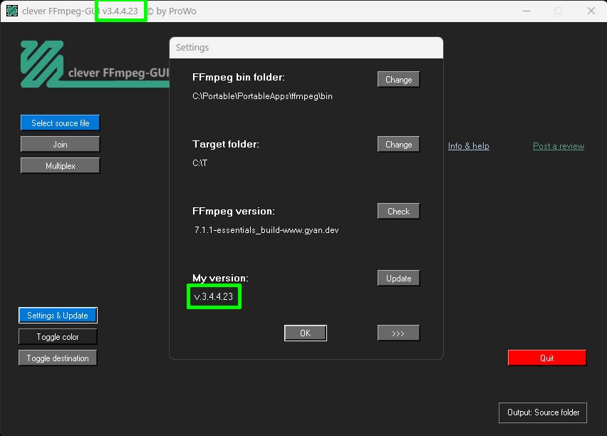

  11. @ProWo
    v3.4.4.24
    Edit #1
    I see a new backup button .. but don't see update button any longer.
    I hope this means Clever will auto update itself now ?
    For those of us involved in testing, and having to update clever few times a day.
    The Settings/update screen isn't a great help. it shows me my version of Clever,
    Which I already know [it's in my title bar] and it doesn't show me the two most
    important pieces of information :
    1. Is there a new update? and
    2. What new version number I would be updating to?
    Currently, We are clicking update blindly, without knowing if there is an update or
    what version we are updating to. I, for example, click on update every time I start
    Clever, just to make sure I am testing on the newest version of the App, which is
    a load on the server, and seeing 'server not available' messages is not uncommon.
    is it not possible to compare the user version and the server version and inform
    the user if there is a need to update, especially with the updates getting bigger
    with DLLs and all.
    BTW, a lot of programs do this, ex: Irfan view, Paint.net, Youtube-DL, etc ..

  13. Originally Posted by videoAI View Post
    v3.4.4.24
    Yes, I've implemented a simple app backup/restore.
    It handles one backup only atm.
    If you click the "Settings & more" button, in the backgroud is done an automatic update check.
    If there is a new nightly/release, an "Update available" label with the new version info will be shown, and the update button reappears.

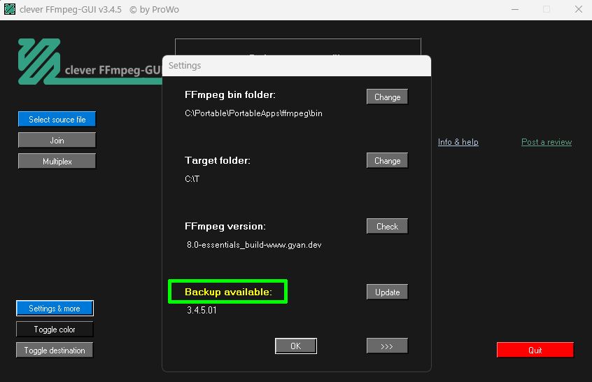

  15. @ProWo
    v3.4.4.25
    Edit #1
    Just tried the new update feature .. cool
    but, when the color turns yellow, and there is a new update, shouldn't the label say
    'Update Available' instead of 'Backup Available' ?
    v3.4.4.24

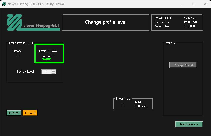

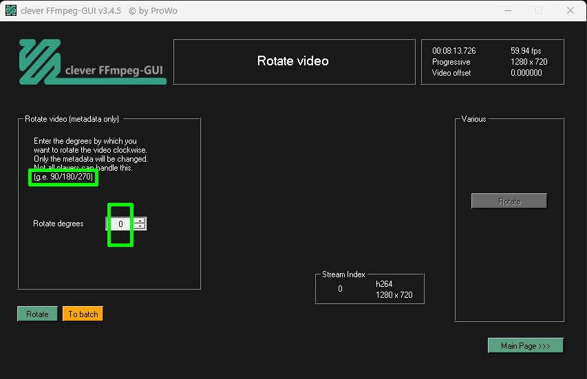

  19. @ProWo
    3.4.5
    A couple of minor changes when you have time:
    - Various, Profile : Constrained is truncated ..
    - Various, Rotate: I think g.e. is supposed to be e.g. [or Ex. for example]
    ........................... Also, is there really a need for 0 [no rotation]

  20. Originally Posted by videoAI View Post
    3.4.5
    Thx. Will be fixed.
    You are right, 0 isn't needed, will be removed.
  21. @ProWo
    3.4.5.01
    I have few issues with the new update/backup feature
    1. The Update & Backup should not share one button, because they are distinct processes.
    2. I was notified today that an update is available [yellow color]. I wanted to backup my stable
      version [3.4.5] before updating to [3.4.5.01] but I couldn't [no backup button; only upgrade].
      So I thought clever will back my older version automatically during the update, but that also didn't
      happen.
      I ended up with 3.4.5.01, but my backup is still the old [clever_3.4.4.24.bck] and not [3.4.5],
      and even now I can't do a manual backup of my new ver. [3.4.5.01].
      The workflow of both processes isn't good at all ..
    3. Also the message [Backup available is very confusing ; It should say 'update is available']
    [Attachment 88392 - Click to enlarge]
    Kindly revise or fix .. thank you and keep the new features coming ..
    @ProWo

    - Various, Profile : Constrained is truncated [fixed]
    - Various, Rotate: is there really a need for 0 [no rotation] [fixed]

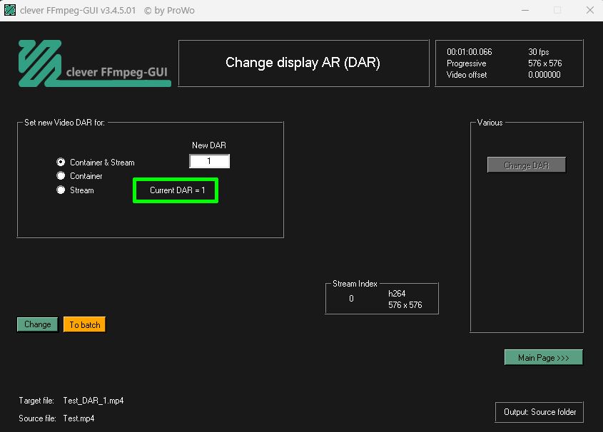

    Initial feedback,
    - Various, Change DAR, Minor Alignment .. 1st character is clipped in current position.
    [Attachment 88393 - Click to enlarge]

  23. Originally Posted by videoAI View Post
    @ProWo
    3.4.5.01
    Thx for the hint.
    I've changed it this way:
    The button sharing remains.
    If there is a new update, you'll see an yellow label with "Update available", the update version, an active update button.
    If you click this button, you have two choices: Update or not update.
    If you update, the app wil be updated to the newest version (nightly or release).
    If you don't update, you go back to the settings window.
    If there's a backup, you'll see the backup available info with the backup version and a restore button.
    If there's no backup, you'll see the backup button only.
    If you want make a new backup, you must delete the old first.
    As i said, the backup is a simple solution and will remain this way, because it's not really necessary.

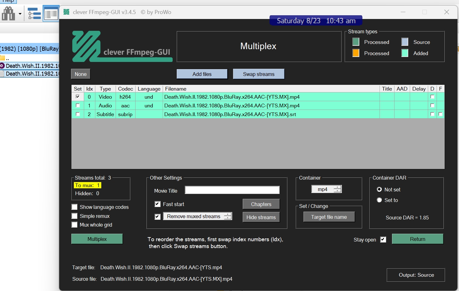

  25. On the multiplex page, only the top stream is selected after drag and drop.
    [Attachment 88397 - Click to enlarge]
  26. Originally Posted by hakupla View Post

  27. Originally Posted by davidt1 View Post
    Works here as aspected.
    Please describe all steps to your result.
