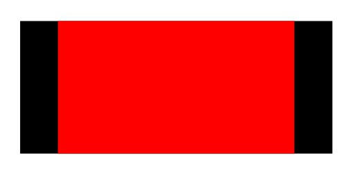

    16 x 9 = 144
    21.15 x 9 = 190
    Difference between 16:9 and 2.35:1 is 46.
    46 from 190 is not "almost 50%."
    By my calculations, only the black bits are lost if you zoom in on your 16:9 TV to fill the top and bottom (or crop to 16:9).
    [Attachment 61073 - Click to enlarge]

    @Alwyn.
    1. Dellsam34 was not discussing 2.35:1 and 16:9. He was refereeing to widescreen on 4:3. *
    2. But I took a closer look at yours since you have formulae and, unfortunately, your logic is flawed. You simply can not compare a 16:9 image with, effectively 90% (2.35 * 90% = 2.115) of 2.35:1
    You need to start with an actual image and not a multiplication of an aspect ratio. So the simple thing is to express 2.35:1 as 235 * 100. Now to fit that image in a 16:9 window you are adding the letter-boxing = 235/16*9 = 132. The effect of the crop returns the height to 100. So 235/132*100 = 178. And as we all know 1.78:1 is another way of expressing 16:9. So the difference in width = 235-178 = 57
    And, before you all tell me, you do not need to go through this convoluted process. It's a simple matter of 235 - 57 = 178
    *Using the above the compare for 4:3 can be expressed as 235 - 133 = 102. Or 43% of the original.
