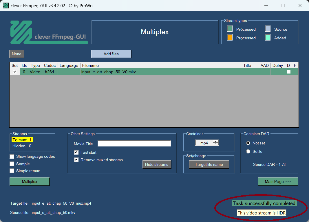

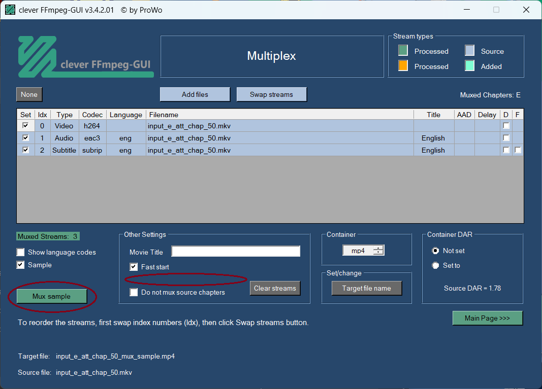

    How about making some cosmetic changes in Multiplex "Other Settings" when using Sample?
    - I am not sure if you can activat/deactivate "Fast start" for Samples.
    - Muxed streams always remain in the grid using Samples, so the feature may be grayed out or disappear.
    - The chapters are set correctly using Samples so that feature stay.
    [Attachment 87364 - Click to enlarge]
    Wouldn't it now make sense to leave the Multiplex page open after "Simple Remux" as long as streams remain in the grid like with normal Multiplex?
  2. Originally Posted by Findu View Post
    Fast start works with samples too.
    If you mux a sample, it makes no sense to remove the streams. A sample can be repeated as often as you like.
    Afterwards, everything remains open and ready for the final muxing.
    Yes, of course, will change this.
  3. >> Muxed streams always remain in the grid using Samples, so the feature may be grayed out or disappear.
    Of course. I mean, everything works as it should.
    However, the "Remove multiplexed streams" feature is still visible and enabled when Sample is enabled, so it's normal to assume this removal will happens even if it doesn't make sense.
    For this reason, it may be better to disable this feature or make it disappear while Sample is enabled.

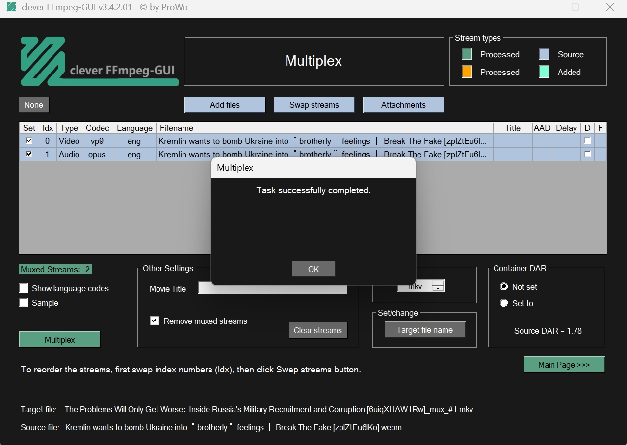

  4. Originally Posted by ProWo View Post
    Originally Posted by davidt1 View Post
    The newest version does not automatically remove muxed streams like the version you sent me.
    With remove muxed streams checked (default) the muxed streams are removed from the grid.
    There is now a pop-up message that says something like the file is successfully muxed that forces me to close it before I can mux the next file. The version you sent me automatically remove the muxed streams and does not waste my time with the pop up message.
    This message is intended and is shown only, if there are residual streams after muxing.
    Can you please send me that one again?
    No, this file was a temporary file, no longer available.
    The newest version works the way it has always worked.

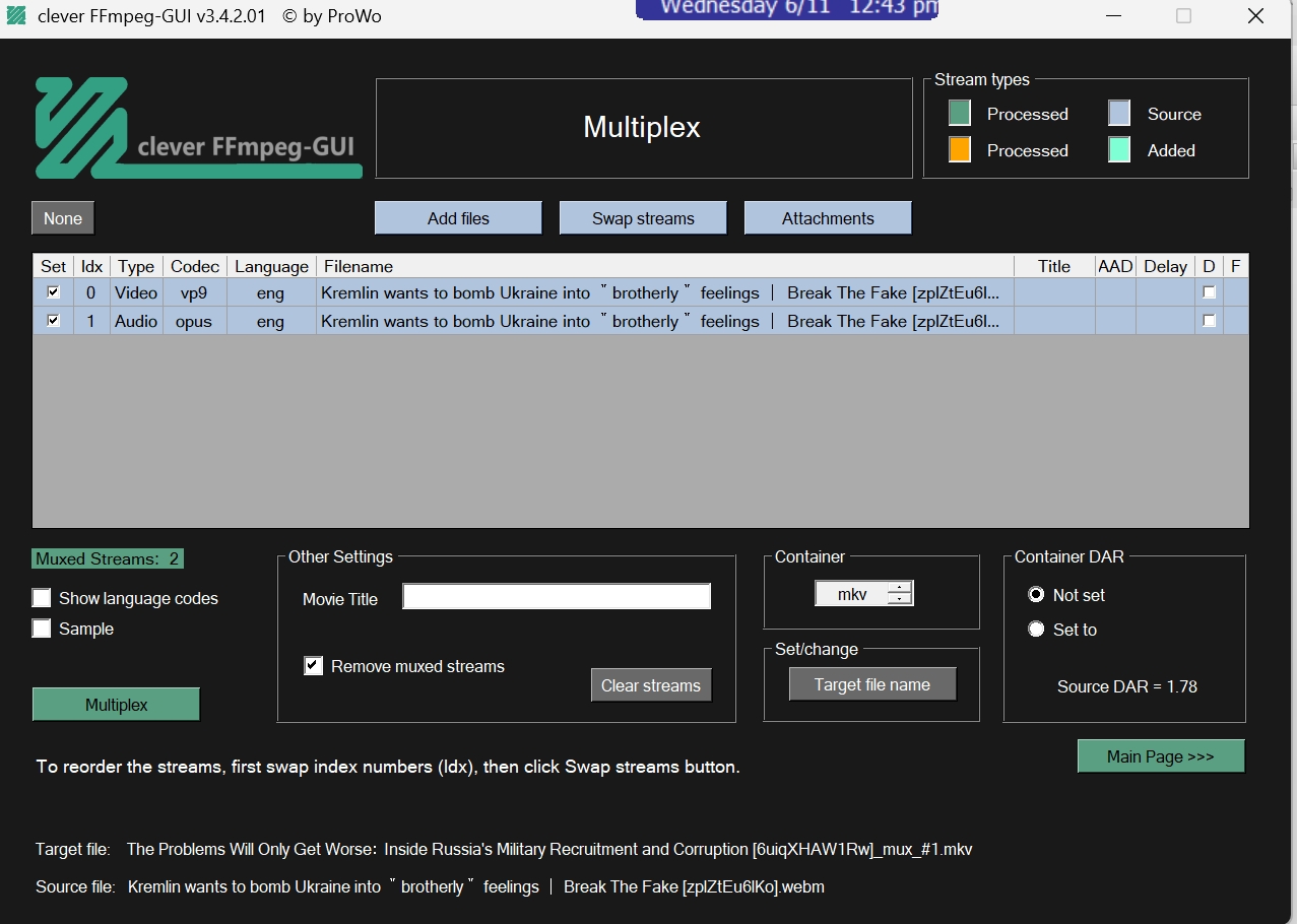

    1 Pop-up message comes up every time forcing me to close it.
    [Attachment 87365 - Click to enlarge]
    2. After pop-message is cleared, no longer needed streams are still there and require a manual clearing for them to disappear.
    [Attachment 87366 - Click to enlarge]
    I guess I was lucky for a few days when you gave me the version that automatically clear the muxed file with no annoying pop-up message that force me to close it.
    Edit: after looking through my computer, I saw a copy of a previous version without the language codes but works the way I like. I will use this version instead. I have to type in the language codes, but won't have to constantly click to close the pop-up message and to remove the muxed file.
    The lesson for me is: make a copy of the version that you like before updating. Thanks.

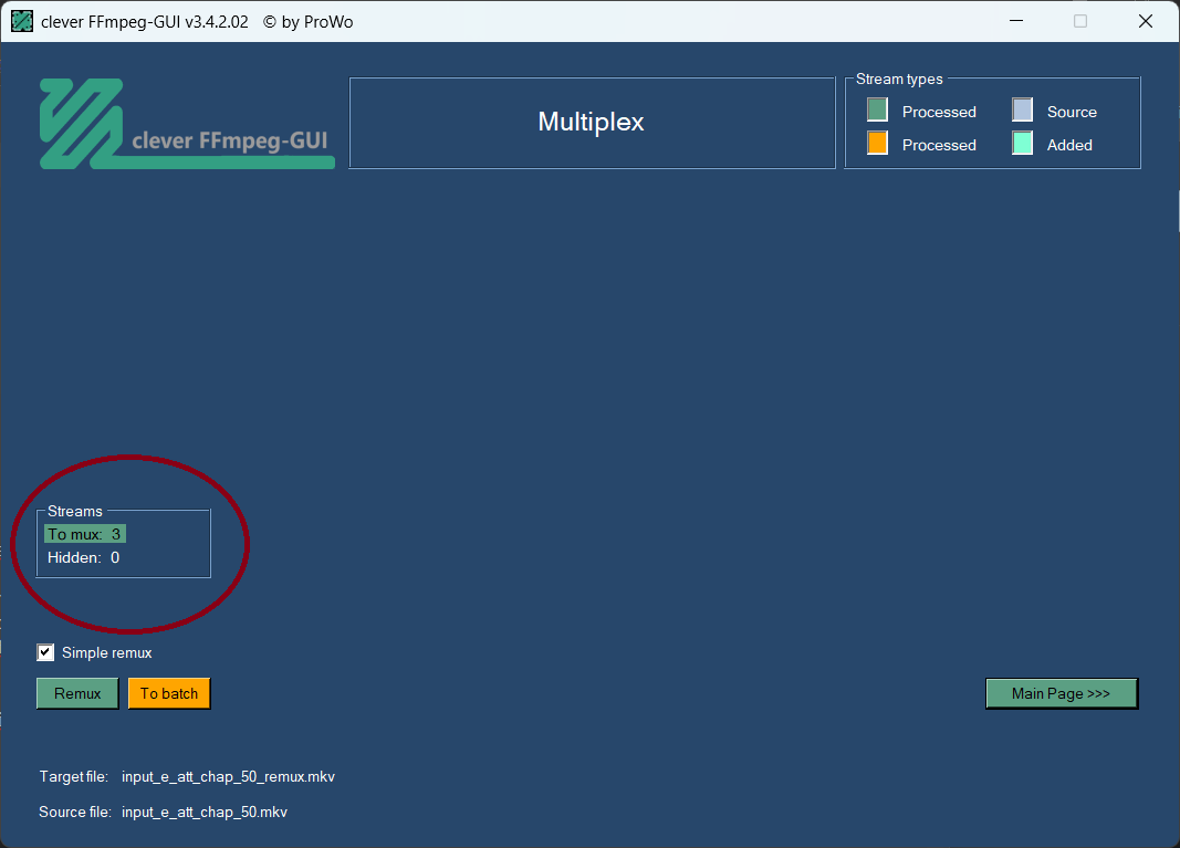

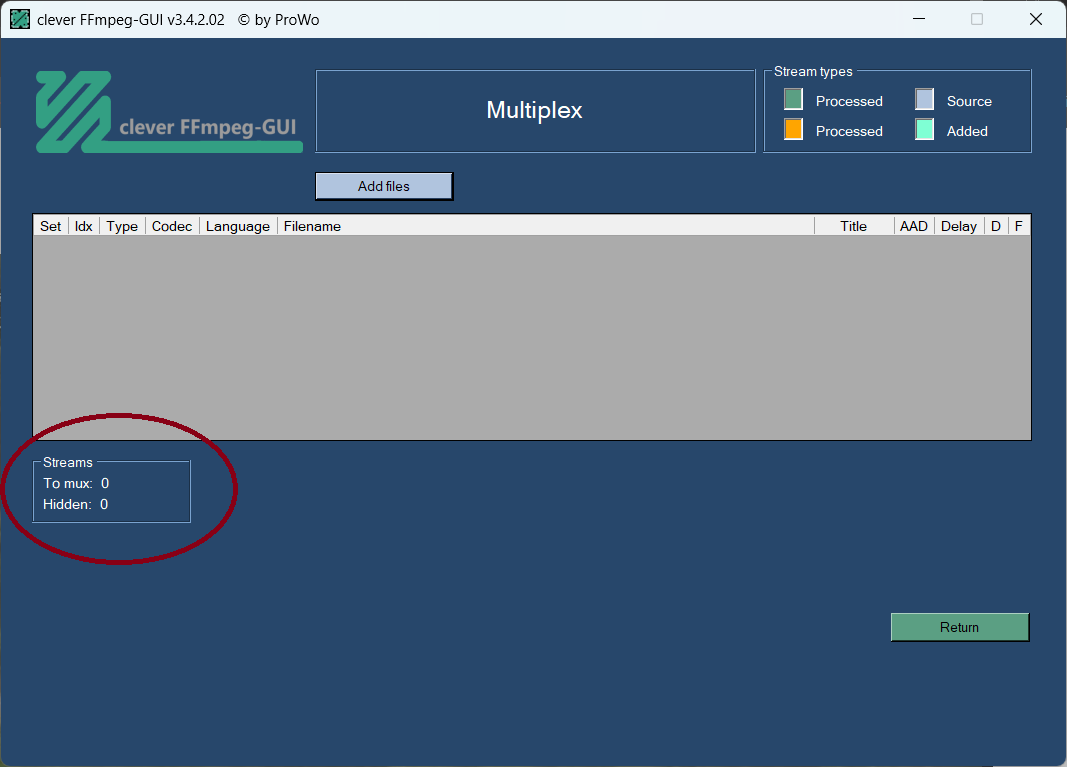

    Should this be visible with Simple remux?
    I guess hidden streams only appear for added files and get automatically removed for source files?
    [Attachment 87370 - Click to enlarge]
    Good to know: Selecting a single stream is enough to Simple remux the entire file!

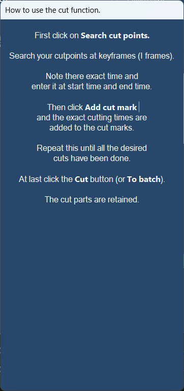

    Hovering over the text always show this information:
    [Attachment 87369 - Click to enlarge]

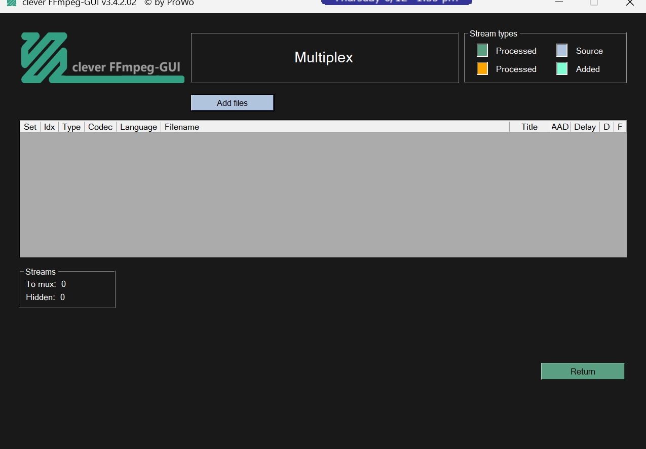

    Info:
    If you edit the Idx grid field and it stay empty, or it is not a number or a long number like 77777777777, you get a DataGridView error message.
    You also can enter letters and special characters into the Delay field, but that gets ignored while multiplexing.
    But why should someone do that!?
    Should this be visible?

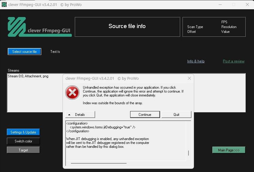

    I have a ts file that doesn't load properly in 'clever', but plays OK in MPC.
    if I try loading it in Multiplex, nothing is loaded, and nothing happens.
    if I try loading it in open source file, I get no streams, but a single png attachment !!!
    [Attachment 87379 - Click to enlarge]
    and I get an error right away as shown ...
    See the end of this message for details on invoking
    just-in-time (JIT) debugging instead of this dialog box.
    ************** Exception Text **************
    System.IndexOutOfRangeException: Index was outside the bounds of the array.
    at clever_FFmpeg_GUI.Form2.Read_Top_RL(String& aa0)
    at clever_FFmpeg_GUI.Form2.Show_Tracks()
    at clever_FFmpeg_GUI.Form2.New_inputfile()
    at System.Windows.Forms.Control.OnClick(EventArgs e)
    at System.Windows.Forms.Button.OnMouseUp(MouseEventAr gs mevent)
    at System.Windows.Forms.Control.WmMouseUp(Message& m, MouseButtons button, Int32 clicks)
    at System.Windows.Forms.Control.WndProc(Message& m)
    at System.Windows.Forms.ButtonBase.WndProc(Message& m)
    at System.Windows.Forms.Button.WndProc(Message& m)
    at System.Windows.Forms.NativeWindow.Callback(IntPtr hWnd, Int32 msg, IntPtr wparam, IntPtr lparam)
    ************** Loaded Assemblies **************
    mscorlib
    Assembly Version: 4.0.0.0
    Win32 Version: 4.8.9300.0 built by: NET481REL1LAST_C
    CodeBase: file:///C:/Windows/Microsoft.NET/Framework64/v4.0.30319/mscorlib.dll
    clever FFmpeg GUI
    Assembly Version: 1.0.0.0
    Win32 Version: 3.4.2.01
    CodeBase: file:///C:/Portable/PortableApps/CleverFFmpegGUI/clever%20FFmpeg%20GUI.exe
    Microsoft.VisualBasic
    Assembly Version: 10.0.0.0
    Win32 Version: 14.8.9032.0 built by: NET481REL1
    CodeBase: file:///C:/WINDOWS/Microsoft.Net/assembly/GAC_MSIL/Microsoft.VisualBasic/v4.0_10.0.0.0__b03f5f7f11d50a3a/Microsoft.VisualBasic.dll
    System
    Win32 Version: 4.8.9282.0 built by: NET481REL1LAST_C
    CodeBase: file:///C:/WINDOWS/Microsoft.Net/assembly/GAC_MSIL/System/v4.0_4.0.0.0__b77a5c561934e089/System.dll
    System.Core
    Win32 Version: 4.8.9297.0 built by: NET481REL1LAST_C
    CodeBase: file:///C:/WINDOWS/Microsoft.Net/assembly/GAC_MSIL/System.Core/v4.0_4.0.0.0__b77a5c561934e089/System.Core.dll
    Win32 Version: 4.8.9256.0 built by: NET481REL1LAST_B
    CodeBase: file:///C:/WINDOWS/Microsoft.Net/assembly/GAC_MSIL/System.Windows.Forms/v4.0_4.0.0.0__b77a5c561934e089/System.Windows.Forms.dll
    System.Drawing
    Win32 Version: 4.8.9032.0 built by: NET481REL1
    CodeBase: file:///C:/WINDOWS/Microsoft.Net/assembly/GAC_MSIL/System.Drawing/v4.0_4.0.0.0__b03f5f7f11d50a3a/System.Drawing.dll
    System.Configuration
    CodeBase: file:///C:/WINDOWS/Microsoft.Net/assembly/GAC_MSIL/System.Configuration/v4.0_4.0.0.0__b03f5f7f11d50a3a/System.Configuration.dll
    System.Xml
    CodeBase: file:///C:/WINDOWS/Microsoft.Net/assembly/GAC_MSIL/System.Xml/v4.0_4.0.0.0__b77a5c561934e089/System.Xml.dll
    System.Runtime.Remoting
    Win32 Version: 4.8.9214.0 built by: NET481REL1LAST_B
    CodeBase: file:///C:/WINDOWS/Microsoft.Net/assembly/GAC_MSIL/System.Runtime.Remoting/v4.0_4.0.0.0__b77a5c561934e089/System.Runtime.Remoting.dll
    PortableSettingsProvider
    Assembly Version: 0.2.5.0
    Win32 Version: 0.2.5.0
    CodeBase: file:///C:/Portable/PortableApps/CleverFFmpegGUI/PortableSettingsProvider.DLL
    System.Xml.Linq
    CodeBase: file:///C:/WINDOWS/Microsoft.Net/assembly/GAC_MSIL/System.Xml.Linq/v4.0_4.0.0.0__b77a5c561934e089/System.Xml.Linq.dll
    Accessibility
    CodeBase: file:///C:/WINDOWS/Microsoft.Net/assembly/GAC_MSIL/Accessibility/v4.0_4.0.0.0__b03f5f7f11d50a3a/Accessibility.dll
    System.Web.Extensions
    CodeBase: file:///C:/WINDOWS/Microsoft.Net/assembly/GAC_MSIL/System.Web.Extensions/v4.0_4.0.0.0__31bf3856ad364e35/System.Web.Extensions.dll
    System.Web
    CodeBase: file:///C:/WINDOWS/Microsoft.Net/assembly/GAC_64/System.Web/v4.0_4.0.0.0__b03f5f7f11d50a3a/System.Web.dll

    Any thoughts?
    Many thanks for your help ..
    Bug #6 (out of ??)
    As always .. there is nothing wrong with my environment
    Yes, as you have already noticed, it is sufficient to select a stream for simple remux and the entire file with all streams will be remuxed. The display shows you how many streams are being remuxed.
    This is an old tooltip that I have forgotten.
    Will be fixed.
    Yes, as additional information that the Mux Grid is empty.

  12. Originally Posted by ProWo View Post
    I really appreciate your quick response. This beta is very close to the one you gave me.
    1. No more pop-up message.
    2. 2 character language code is shown automatically.
    3. after muxing, the files are cleared automatically, as they should be.
    4. However, after muxing, the muxing page disappear. I have to click on the "Muxing" button each time to do a new file. Please make the muxing page stay.
    Thank you.
  13. Originally Posted by videoAI View Post
    @ProWo
    Could you try to open it in Avdemux, cut a 30 seconds piece and post it here?
    So i can have a look.
  14. Originally Posted by davidt1 View Post

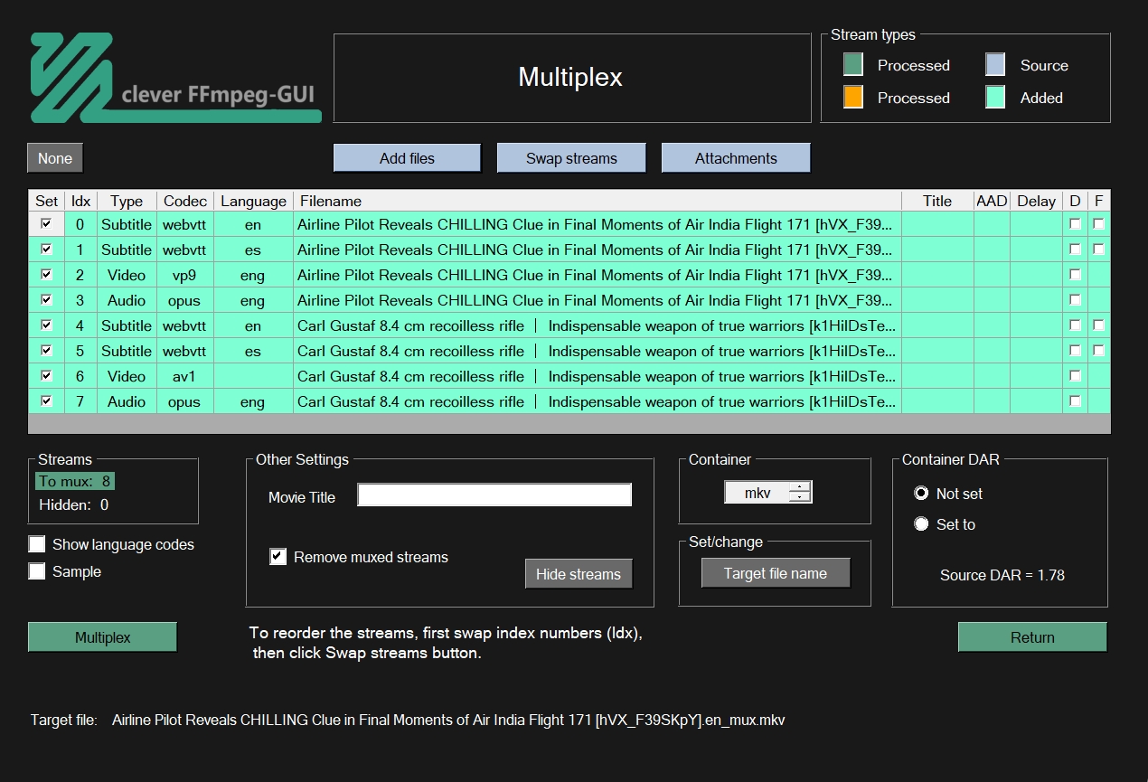

    The muxing page only disappears when there are no more streams in the mux grid.
    Simply move several videos into it for muxing, then you can work through them one by one.
  15. Originally Posted by ProWo View Post
    Drag and drop is how I use this app. Maybe using the "Add file" button will make it behave differently? Anyway:
    1. I drag and drop 2 files and 4 subs to be muxed. Only the top file is muxed.
    [Attachment 87381 - Click to enlarge]
    2. After muxing, the muxing page disappears.
    [Attachment 87382 - Click to enlarge]
    3. Clicking on the "Mutiplex" button brings back an empty page. This page should stay on after the streams are cleared.
    [Attachment 87383 - Click to enlarge]
    Is there a way for me to send you the file I like using? I tried to upload it here, but the website says it is an invalid file. Thanks.
  16. Originally Posted by davidt1 View Post
    No, all is muxed this way, both videos and all 4 subs, because you have selected all streams on the left.
    You only see 1 video as output, because the file name of the first selected stream is used and all streams are muxed into this file.
    If you open this output file in clever FFmpeg GUI, you will find 8 streams in it, 2 video, 2 audio and 4 subtitle streams.
    The correct way (for your example) would be to select only the first 4 streams on the left (the ones with the same name), then click on Multiplex.
    After muxing, the window would then remain open with the remaining 4 streams for muxing.
    If you have also muxed these, you will find 2 videos in the destination folder, as expected.
    Of course, there are no more streams to mux.
    For what?
    This is not necessary.

  18. Originally Posted by ProWo View Post
    For what?
    I vaguely remember you saying that multiple files and added before muxing. I used 2 files and 4 subs as an example. Normally, I drag one file and 2 subs. Mux them and add another file and 2 subs. This is why I need the mux page to remain open. Otherwise I have click on the "Multiplex" button for each file. Often time I do up to 10 files. That's a lot clicking. I am not asking for anything different. You already gave me a version that works exactly the way I like. It's my fault I lost it.
    The version I using now keeps the mux page open but without the language codes. I am happy enough. Though I would even happier if it display the language codes. Thanks.

  20. @ ProWo
    > No, I have changed that. Now you can select and hide any stream.
    Oh right! You replaced "Remove streams" with "Hide streams".
    So you can't accidentally delete streams. Good idea!
    And of course, it has the advantage of being able to display streams again, by click at "Show hidden" or automatic after muxing, but that should not happen after you mux a sample.
    The hidden streams remain highlighted when unhiding, but when you click "None" to deactivate all streams, this also apply to hidden streams. Could the hidden streams be excluded from this when you click "None"? This makes it easier to hide them again or add new ones.
    "Stay open" on the multiplex page is working as intended. Thank you very much!
    I personally don't need it - so far
  21. Originally Posted by Findu View Post
    I will change this so that All/None only affects the visible streams.
  22. @ ProWo
    I tried opening the video file in many video editing tools. Ended up with errors or refusal to open the file.
    Seems odd since the file has conformant video/audio streams.
  23. @VideoAI
    You could try to remux the file with ffmpeg.
    ffmpeg -analyzeduration 100M -probesize 50M - i "input.ts" -map 0 -c copy output.mkv
  24. Tried your command and was getting errors reading the input .. then I tried this command w/audio:
    ffmpeg -hide_banner -analyzeduration 100M -probesize 50M -i "test.ts" -map 0 -c copy -bsf:a aac_adtstoasc -y output.mkv
    the conversion lasted ~ 10 sec, created output.mkv, and I got this log:
    Input #0, png_pipe, from 'test.ts':
    Duration: N/A, bitrate: N/A
    Stream #0:0: Video: png, rgba(pc, gbr/bt709/iec61966-2-1), 1x1 [SAR 4724:4724 DAR 1:1], 25 fps, 25 tbr, 25 tbn
    Stream mapping:
    Stream #0:0 -> #0:0 (copy)
    Output #0, matroska, to 'output.mkv':
    Metadata:
    encoder : Lavf61.7.100
    Stream #0:0: Video: png (MPNG / 0x474E504D), rgba(pc, gbr/bt709/iec61966-2-1), 1x1 [SAR 4724:4724 DAR 1:1], q=2-31, 25 fps, 25 tbr, 1k tbn
    Press [q] to stop, [?] for help
    [out#0/matroska @ 000002998bfba200] video:745788KiB audio:0KiB subtitle:0KiB other streams:0KiB global headers:0KiB muxing overhead: 0.004440%
    frame= 743 fps=224 q=-1.0 Lsize= 745821KiB time=00:00:29.72 bitrate=205577.5kbits/s speed=8.96x
    test.ts {the input}, size= 745,788 kb --- plays fine in mpc ---
    output.mkv {created}, size= 745,821 kb --- unplayable in mpc ---
    @VideoAI
  25. @ ProWo
    Can you please be so kind and add an own "Frame accurate cut" help page.
    For example, to explain that you set the CRF level for all cuts right at the beginning. Or that editing requires three steps.
  26. @VideoAI
    Could you post the full messages from this command?
    ffmpeg - i test.ts
  27. Originally Posted by Findu View Post
    @ ProWo
    The 3 steps are mentioned, hoovering over Frame accurate cut.
    Will add a tooltip to the CRF setting.

    output log:
    ffmpeg version 7.1.1-full_build-www.gyan.dev Copyright (c) 2000-2025 the FFmpeg developers
    built with gcc 14.2.0 (Rev1, Built by MSYS2 project)
    configuration: --enable-gpl --enable-version3 --enable-static --disable-w32threads --disable-autodetect --enable-fontconfig --enable-iconv --enable-gnutls --enable-lcms2 --enable-libxml2 --enable-gmp --enable-bzlib --enable-lzma --enable-libsnappy --enable-zlib --enable-librist --enable-libsrt --enable-libssh --enable-libzmq --enable-avisynth --enable-libbluray --enable-libcaca --enable-libdvdnav --enable-libdvdread --enable-sdl2 --enable-libaribb24 --enable-libaribcaption --enable-libdav1d --enable-libdavs2 --enable-libopenjpeg --enable-libquirc --enable-libuavs3d --enable-libxevd --enable-libzvbi --enable-libqrencode --enable-librav1e --enable-libsvtav1 --enable-libvvenc --enable-libwebp --enable-libx264 --enable-libx265 --enable-libxavs2 --enable-libxeve --enable-libxvid --enable-libaom --enable-libjxl --enable-libvpx --enable-mediafoundation --enable-libass --enable-frei0r --enable-libfreetype --enable-libfribidi --enable-libharfbuzz --enable-liblensfun --enable-libvidstab --enable-libvmaf --enable-libzimg --enable-amf --enable-cuda-llvm --enable-cuvid --enable-dxva2 --enable-d3d11va --enable-d3d12va --enable-ffnvcodec --enable-libvpl --enable-nvdec --enable-nvenc --enable-vaapi --enable-libshaderc --enable-vulkan --enable-libplacebo --enable-opencl --enable-libcdio --enable-libgme --enable-libmodplug --enable-libopenmpt --enable-libopencore-amrwb --enable-libmp3lame --enable-libshine --enable-libtheora --enable-libtwolame --enable-libvo-amrwbenc --enable-libcodec2 --enable-libilbc --enable-libgsm --enable-liblc3 --enable-libopencore-amrnb --enable-libopus --enable-libspeex --enable-libvorbis --enable-ladspa --enable-libbs2b --enable-libflite --enable-libmysofa --enable-librubberband --enable-libsoxr --enable-chromaprint
    libavutil 59. 39.100 / 59. 39.100
    libavcodec 61. 19.101 / 61. 19.101
    libavformat 61. 7.100 / 61. 7.100
    libavdevice 61. 3.100 / 61. 3.100
    libavfilter 10. 4.100 / 10. 4.100
    libswscale 8. 3.100 / 8. 3.100
    libswresample 5. 3.100 / 5. 3.100
    libpostproc 58. 3.100 / 58. 3.100
    At least one output file must be specified
    Press any key to continue . . .
    Created no output file
    @VideoAI
    ffmpeg - i test.ts
