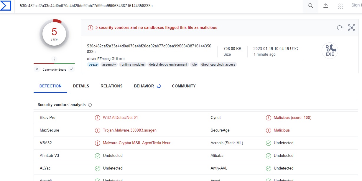

  1. I won't use this GUI anymore, because the developer does not release clean files:
    [Attachment 68741 - Click to enlarge]
    It's best to use ffmpeg with command-lines. It will be %100 safe and much more operational.
    May 2005
    Australia-PAL Land
    Ridibunda, rubbish. There's nothing wrong with Clever.
    It's probably my fault, actually, because I asked the developer to make it easier to install by putting the package in a ZIP, not a RAR as he had previously. Sorry, ProWo!
    As for command-line FFMPEG being "much" more operational, that is your opinion only. It's certainly not how I see it.
  3. @ridibunda
    This are false positives.
    Check the MD5 hash of the exe file.
    If it's ok, then I confirm you that clever is virus/troian/malware free.

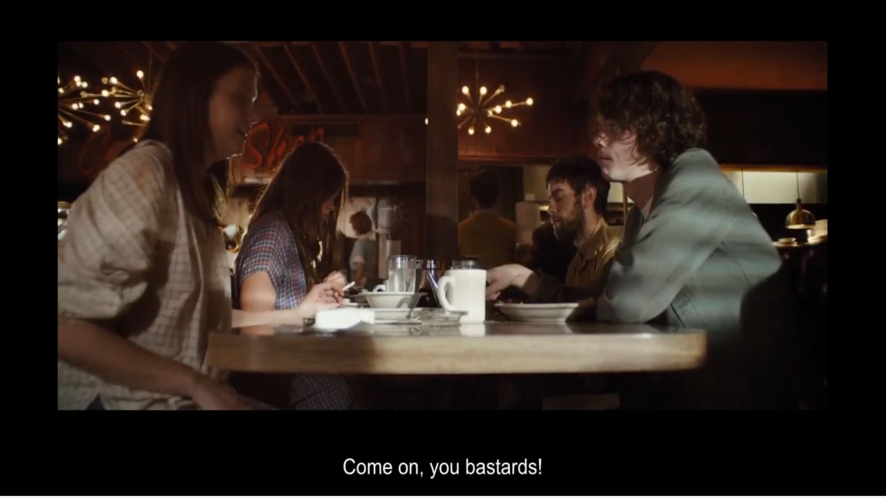

  16. Newest beta (v3.0.8.02)
    Added: If you want to use the padding, you can now move the padding position as you like. This can be helpful if you want to burn in subtitles in the lower black area of widescreen movies.
    [Attachment 68973 - Click to enlarge]
    Also added: When burning text-bound subtitles (srt, ass, ssa, vtt, mov_text) you can now set the bottom margin and the font size.
    [Attachment 68974 - Click to enlarge]
    Both together now make it possible to burn in the text-bound subtitles in the lower black area.
    [Attachment 68975 - Click to enlarge]

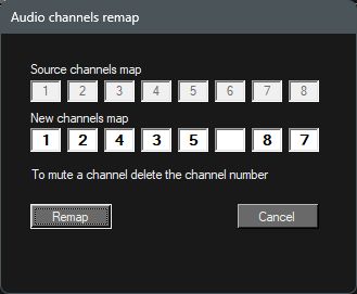

  17. Newest beta (v3.0.8.03)
    Added: Audio channels remapping
    [Attachment 69029 - Click to enlarge]

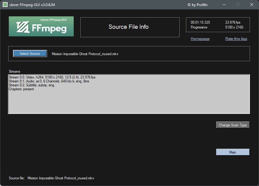

  22. This is a good GUI, with some interesting features. I noticed 2 problems: in flac encoding it's not possible to customize compression level and bit depth (16bit or 24bit). Everything is selected automatically; in this way flac encoding is almost useless. Could you add these features (flac compression level and bit depth customization) in the GUI next versions ?
    Besides, I tried to open some 2160p video file but always failed. I wonder if the GUI supports 2160p video resolution file.
  23. Originally Posted by AlanFord54 View Post
    The flac settings are almost finished and will be integrated in the next beta.
    As for the second problem. Which error occurs?
    No problem here, as you can see.
    [Attachment 69127 - Click to enlarge]

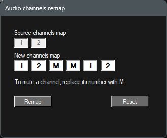

  24. Newest beta (v3.0.8.04)
    improved: Audio channels remapping
    In this example, the audio source is re-encoded from stereo to 5.1, with FL and BL replaced with Left, FR and BR replaced with Right, and FC and LFE muted.
    [Attachment 69128 - Click to enlarge]
