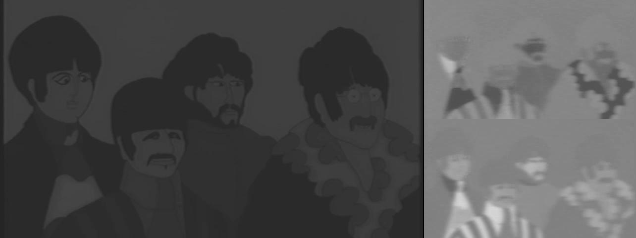

The chroma is ok, it's the luma that's messed up.
frame 33, a bad frame:
[Attachment 51811 - Click to enlarge]

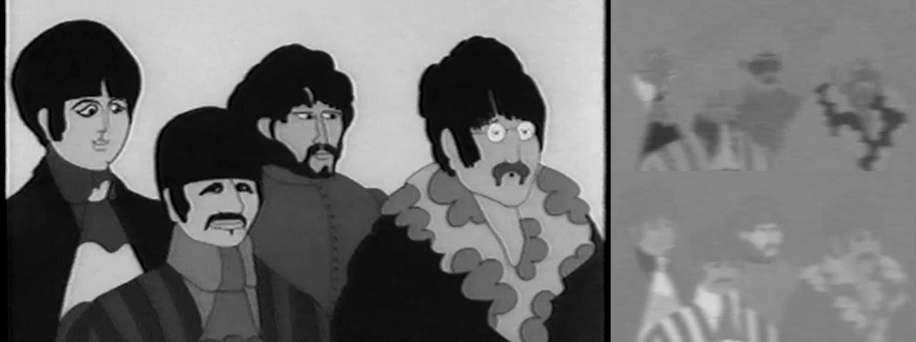

frame 35, a good frame:
[Attachment 51812 - Click to enlarge]
Luma is on the left, U and V on the right. A Macrovision protected VHS tape? I don't know what the ADVC-100 does with Macrovsion. -

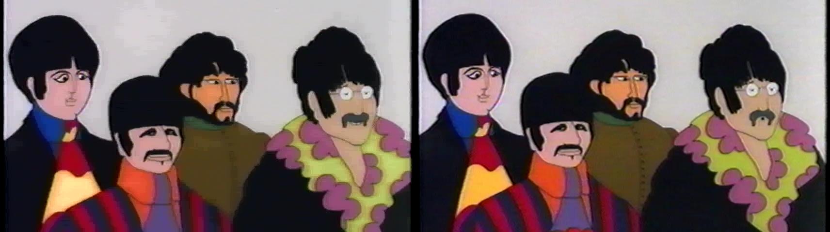

By the way, here's frame 33 of your video (on the left) with levels modified to match frame 35 (on the right):
[Attachment 51928 - Click to enlarge]
That was done in AviSynth with SmoothTweak(contrast=8.5, brightness=-294). -
