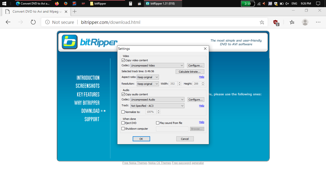

  18. Image
    [Attachment 51677 - Click to enlarge]
    http://bitripper.com/
    Found another great program - direct DVD to Uncompressed & Lossless ripping!

    For Blu-Ray, no. I did a speed test a few months ago comparing the rip/remux speed of MakeMKV on my I7 system and my several [years old] AMD A6 laptop and results were virtually the same, ~30 minutes because the limiting factor is the speed of the optical drive. I used to use my 10+ year old original Quad Core Q6700 up until a couple of years ago.
    I talked about my informal test here: https://forum.videohelp.com/threads/394781-Rip-Blu-ray-and-UHD-Movie/page2
    For UHD, youʻll need a UHD optical drive and while itʻs reported MakeMKV may be able to rip some UHDs, youʻll probably need to use something like DVDFab UHD DVD Ripper.

    Originally Posted by babygdav View Post
    https://forum.videohelp.com/threads/189181-DVD-to-UNCOMPRESSED-avi
    Past suggestions for converting to lossless format.
    https://siarchives.si.edu/what-we-do/digital-curation/digital-video-preservation
    The Smithsonian says for archiving videos:
    "Create uncompressed video if possible. This does create large files but they retain their quality. Storage also needs to be considered with this approach however.
    If uncompressed video is not possible, use lossless instead of lossy compression. The compressed data gets restored while lossy compression alters data and quality is lost."
    Okay, Iʻve reopened the floodgates and have to comment once again that you are once again ignoring the point of this thread and misunderstanding the needs of the OP.
    Converting a DVD to uncompressed does nothing, nada, zip, zero to [DVD/mpeg2] video except make it larger since itʻs already highly compressed. Waiting for lordsmurf to prove me wrong once again with his super smurfy eyes and techniques!
    It does have a use when editing since the quality loss will be less since youʻre working with an uncompressed vs compressed source (uncompressed from mpeg2 vs mpeg2).
    Youʻve once again selectively cut and pasted information to fit your argument, bordering on deliberately misleading the reader. My emphasis:
    There are some steps though that content creators shooting video can consider to ensure better accessibility and preservation in the long term.
    Use higher bit rates (affects resolution of image and size of file.)
    Use technical and descriptive metadata.
    Use containers and codecs that are stable and widely used within the community."
