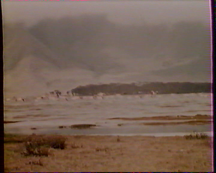

    Pioneer DVR-RT602H connected to a Diamond VC500 USB Capture device:

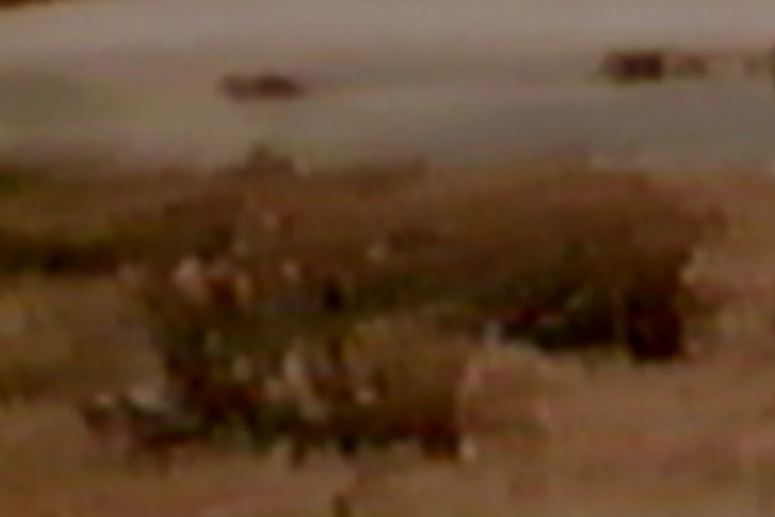

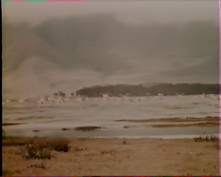

    Pioneer DVR-RT602H connected to an AverTV 507 PCI capture card:
    [Attachment 51387 - Click to enlarge]

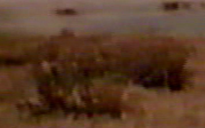

    Looks like the AverTV 507 is doing some frame correction. But I wonder if the AverTV 507 is really capturing and exporting as much picture detail as the Diamond VC500? I'm using the AverTV software that it came with to export to uncompressed AVI files. When I zoom in on the 507 version image I'm seeing less artifacts compared to the VC500. VC500 weirdness (waves seen):
    [Attachment 51389 - Click to enlarge]
    AVerTV 507 less weird (less wavy):
    [Attachment 51390 - Click to enlarge]
    The VHS tape looks like a capture from film, based on the artifacts I'm seeing when playing. But still I want to get the best results I can, without having to spend $1000+ on a professional TBC. Plus I need SECAM-L support.
    Would you consider the AVerTV 507 to be doing TBCing itself?
    The VC500 device waviness results are lame enough to cause me to just want to return the device to Amazon.

    VC500 waves on the left edge of the frame:
    [Attachment 51391 - Click to enlarge]
    Lack of similar waves with the AVerTV 507:
    [Attachment 51392 - Click to enlarge]

  2. Would you consider the AVerTV 507 to be doing TBCing itself?
    Depends what one considers TBCing, a video decoder chip has to decide where a line starts or ends in some way. I think the AverTV is a bit better at putting the start point of the lines at the right place compared to the VC500, but I dont' think it's fully buffering and resizing a video line to the correct length offset and variation like the TBCs in VCRs and some DVRs are capable of doing. The philips chips used in the AverTV are much better at handling unstable video than the chips used in the VC500.
    The Pioneer DVR-RT602H seems to have similar hardware on the DVD side as Pioneer DVRs, which are able to correct wiggle, at least for PAL and NTSC. If you have another VCR with SECAM-L playback you could try to pass the video through the Pioneer and see if it works. On some DVR-recorder/VCR combos it's also possible to cheat the unit into getting the video output to to through the internal digital circuit by putting it in some dubbing mode, but I don't know if it's possible on this one.
