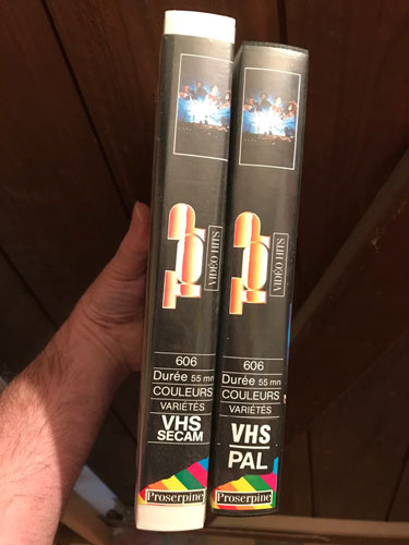

3. On the box for a tape I am looking to capture, it actually says SECAM. But I've read in other threads & forums that there are no actual SECAM tapes? Is this true? Thus even though the tape I'm looking to capture says SECAM on the box it's really just a PAL VHS cassette?

Q. 3. On the box for a tape I am looking to capture, it actually says SECAM. But I've read in other threads & forums that there are no actual SECAM tapes? Is this true? Thus even though the tape I'm looking to capture says SECAM on the box it's really just a PAL VHS cassette?
A: Yes there are actual SECAM tapes.

The tapes definitely say VHS SECAM on the case edges.

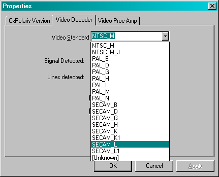

This page is trash. The focus is on VHS, yet they don't mention that if you hook up a typical VCR without stabilization directly to the VC500 and C039 (and probably the others) the result can range from sub-par to unwatchable.Regarding USB options, this page claims the Avermedia C039P is less good:
https://www.toptenreviews.com/best-vhs-to-dvd-converters#section-best-value
I have no SECAM sources to test with, and I haven't successfully reinstalled the VC500 on my recent Win7 installs. But at least on WinXP, SECAM_L and SECAM_L1 are options for Video Standard. No clue what the "1" variants here are supposed to be.I can't so far find if the Diamond device supports SECAM(-L).
[Attachment 50766 - Click to enlarge]

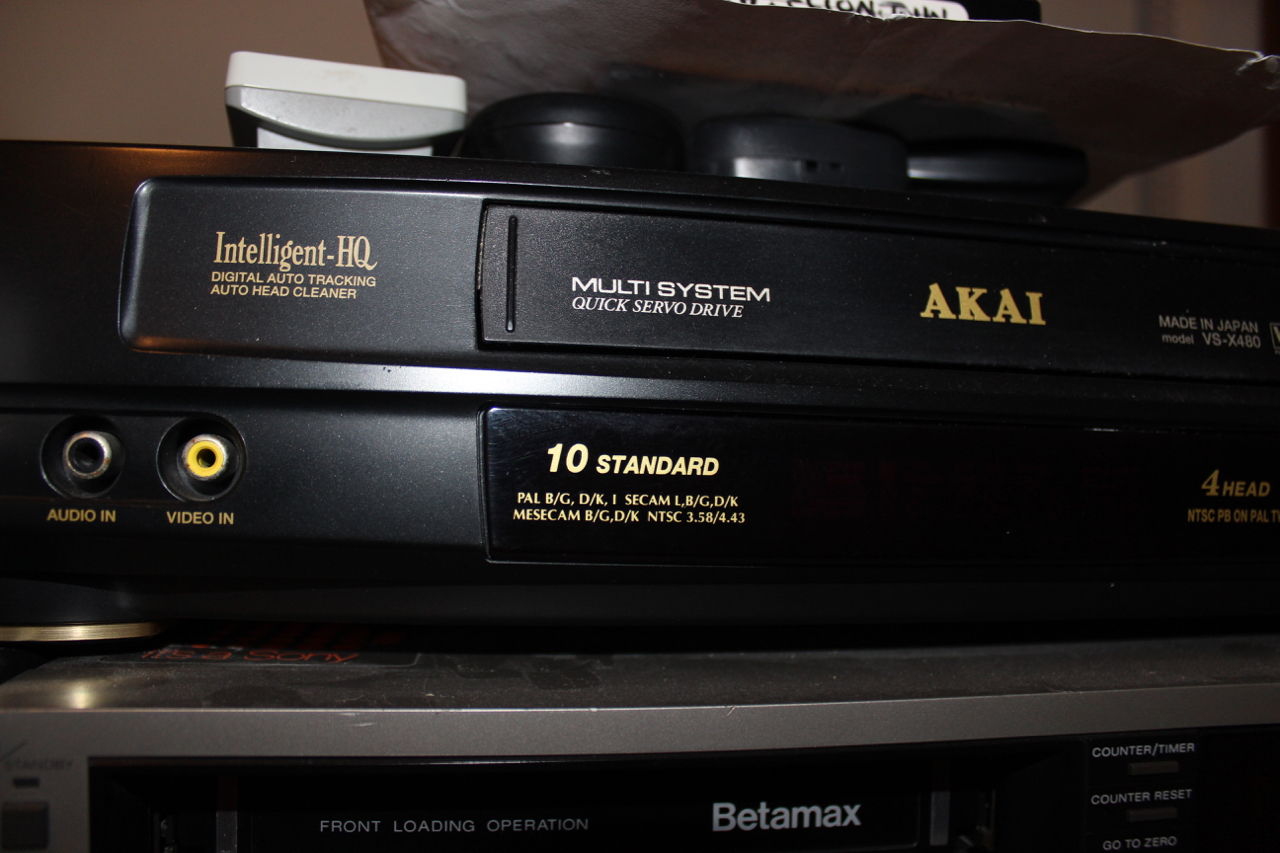

I have an Akai VSX-480 which plays Secam-L tapes, great machine, nice sharp image, but its
[Attachment 50777 - Click to enlarge] mono audio. I have it plugged into an ACE Standards convertor, outputting a PAL signal into Pioneer DVD recorders. -
