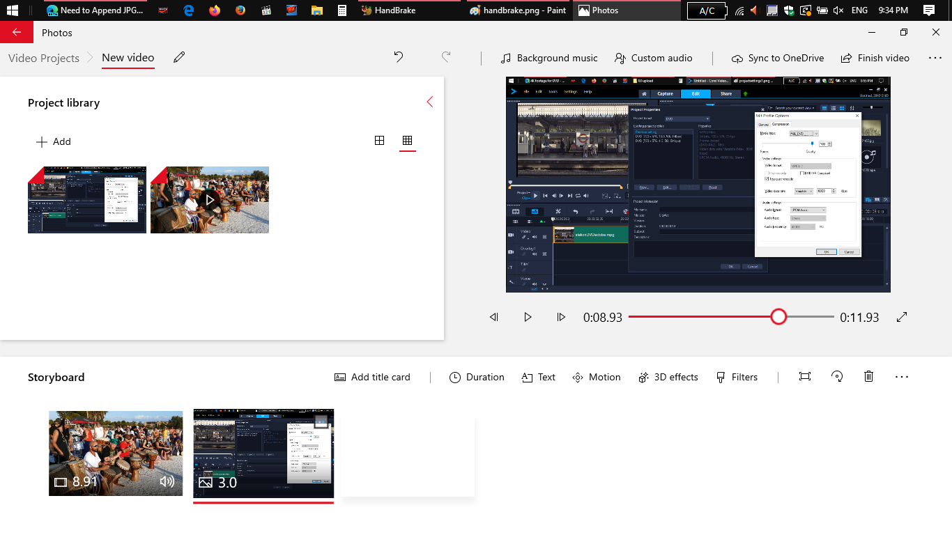

 [Attachment 51371 - Click to enlarge]
 FREE MICROSOFT PHOTOS APP does it.
 Windows 10 -> Start -> Microsoft PHOTOS app -> video projects tab.
 Add a video and photo (like I did) into the library (top left box). Drag the video into the first timeline spot on the far left, the put the photo to its right (see photo example).
 Boom, done! Just FINISH to export that video to your drive.
