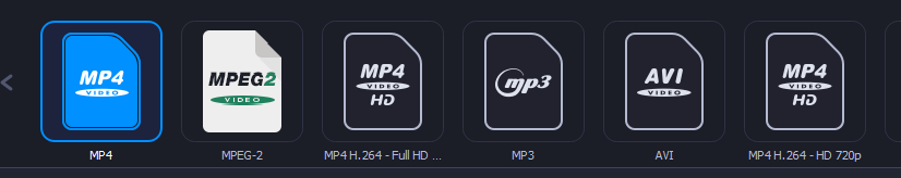

	Is every .mp4 h264, or just the HD version? (see image below)
 [Attachment 51158 - Click to enlarge]

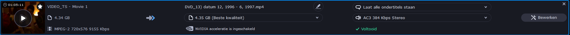

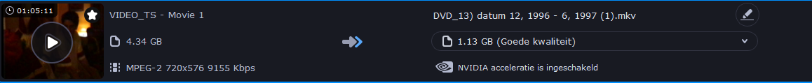

	I have .MKV as option for output. But what do you mean with "untouched" it compresses my 4.34GB DVD to a 1.13GB as shown below

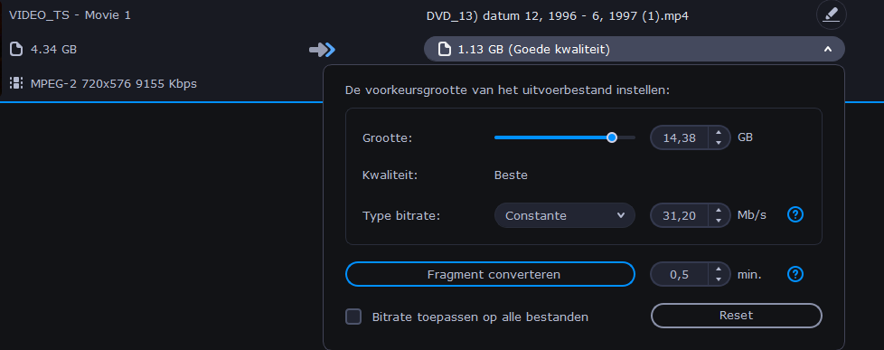

 Then my next question is, does increasing the bitrate (DVD original = 9.12mbps) to for example 12mbps make sense or not at all?Last edited by MwBakker; 19th Dec 2019 at 16:14.

	The program you are using will always recompress. The program that was suggested i.e. MakeMKV does NOT recompress.

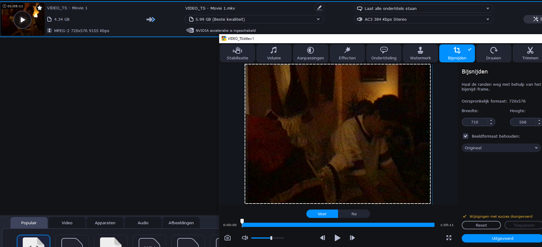

 If I keep using Movavi (paid version) and I would convert to .mkv and do all the cutting/cropping along with the conversion (this is possible with Movavi) and set the bitrate a bit higher than the original would that make me come nearest to the original quality? Or would that be with .mp4 .H264? Or is this simply a matter of trial and error instead
 [Attachment 51162 - Click to enlarge]

 I am still a little paranoid for choosing which way cause 50 dvd's cut/cropped/converted is a looong way and I want to do it right and have it saved on dropbox. Anyway thank you so far, sir
	Sorry, I missed that. If you're going to crop you have to reencode everything.

	Does Movavi have an option for specifying quality rather than bitrate? I ask, as the x264 encoder has a quality based encoding method. The bitrate will change for each video according to how hard it is to compress, rather than the quality changing because the bitrate doesn't.
 Here's a couple of encodes of sample from a DVD I had handy. Not great quality to begin with, but I'd argue I gained quality in one respect, because the source is interlaced and I used a better de-interfacer than would normally be used on playback. They were encoded at a higher quality than I'd normally use for DVDs (CRF16 for x264). The bitrate is roughly 3000kbps. Usually it'll be higher for that particular quality (I encoded a fairly static scene) but it'll be whatever it needs to be.
 Edit: Replaced the 640x480 encode with a new version as I did a silly that stretched the picture a little.Last edited by hello_hello; 20th Dec 2019 at 16:56.
	During conversion the quality seems to be determined bij the bitrate, cause when I slide the bar to "best quality" the bitrate increases but no other cases do.
 .H264 shows at .mp4 HD as output file but none of the videos at the 1994 - 200x range are HD yet.

 MKV, MP4 and AVI are all just container formats. They can each hold various types of video and audio. It'll be the same h264 video whether the output is MKV or MP4, but it's not used in an AVI container much. AVI generally implies encoding with Xvid or DivX and they're an older/different type of encoder. x264 is better. H265 and the x265 encoder are newer formats but for standard definition I still think x264 is better, and the x265 encoder is much slower.Last edited by hello_hello; 20th Dec 2019 at 06:21.
