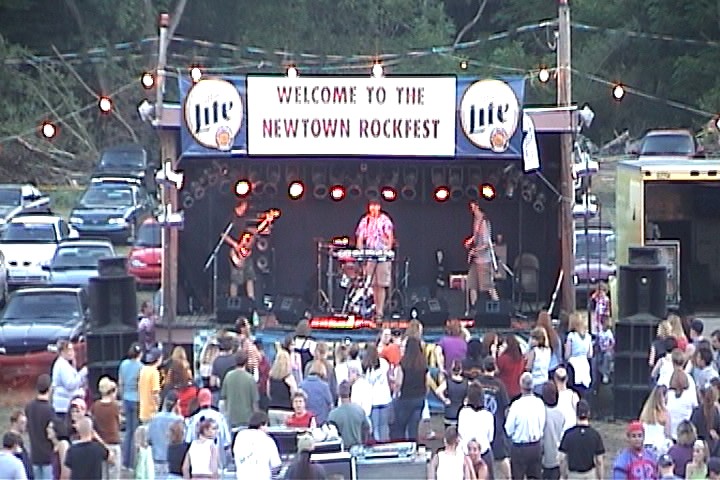

  16. How can I tell what the source aspect ratios is?
  17. Member thecoalman's Avatar
    Feb 2004
    Pennsylvania
    Eyeball it, you only have 16:9 or 4:3. If you open it up in something like Virtualdub that diplays it at the resolution size 16:9 will look tall and skinny. 4:3 will look relatively normal. Here's a sample from 16:9, i will be more noticeable with PAL because of the increased vertical resolution.
