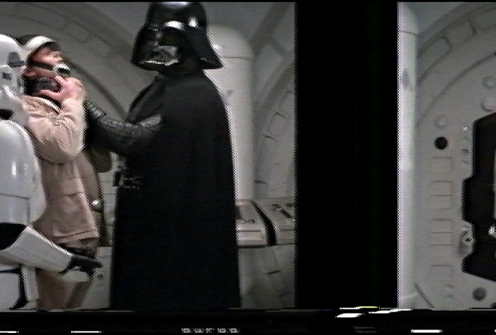

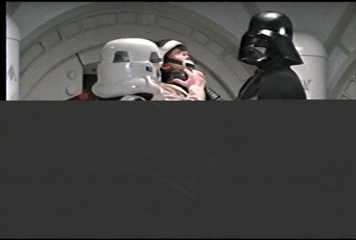

    Those random garbage jump-back frames in the middle of the post-Fast Forward playback in FFWD.mkv are unfortunate. Two seconds have passed since the end of Search, but it's still acting unstable.
    [Attachment 50785 - Click to enlarge]
    [Attachment 50786 - Click to enlarge]

  15. Good call on the multi-gen tape! I'll see if I can put one together today.
    And yes - not sure about how that stabilization period compares to other TBCs or if it is due to the VRC itself, could try with Hi8 player.
    As for centering, yes it is possible - however I've noticed that by default the dev board aligns what it thinks is the active part of the frame to the right. This means I can always do a left 16 pixel crop of the horizontal blanking for every tape at 704x480 (https://en.wikipedia.org/wiki/Standard-definition_television). This looks good 80%+ of the time without having to manually dial in my crops, good enough for viewing and I always have the raw to go back to if needed. You can also sometimes see a tiny fuzzy edge a pixel wide so you know its not cropping any of the active frame. So while it doesn't look as good raw, it makes bulk cleanup easier after. I did solve the issue of it shifting the video up and cropping the top, that for sure was losing the top of the frame. Now it just has the extra 6 pixels that AJA likes to capture at 720x486.

  27. After more experimentation, I've made what most won't find useful but a few might find interesting: a 'full' 525 line capture. I can't do it in one go, and it requires capturing the same frames twice to stitch the active frame and VBI together.
    Figured I'd use a low quality tape to show more of how the ADV7842 handles SLP tapes with unstable time base. Audio is, likewise, terrible.
    I've seen some code out there to slice VBI info (closed caption at least) from video data and I'm tracking the awesome Domesday Duplicator work with raw RF, but is anyone else aware of existing work on decoding various VBI info from 'raw' video data? The ADV7842 has multiple built in decoders for closed caption, teletext, VITC, CGMS, and Gemstar, but I'm still working thru how that data gets passed over HDMI and captured in a meaningful way on the other end. The AJA Kona Lhi does have the ability to capture VANC... just trying to make them talk.

    If anyone wants to do some pixel peeping, I've got another test tape attached. Sadly I haven't found a reputable commercial test tape, so this is home recorded and captured. Not sure how useful it is since it combines VCR recording, playback, and capture flavors all together so doesn't reveal at what point the artifacts are introduced. Helps confirm chroma/luma levels though! Had to dial things back so the ramps didn't clip chroma and commercial tapes didn't clip their macrovision signals (They're supposed to be blown out at 117 IRE... so I'll have to brighten when converting to the final playback format).
  30. Self necro - I could use some fresh eyes.
    Have I finally reached success at the end of tweaking my capture workflow or should I let the wookie win?
    Workflow:
    JVC HR-S2902U -> s-video (EDIT mode, everything else disabled)
    EVAL-ADV7842-7511P -> hdmi (frame+line TBCs enabled)
    AJA KONA LHi -> lossless 10bit 4:2:2 video w/ 24bit audio
    ffmpeg -> ffv1/flac for archive -> h264/aac for use (qtgmc, pad and scale to 640:480 w/ PAR 1:1, normalize audio)
    Otherwise, I hope that vhs-decode succeeds in creating the most future proof archive copies of analog tapes.
    ...I also secretly hope it fails so I don't have to redo all my captures.
    Anyone else have this tape and want to compare? I'd appreciate seeing a better transfer!
