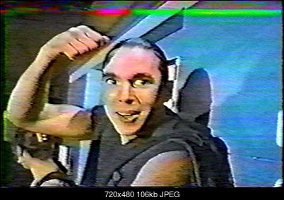

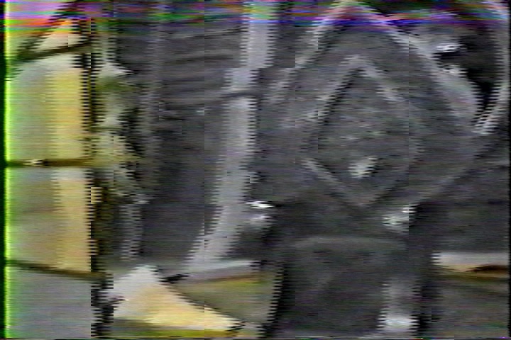

    - When it can't cope with VSYNC, it often takes one field and interpolates it to fill the frame. When it gives up, it drops to black. Ex: frames 52, 74, 125 of the external capture; f20, 52, 74 of the internal. See attached JPG.

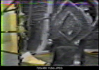

    - There are obvious DV compression issues at times, where the image breaks up into large blocky segments. These are mainly, but not exclusively, caused by recording stop-start and unrecorded portions. Weird glitch with Sony's encoder chip, or what? This artifact appears twice in Nth Gen clip 2.

Name:	Nth Gen [Play #4] - HS-HD2000U =YC= HM-DH5U _ f152.jpg

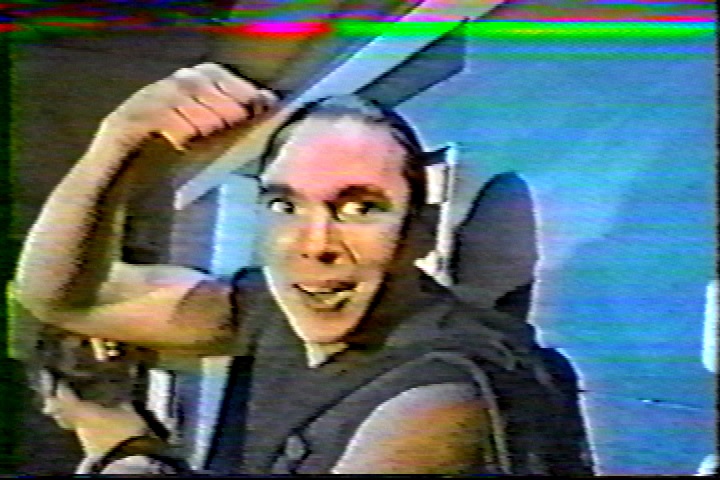

    Screenshots of some Digital8 AVDV conversion artifacts:
    Interpolation of field to fill frame.
Name:	Digital8 interpolation - Nth Gen [Play #4] - DCR-TRV340.jpg

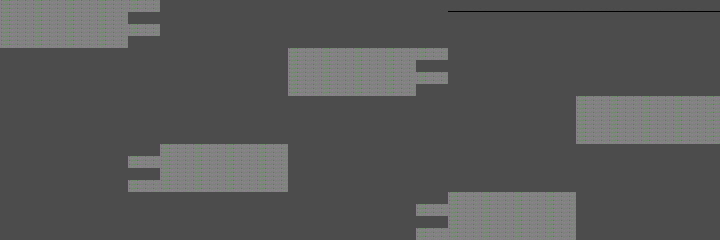

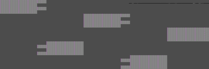

    Weirdness during recovery from unrecorded portion of tape (these are the separated fields). The green and magenta dots remind me of chroma siting diagrams.
Name:	Digital8 chroma dots, field 1 - Nth Gen [Play #4] - DCR-TRV340.png
ID:	41394 Click image for larger version
Name:	Digital8 chroma dots, field 2 - Nth Gen [Play #4] - DCR-TRV340.png
    I measured the blocks in this frame as being 32x24. No idea what that corresponds to.
Name:	Digital8 32x24 block corruption - Nth Gen [Play #4] - DCR-TRV340.jpg
