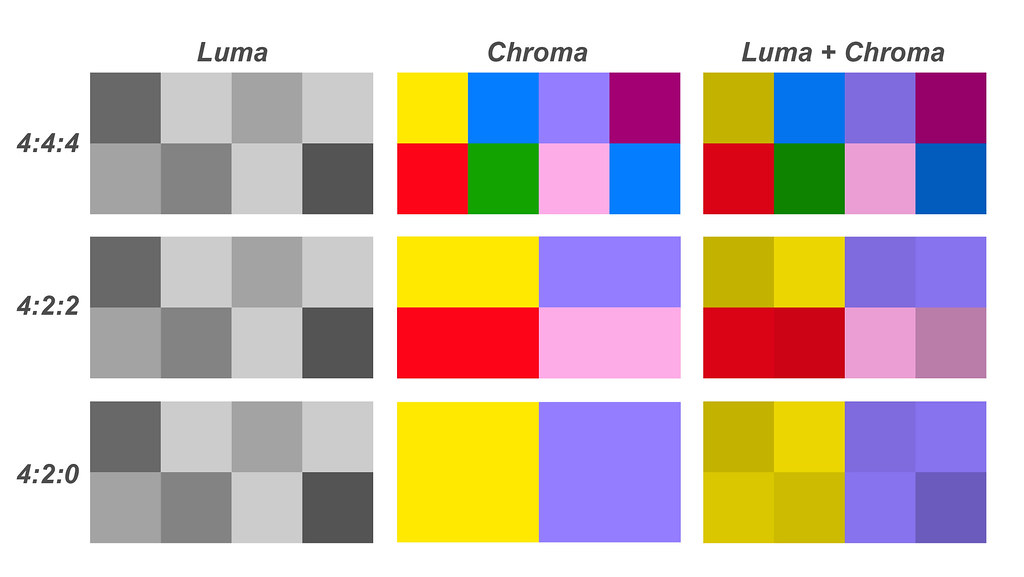

    Changing subsampling alone, means to resize chroma for sure. To do it physically to a plane, there is no difference doing it between Y or U or V, resize is resize.
    So there is a change. Bicubic interpolates using certain alghorithms, like Bilinear, like Lanczos etc. But not Point resize.
    so you definitely resize two planes even if not apparent on screen
    Wait, you lost me there. I was talking about not doing any resizing at all, but only changing the colorspace. If I have a 1280x720 pixel frame in YUV420p8 and I convert it to YUV444P10, how would the Y plane change size, first of all? (even if the U and V did)
  4. 8bit to 10bit changes value alone. If having Y value for pixel is 25, then 10bit value would be 25x2x2 = 100
    YUV420P8 to YUV444P10 does not change dimension of Y, just value. When I said resize is a resize I ment chroma resize is the same as Y resize. You might tend to think that chroma resize is something else than Y resize (only if width and height of video is changed). But mathematically it is the same.
    Changing subsampling is unrelated to bit depth

    So you know , that if you are going from YUV420 to YUV444 you are actually resizing? Two planes out of tree. Doubling their resolution. And if going from 8bit to 10 bit you also increase plane values, assigning 2bytes (0-1023) for a value instead of just one byte (0-255) for a value.
    If you have enough bitrates for encoder, meaning you do not starve them and picture would not start to break up, colors will stay the same. If encoder changed colors it would not be tolerated. Sure, there should not be something messed up in the process - before feeding video to encoder (matrix is different in Vapoursynth,Avisynth, ffmpeg etc., decoder problems) or in the process of getting visual of those YUV values, again wrong matrix is presumed, wrong range during preview, something wrong with RGB conversion like you use Lanczos for that RGB conversion, personally I use Point resize for RGB conversion on screen.
    Actually, if someone knows where to use Point and when to rather use other resize method would be appropriated. For upscale Point, for downscale bilinear? To see colors that are closest to original, no enhancing sort of. YUV to RGB for preview only.
    Sure you never see exact colors if previewing YUV. Pixel values are converted and changed to RGB 8bit value for preview, but the difference would not be visible. Maybe some testing , computer generated images, but not real life videos. If you see RGB 191,0,1 instead of 190,0,0 you would not notice at all in real life scenario. The best to see those differences is using those common testing images. How that RGB preview value changes a bit, but nothing serious to be caught by our brain in real life situation.
    If using Vapoursynth's VSEdit (or Avisynth I guess as well) , you can always see those thru YUV values as well, if interested. Or you can use your scripts to pull those values out of video. With Vapoutsynth you can have a function that returns YUV values, if giving pixel coordinates, frame number and video, it is actually not that difficult at all.

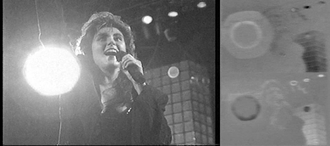

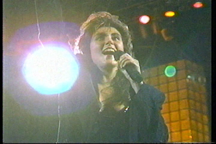

  26. You can always view the Y, U, and V planes directly in a tool like AviSynth:
    WhateverSource()
    StackHorizontal(GreyScale(), StackVertical(UtoY(), VtoY()))
    [Attachment 50753 - Click to enlarge]
    Y on the left, U at the top right, V at the bottom right. Color frame:
    [Attachment 50754 - Click to enlarge]
