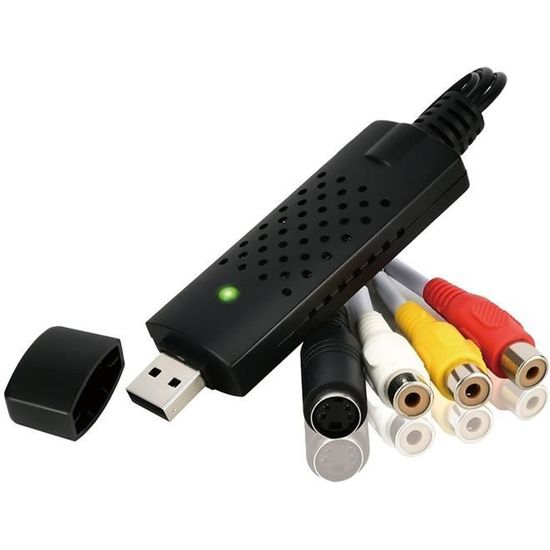

  5. To capture :
    connected to a TOSHIBA RD-XV47

    You're using a junky Easycap. This exact problem is a known issue. The card amplifies timing errors, and looks even worse than it really is.
    But still get a TBC, or TBC(ish) at worst.
    And upgrade from that $5 Chinese junk card (which you probably massively overpaid for).
