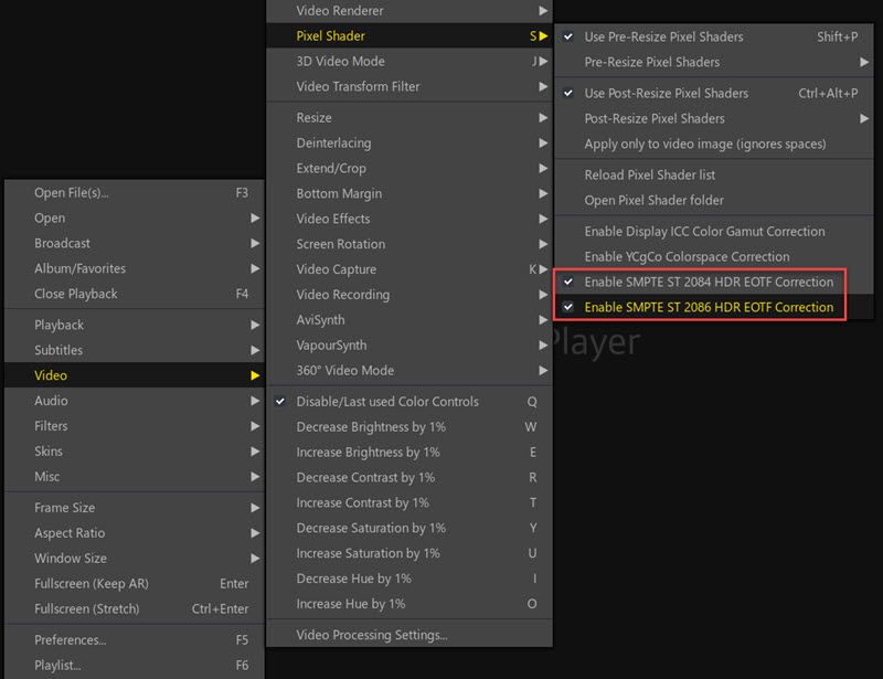

  4. App Digger JKyle's Avatar
    Oct 2018
    Originally Posted by DJboutit View Post
    Which videos players can do HDR I have Potplayer I am not sure if it does hdr??
    [Attachment 50238 - Click to enlarge]
    Right click & enable both SMPTE ST HDR EOFF Corrections.
    Thank you so much for this. I have been using potplayer on my PC for so long and I could never get proper HDR. Well I am not sure if it's proper HDR yet but it's certainly much better than before.
    Potplayer needs to fix this. By default, 2086 should be enabled whenever HDR is enabled
