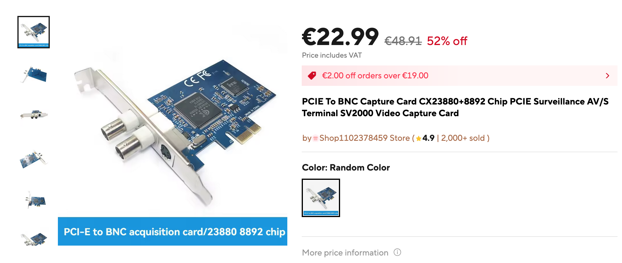

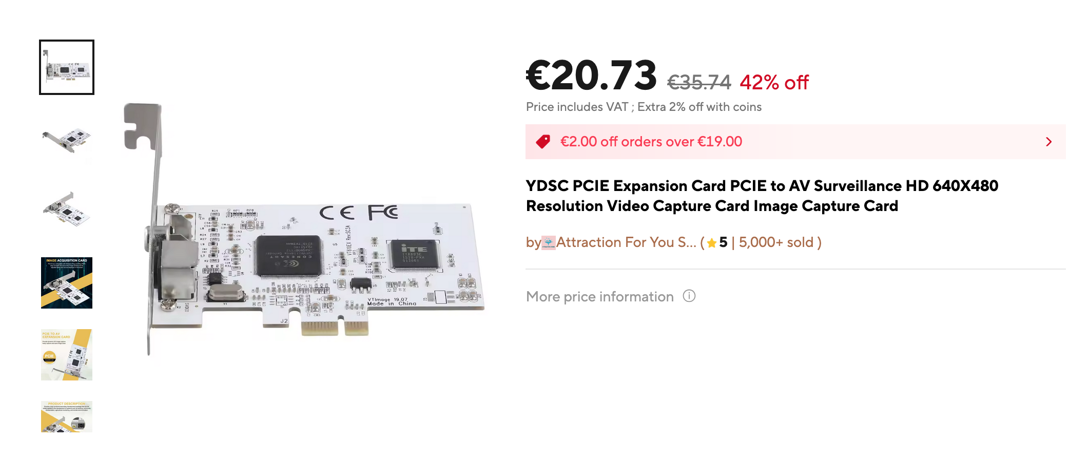

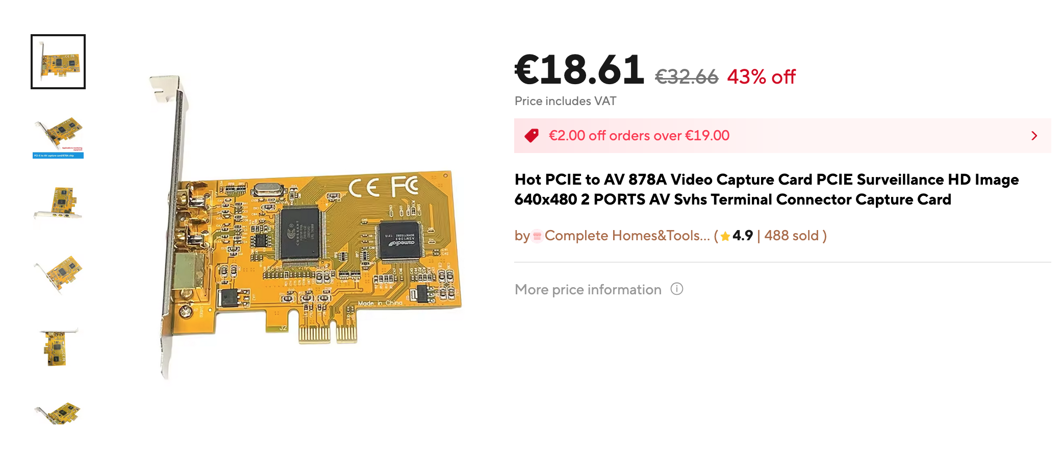

    you mention brooktree bt848 and 878.
    no nobody will rewrite drivers for those, but i just checked sampling frequency of vhs-decode projects:
    https://github.com/oyvindln/vhs-decode/wiki/Signal-Sampling
    they're actualy using LOWER sampling freq. than bt8x8!
    https://en.wikipedia.org/wiki/Brooktree
    vhs-decode uses something else, some cheap surveillance card with newer conexant chip (conexant bought brooktree) (which seems to be not so cheap now?) and a re now making alltogether different hardware.
    i used cheap bt878 card a lot, in pal land, no issues with quality or reliability.
    yes, color on vhs is crap, yes, especially visible on reds. it's even less than 60 lines. vhs can't stack 60 vertical lines of different colors on screen. and neither can s-vhs. and it quickly falls apart if you copy it on another (s)vhs machine.
    frankly i doubt anybody can demonstrate big difference between good hardware setups (be it vhs or s-vhs....you'll still be capturing vhs recordings ie not s-vhs recordings....s-vhs has the edge by separating luma and chroma, but only if the recording had is separate too, ie if vhs tape was made via composite copying what exactly are you gaining on s-vhs machine? to that extent i'm just watching some of the stuff from ITV archive on yt: i'm finding composite video with composite video issues
    https://www.youtube.com/@ITNArchive early 90s european production
    ) and vhs-decode.
    but many can demonstrate difference between crappy vcrs and crappy capture cards vs. vhs-decode!
    https://www.youtube.com/watch?v=CQ-u979_6Cw vhs-decode is clear winner there, sharpness and stability.
    this was captured from Panasonic NV-SD220. i had that vcr. i have machine producing sharper images now.
    even when capturing tapes recorded on sd220, it's sharper.
    pasteur10, that's rf, but radio rf!
    can't be used for video.
    software defined radio is ment to decode radio rf modulations.
    abour cards:
    https://github.com/oyvindln/vhs-decode/wiki/CX-Cards
    notice the "capture hardware" links on the right....below "software installation" links.

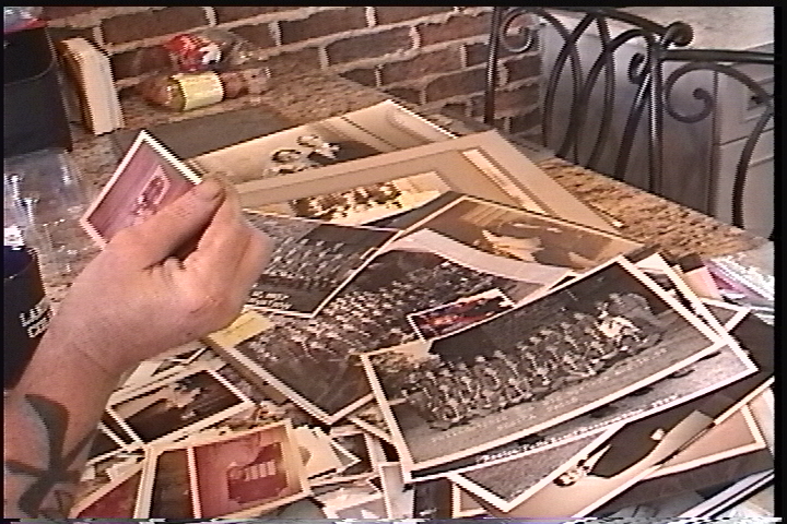

    I see excessive blanking space on the left and right of the frame compared to my capture, Was it the Cypress or the Pinnacle 510 adding that?
    Don't have another capture card to test, but it's the Cypress that at least causes more blanking space on the right, can really only compared clips that use it and don't use it in the chain.
    Edit - Just added a with and without comparison, granted the camera used to record this footage includes extra blanking space on the right and top.
    [Attachment 86521 - Click to enlarge]
    [Attachment 86520 - Click to enlarge]
