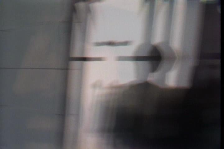

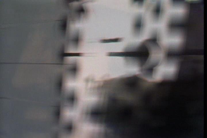

  10. That clip was once normal interlaced video. But somebody resized it incorrectly and the two fields have been co-mingled. So there's no way to restore the original motion. You can simulate how an interlaced TV might display the remaining mangled video:
    Mpeg2Source("VTS_30_1.d2v")
    nnedi3(field=3) # 60p
    [Attachment 49428 - Click to enlarge]
    Or blur the two fields together to make it look like a blend deinterlace:
    Blur(0.0, 1.0) # 30p
    [Attachment 49429 - Click to enlarge]
  11. I already tried everything I found on the internet and I do not find an effective solution so I ask here for someone to help me with the video. Thank you very much for your help.
    thank you for the answer, and for the resize ? what you think is the right size ? there is some rule or trick to find the right size for a DVDrip ?
    thanks so much for your help
