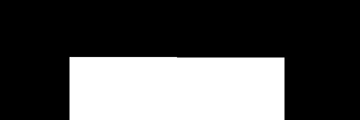

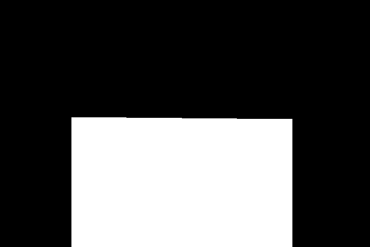

  8. Originally Posted by IllusionSector View Post
    I know that offsetting just the odd or just the even frames by a pixel will compensate for this
    No it won't. Whether a horizontal edge bounces or not depends on which scan line it's on. Some edges within the file are bouncing up and down relative to the other field, but some are not. If you you move the field down to fix the edges that were bouncing the edges that were not bounce will start bounding.
    For example, a frame with a sharp horizontal edge:
    [Attachment 40051 - Click to enlarge]
    after SeparateFields():
    [Attachment 40052 - Click to enlarge]
    Note how the first quarter of the top edge is not bouncing, the second quarter is, etc. If you move the field down by a scan line so the second quarter is no longer bouncing, the first quarter will bounce.
