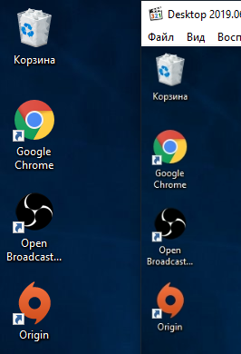

  2. Image
    [Attachment 49277 - Click to enlarge]

  16. Originally Posted by KarMa View Post
    Originally Posted by NiceWall07 View Post
    The MPC-HC image is being resized down to fit the MPC-HC menu. The video is probably not displaying 1:1
    I climb in the settings, I toyed with various options. Not help(
    The only way to view your 1080p video, in Full 1080p resolution in MPC-HC, is in FULL SCREEN MODE. If it's not in Full Screen Mode, MPC-HC will shrink the output.
    Again, your video is 1080p. You are recording in 1080p. It's not 720p. It's 1080p. Nothing is wrong with the resolution.

  20. Originally Posted by NiceWall07 View Post
    In full screen mode, the image looks just as bad
    Not in a window maximized to full screen -- full screen mode. In MPCHC use Alt+Enter to switch to full screen. There will be no title bar, no menu bar, and no borders. The 1920x1080 video will map 1:1 with the 1920x1080 display.
    Another thing to keep in mind is that your desktop is RGB whereas the captured video is YUV 4:2:0. That means the 1920x1080 video will have a 1920x1080 luma (Y) channel but 960x540 chroma (U, V) channels. So you expect colors to blur a bit. Even if you manage to encode your video as RGB or YUV 4:4:4 (no blurring of colors) Youtube is going to convert to YUV 4:2:0 so colors will get blurred.

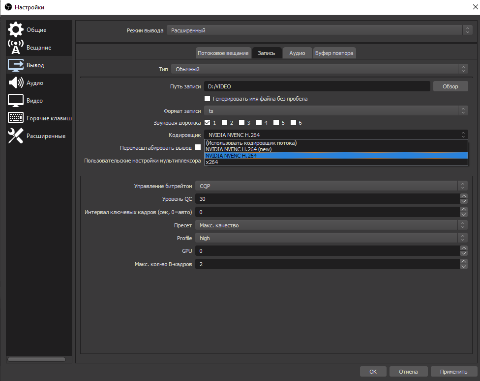

    I set the maximum bitrate at 100,000.
    Such settings as you I can not set, I have a video card from NVIDIA

    Yes you have a Nvidia card but it also supports CQP. In that picture you have it set to 30. Maybe set it to 18 or lower. Low numbers equal better quality. High numbers equal lower quality.
    Try уровенъ QC=18

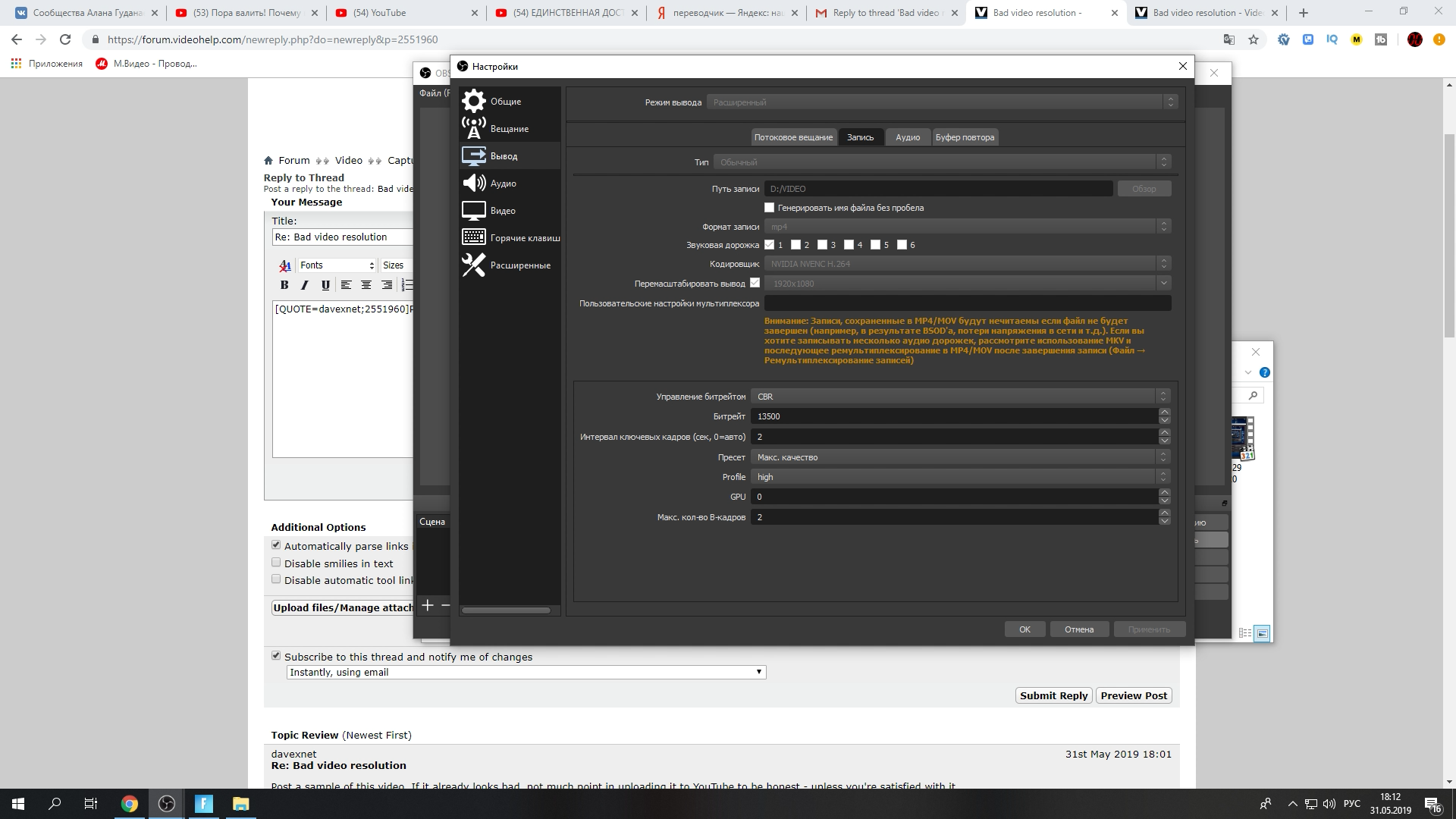

    Changed to the value - 1. Don't know, doesn't help(
    Once again, "maximum bitrate" is not the same thing as "average bitrate".
    And you screenshot shows you aren't using bitrate based encoding. You have the encoder set up for CQ encoding with a quantizer of 30. If you're going to use CQ encoding you need to reduce the quantizer to 10 or so to get a clean picture. I've told you this several times now.
  25. Originally Posted by NiceWall07 View Post
    And now you've changed to bitrate based encoding (CBR) with an average bitrate of 13.5 Mb/s. And you're still showing a screen cap of a scaled (at playback) video, not the full 1920x1080 video.
