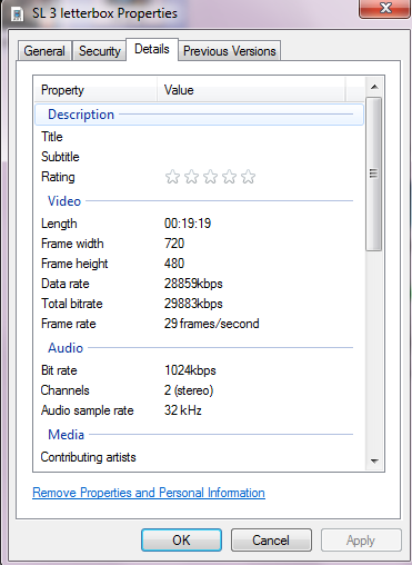

	I just turn on the camera, and a tranfer window pops up. I'm not using any software.
 If the cam shoots in 1080, why is my file 720 on the PC?
 [Attachment 49095 - Click to enlarge]
 It tells me it is a Window Media File. Under details it says 720
	That's not 720p.
 That is 480p (SD)
 Either on of two possibities here.
 1. You did not record at 1080p as you thought.
 2. The transfer from the camera did an intermediate conversion
 or even
 3. It was not a HDV recording
	Also read this topic
 https://forum.videohelp.com/threads/384804-Any-firewire-capture-software-for-Windows-1...-actually-work
 And check your camera settings before a pc-based transfer
	Just because it's currently set to record 1080i doesn't mean what's on your existing tapes is 1080i. When you play a tape on the camcorder it should show you whether it's playing HDV1080i, DVCAM, or DV -- on the camera's LCD display. The latter two are both 480i (576i for PAL). I don't know if the camera can convert from 1080i to 480i on the fly. Look for an output setting that would control that.
	Also...
 Of course you're using software. You just don't know what it is. Do not let it capture to WMV (Windows capture module will recompress to a poor quality WMV codec). Standard definition DV should be captured as DV in AVI. HDV should be captured as MPEG 2 in M2T.
