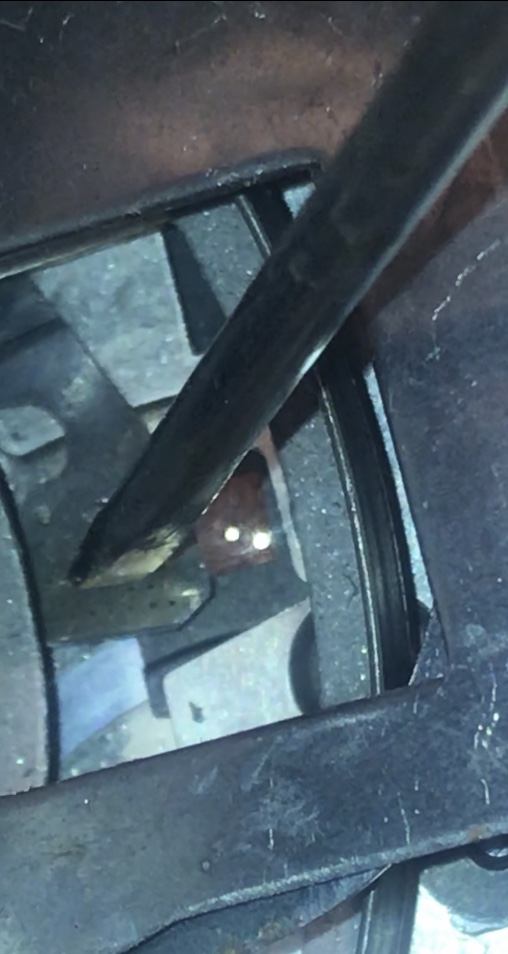

    @ Ozymango: on this projector, I get the pattern of dots, haven’t seen that on my previous ones, and get that on screen too, I have it apart and see the pattern template there , can’t see frames either. Do you have any ideas ? Thanks [ATTACH]

  14. Originally Posted by Jim Howell View Post
    Does this projector have a "still" mode? Because that pattern looks very much to me like the screen of a "light diffuser mesh" that a lot of projectors have when the lever is in "still" mode -- this blocks the light of the (very hot bright) bulb to a very large degree, so that it doesn't melt the film but does allow enough light through to light a single still frame. It'll be dimmer than a normal-speed frame, but looks okay on a projected screen.
    That's sure what it looks like to me, but that's assuming that projector has a still-frame mode. If not ... hmmm ... well it still looks like a diffuser-mesh screen which somehow got dropped into the light path. If I'm even close, if you open the bulb compartment, the screen/mesh should be pretty much directly in front of the gate opening between the film and the bulb. It'll be on some kind of spring-loaded arm (usually) and you can move it out of the way (usually up) with your finger or a cotton swab or like that.
    Anyway try opening the bulb housing compartment, pull the bulb if needed for better access, and see what things look like from the inside, and we'll go from there.

    Hello, pretty sure it doesn’t have still, but right about it falling down, I have moved it, very little, I need to take out bulb, how ? Lol, I didn’t want to unscrew if it’s a pullout !?! Thank you, you do know your stuff!

    Thee it is.. thanks a million !!

    Feb 2020
    Missouri
    [Attachment 51959 - Click to enlarge]
    That’s the first one, there’s another smaller one deeper, it slides down in forward and reverse, is it useful ? Thx

  18. These little screens are useful if you're still using the stock (very very hot) bulb and you ever do any freeze-frame or even slow playback mode, because they'll keep your film from metling due to the tremendous heat of those bulbs. I very very rarely playback my home movies at anything besides normal speed, so I never really thing about these screens -- until they stick and you gotta pull the projector apart to get to them. Well as long as you know where they are and how to unstick them when needed, I'd just leave them alone -- though if they keep sticking it might be a good time to think about doing a belt-and-lube job to the projector if you're feeling adventurous.

    The little mesh moves freely, like maybe a spring is off, I guess if I take it apart enough Ill get to that mesh and secure it or remove it. I’m testing with old films, but when it’s running good, I’m going to run the films in regular speed and video with a camera,Thanks,

    Moved the little mesh away, everything works good, thanks for your help !!
