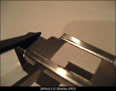

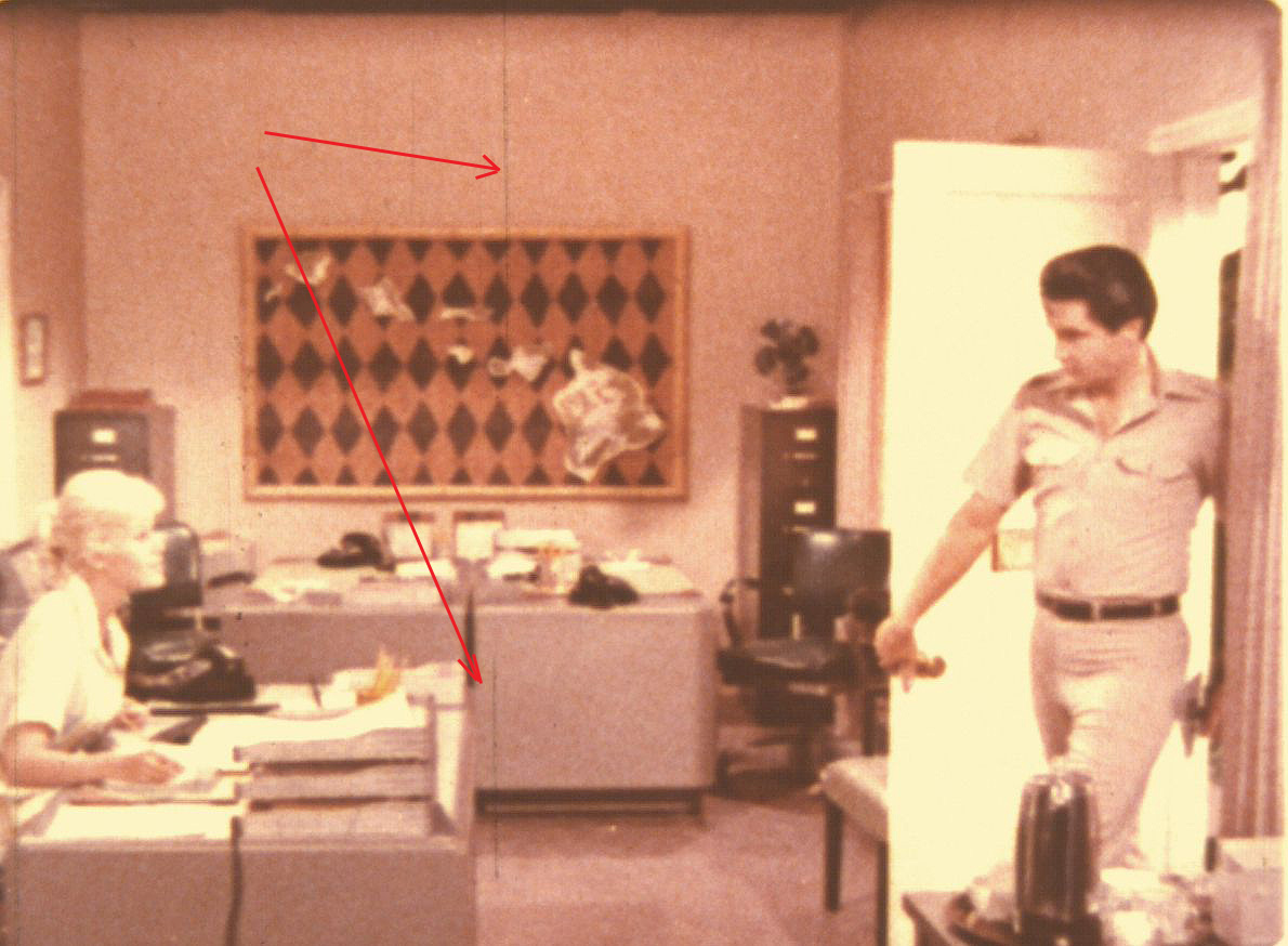

  24. ok i have found a problem and fix for the Reflecta, i have been scanning some films a few times and after just a few passes they have developed a scratch down the film picture, like this:

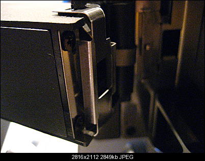

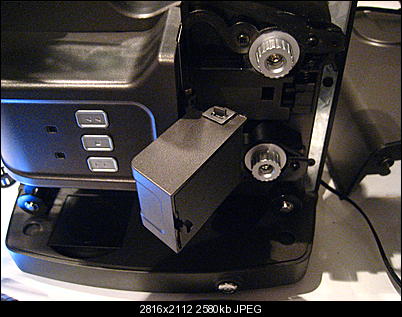

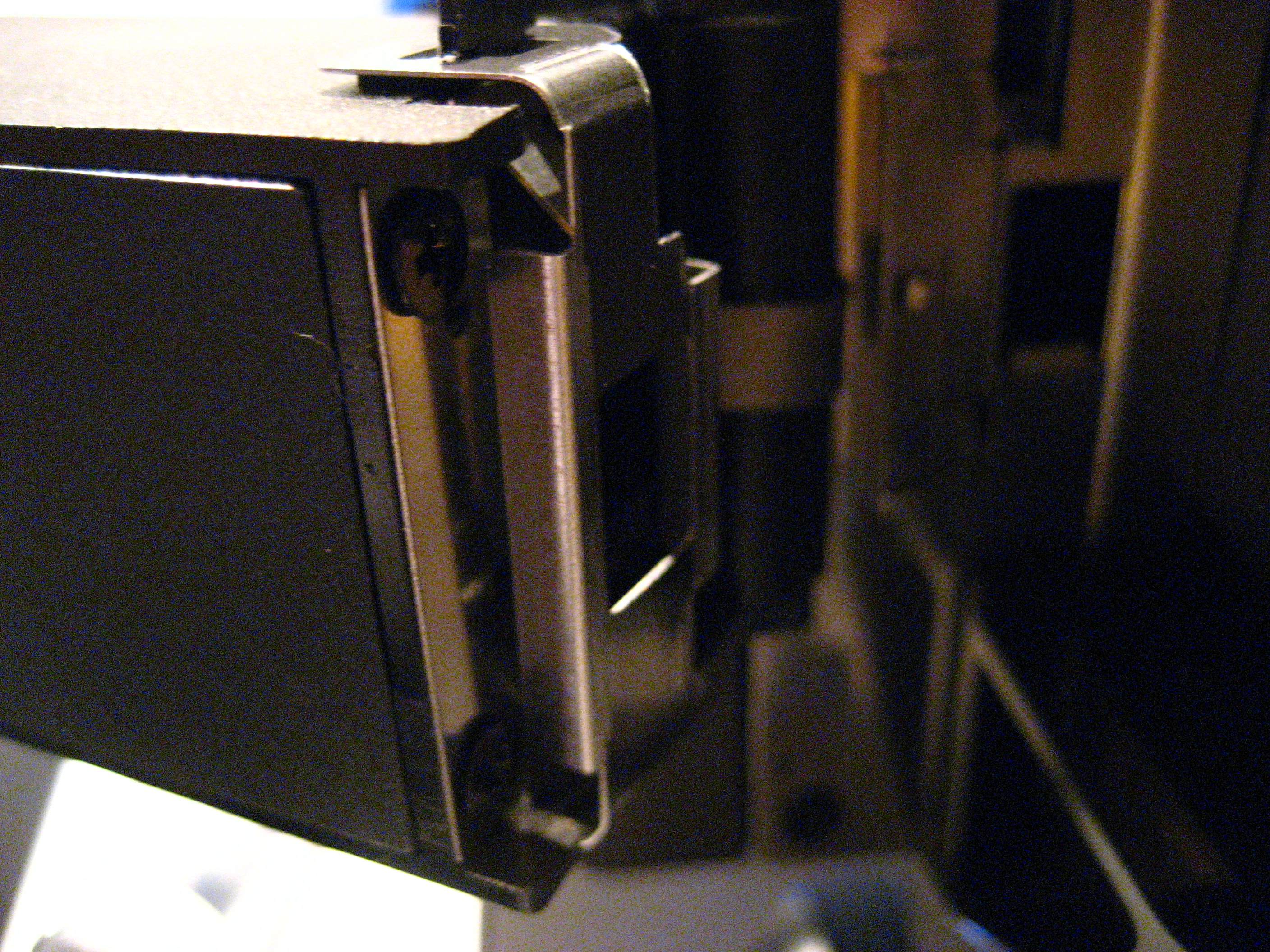

    taking a good look at the film travel through the Reflecta Scanner, you can swing open the scanner light like this:

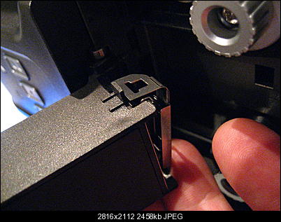

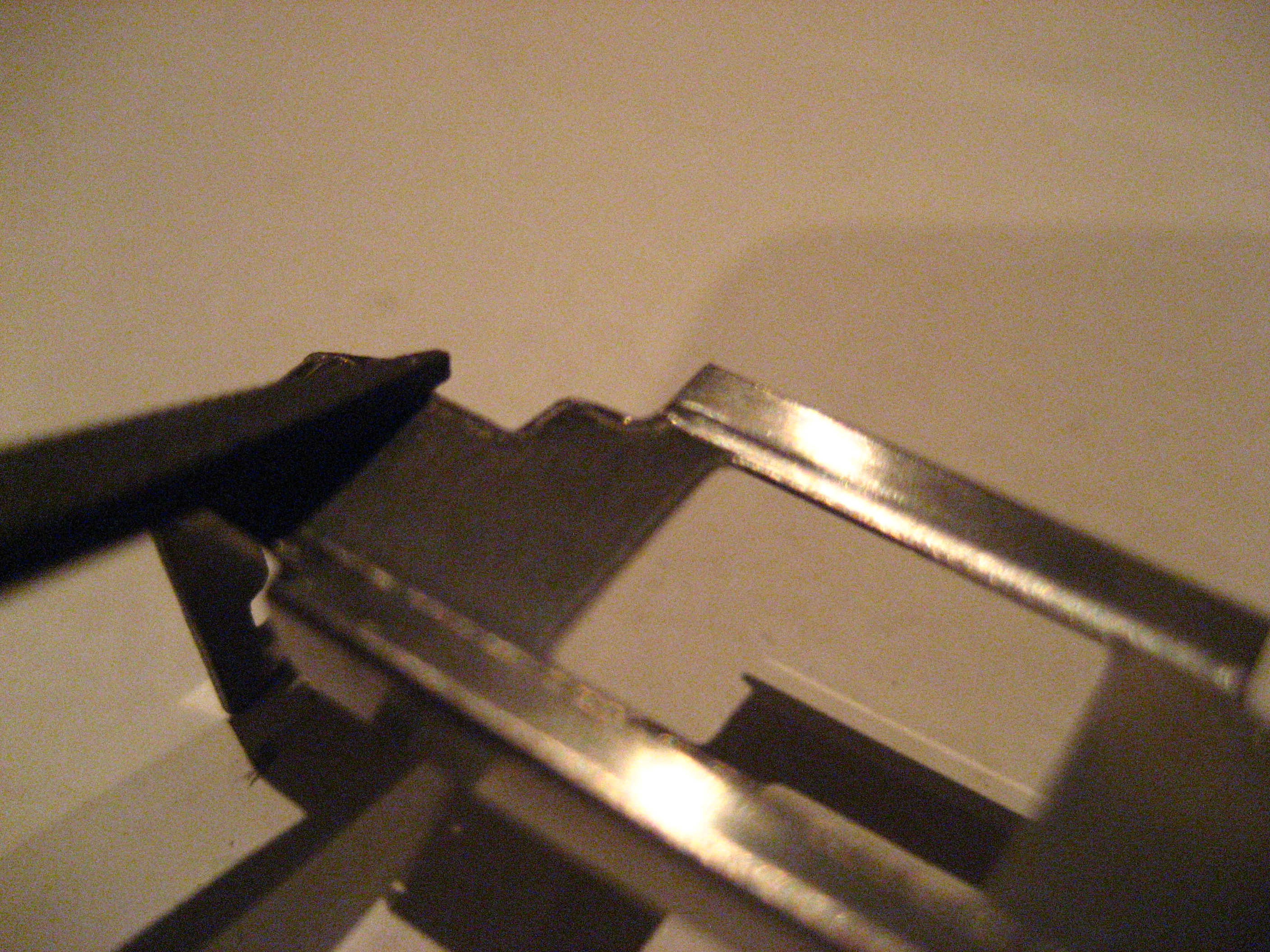

    there is a spring-loaded little silver clip that is sitting there, that squashes the film as it passes through the scanner. Its obviously made in China....

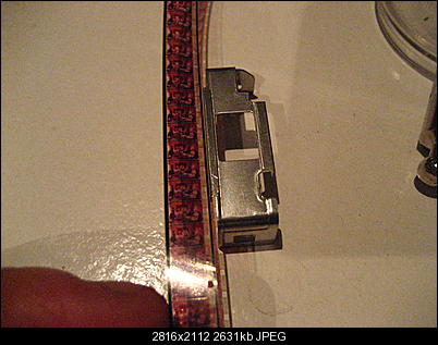

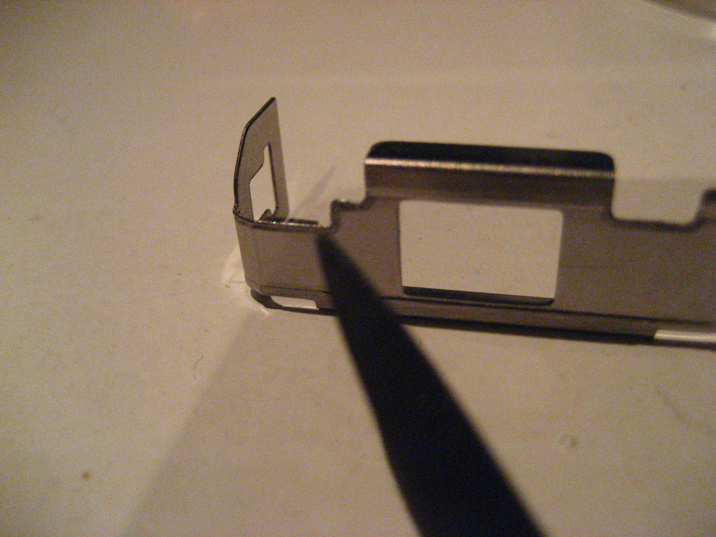

    it just wobbles on there so loose. anyways clip it off like this and remove it....

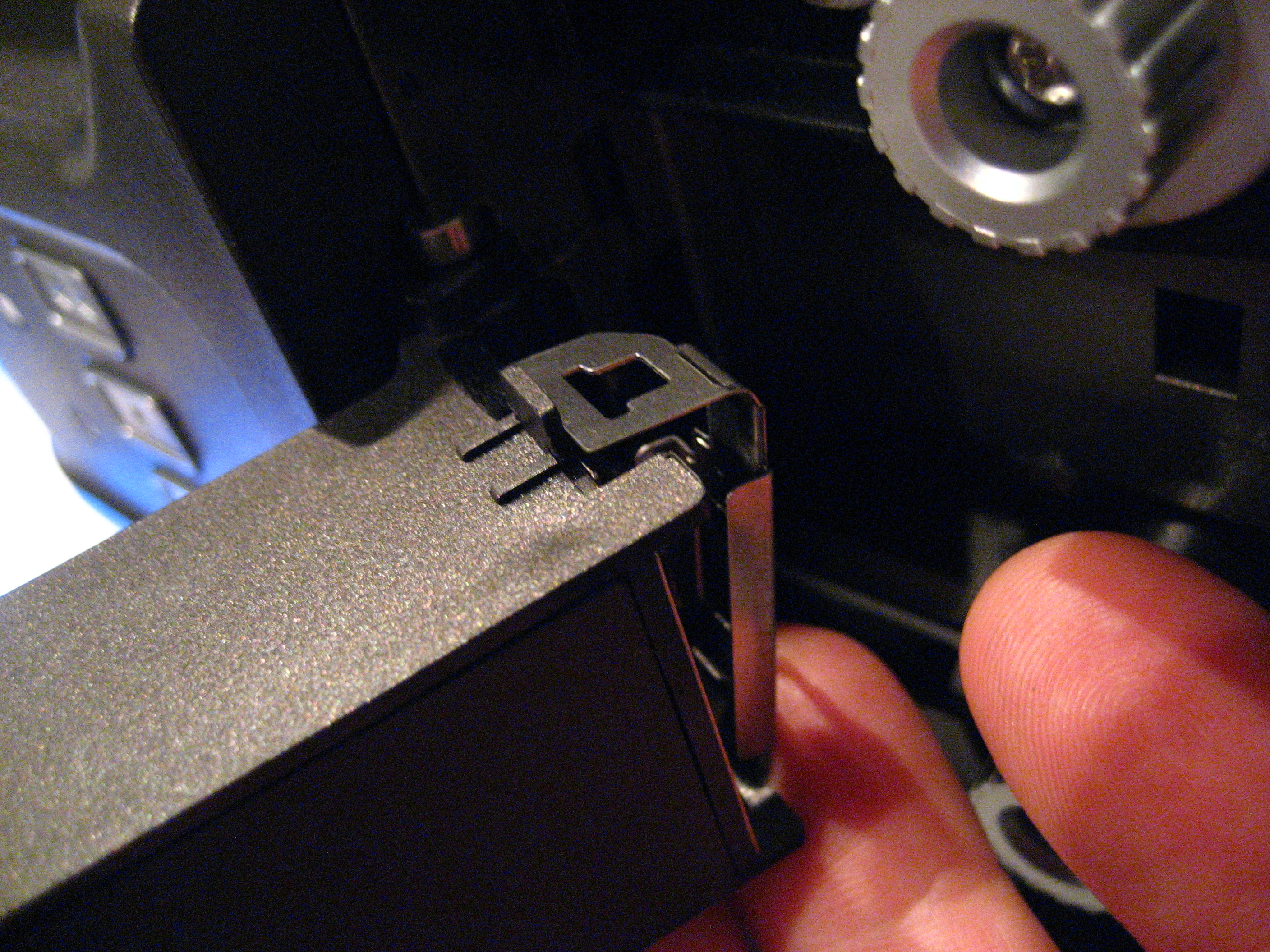

    run your finger over it. see how poorly made it is. and how sloppily it has been cut. INCREDIBLY...it has this really sharp edge, that actually sits up with a slight ridge, and this ridge is cut so that it runs THROUGH the SIDE OF THE FILM! I am pointing at this edge here:

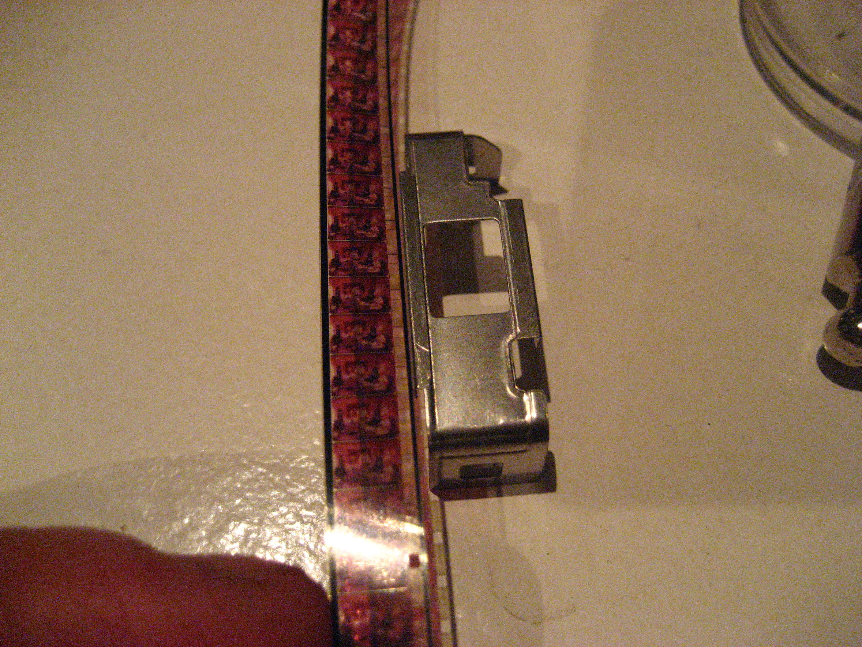

    and you can see where it lines up here:
    not surprisingly, it is about 1/3 of the way across the frame, exactly where I have been developing the scratches in my film. so you need to take a very fine file and give it a rounding off, finishing off the job that was meant to be done in the factory if they really cared....smoothing it out like this:
    then re-install. everything else seems to treat the film rather well. I would recommend doing this from the very start when you receive the unit. Hope this helps a few ppl and saves some precious films from being damaged.
