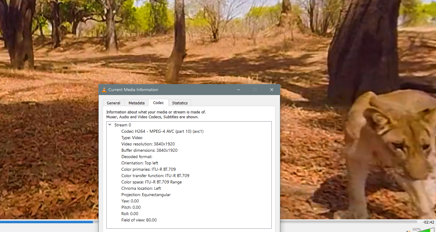

    VLC player shows the following media information:

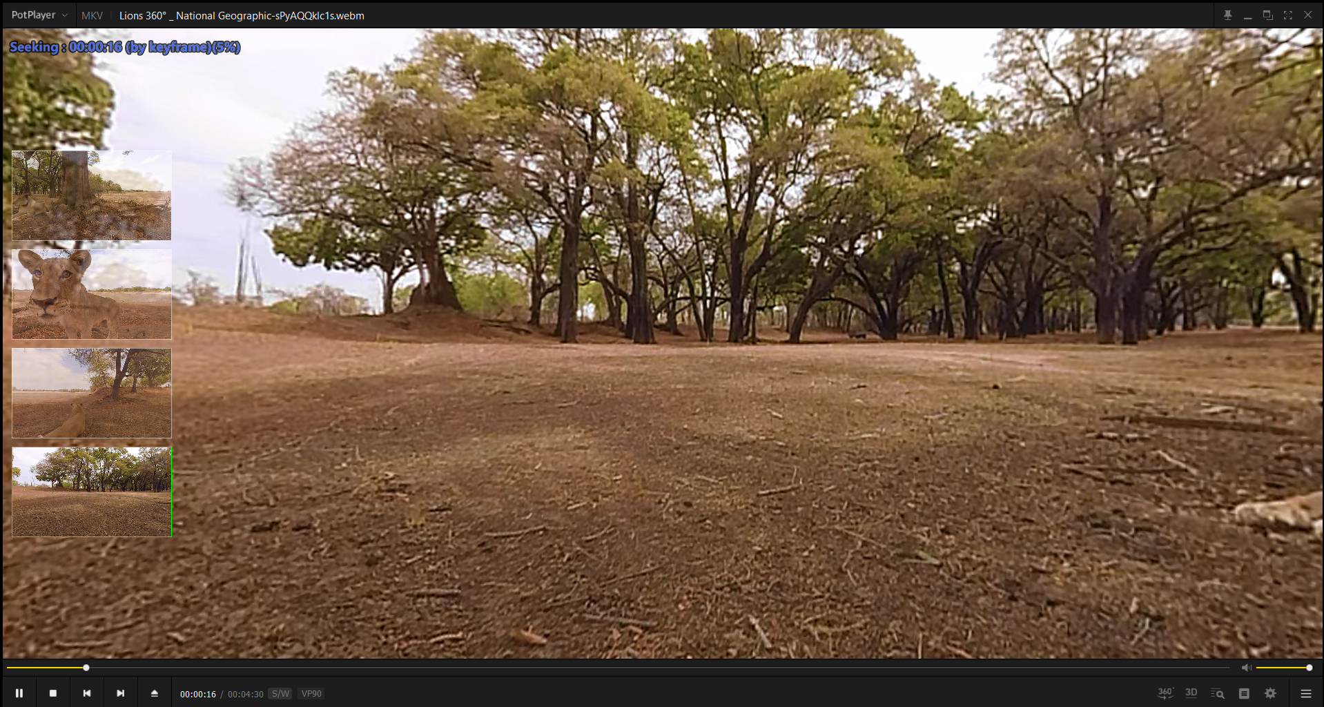

    [Attachment 48895 - Click to enlarge]
    If you open the video with Potplayer you'll see that there are 4 different interactive angles. You can choose one of them and move the view with a mouse click. Interesting. How can you download a 360 degree video? This wouldn't make sense. This video consists of 4 different angles.

    I guess the video is a composition of 4 x 90° components (maybe equivalent to 4 cameras used ??)
    Like hvq mentioned, potplayer shows 4 interactive angles.

    1. The media information from my download with youtube-dl (picture 2) is different from media information from hvq's video download with potplayer (or vlc).
    2. Potplayers 3rd angle (which is back scene, 180°) seems to be the same as in youtube-dl output!
