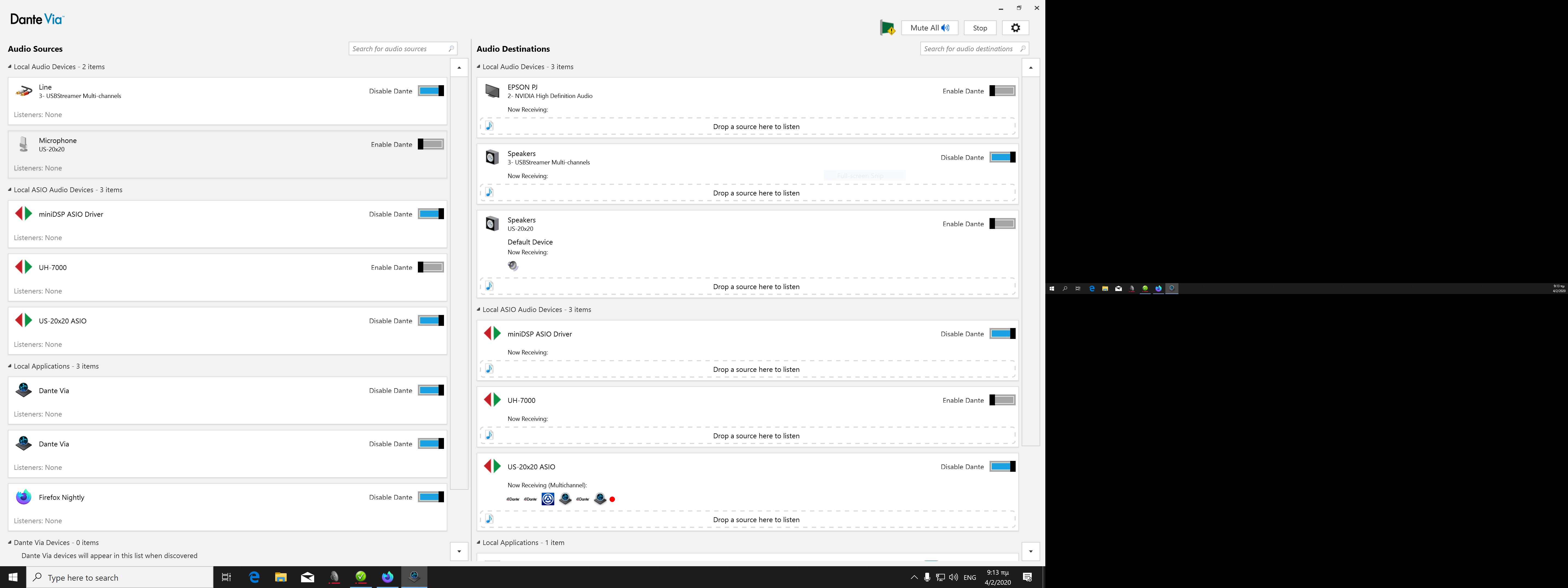

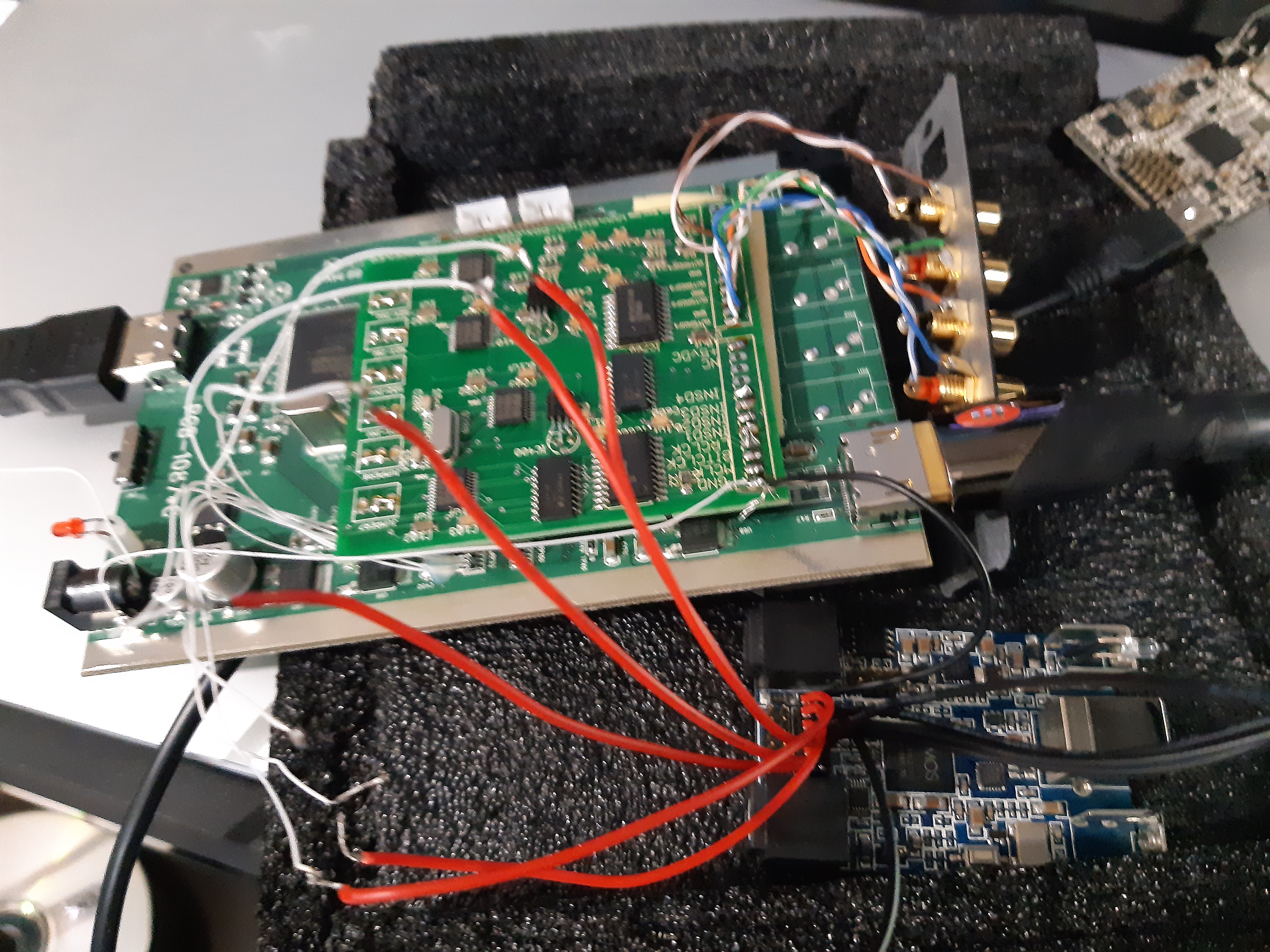

    This is a photo to show you how I used to transmit HDMI audio up to now
    [Attachment 51843 - Click to enlarge]
    This is a 7.1 DAC which has been modified.
    The audio is captured right before the analog section in i2S format. A i2s to SPDIF transceiver was giving the 8 LPCM channels in 4 SPDIF pairs.
    But under the light of AoIP this is not enough for my needs anymore.

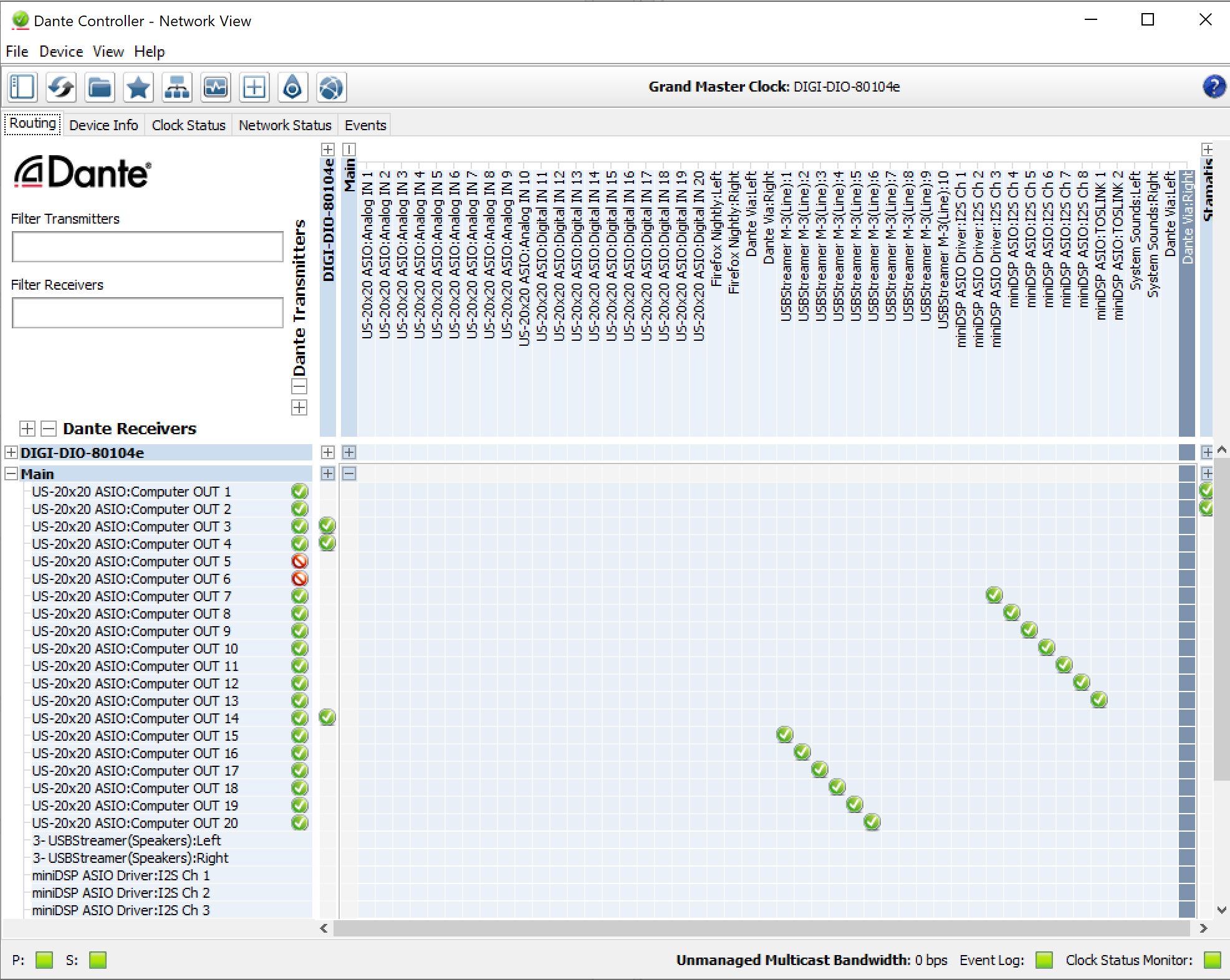

    The OPPO 95 has two HDMI outputs and you can configure to use the one for video and the other for audio. Once the stream is received WITH identifiable windows drivers PER CHANNEL, then DANTE VIA should be able to translate them into DANTE protocol.
    [Attachment 51841 - Click to enlarge]
    Then the signal can be sent to virtually infinite destinations through this matrix DANTE controller
    [Attachment 51842 - Click to enlarge]
    I need this signal management to pass the signal simultaneously to various processors. My main DIY topic of interest has to do with active speakers. That is a whole other chapter beyond the scope of this thread so I would not want to add more irrelevant information
    So, long story short: Once I can transmit successfully the 8 LPCM channels signal straight to my PC, I can stream it and MANAGE it.
    I hope I gave you the picture.

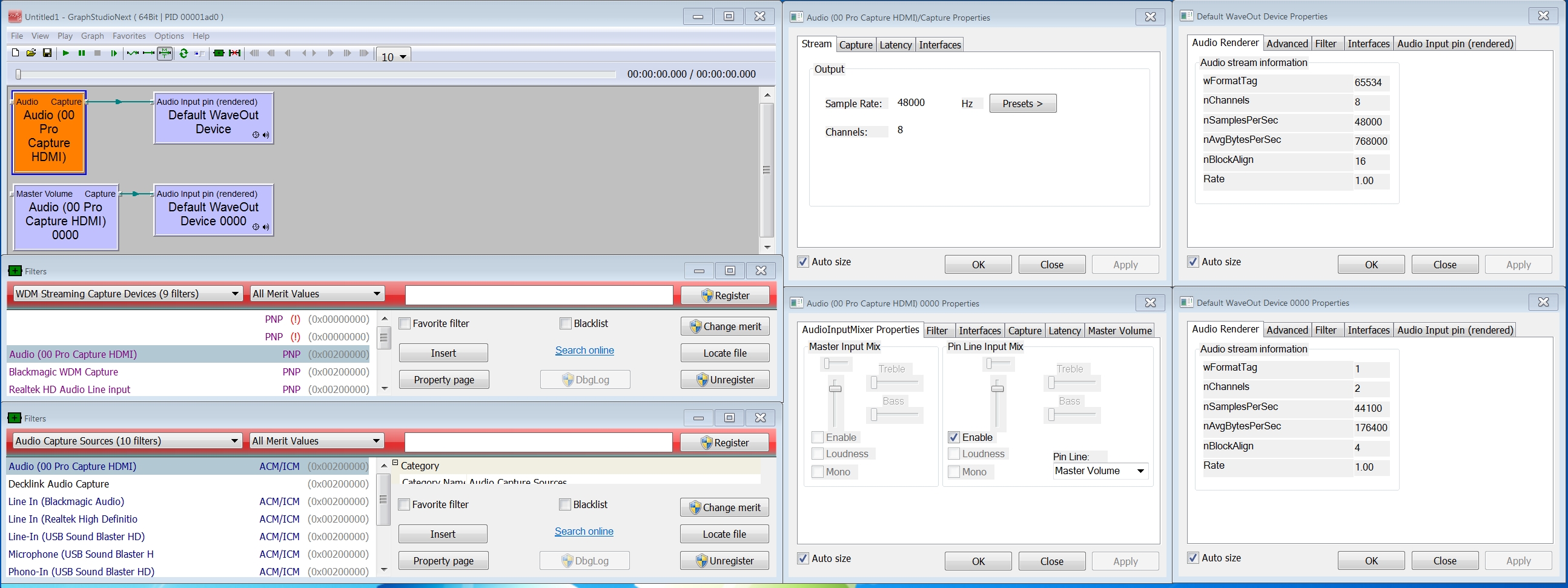

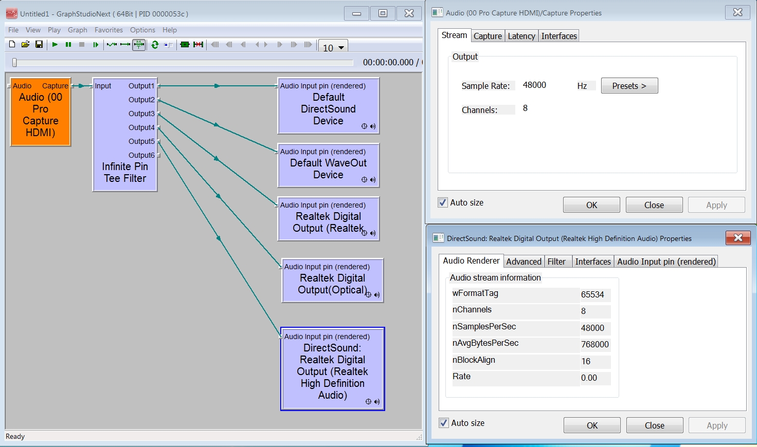

    Not sure if it's exactly what you do want but I made some screenshots from device manager, recording devices and audio options in Vdub2 related to Magewell pro Hdmi. The magewell has two audio capture pins and you need an application that can connect to the WDM that is the one that does multi channel (8) if the application do connect to the other pin you will have only audio down mixed to stereo 2 channels.
    Edit: Add the two capture pins info zip file
  5. THANK YOU so much!
    I just wanted to understand how windows acomodate the device. I believe that it will do the job. I am ordering the card tonight.
    Just explain to me please: which application exactly has to be started for mch operation? Is it included in SDK folders? Could I script it so as to run with windows permanently?

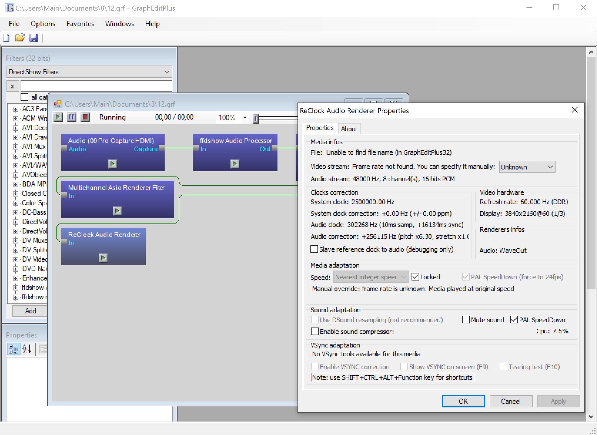

    As I view the situation but I can be wrong , I think there isn’t a specific application that must me started to initiate multi-channel support , it is supported natively by the Magewell card, and what you do need is an application that do support multi-channel and wdm audio class devices.
    The applications that I know that can connect to the wdm audio capture pin are the utility multiaudiocapture that comes as an example in the SDK, the Magewell capture express application that is provided for free to capture and stream video and audio multi-channel ( only mp4 and AAC), virtualDub2,and FFmpeg. There are a large list of magewell compatible software for capture and streaming perhaps some of them will do multi-channel, but I don´t know.
    If the application only supports wasapi, direct sound or MME it will connect I think to a specific capture pin in the Magewell and it will be limited to stereo 2 channel , if the application does support wdm and multi channel itself it will probably connect to the magewell wdm pin and you will get multi-channel support.
    shekh the virtualdub 2 developer as made the necessary modifications to VDub2 to support wdm audio class devices and Magewell cards in particular perhaps if you contact him he can clarify what is necessary to connect to the magewell wdm capture pin to assure a successful connection for using multi channel.
    Perhaps Dante Via does support wdm and can connect directly to the magewell wdm pin?
    GraphStudioNext also does support the Magewell Wdm pin connection and perhaps you can use it for your purpose .It's a graphical environment where you can design and test different workflows ( see an example for capture some posts before and a new oneImage

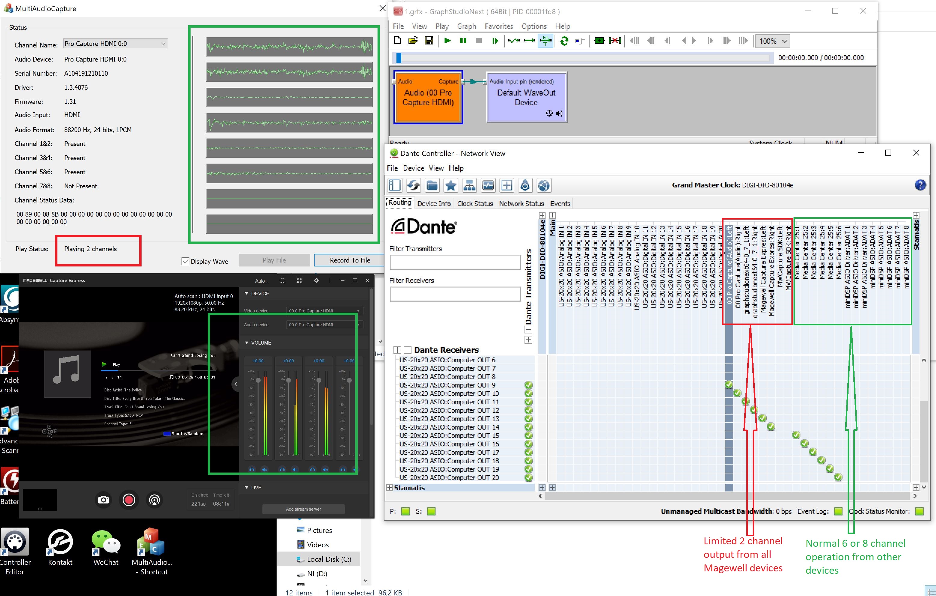

    However the news for the 8 channel output are not good for me.
    No matter what method I tried the card will either output front L/R channels or downmix to 2 channels.Image

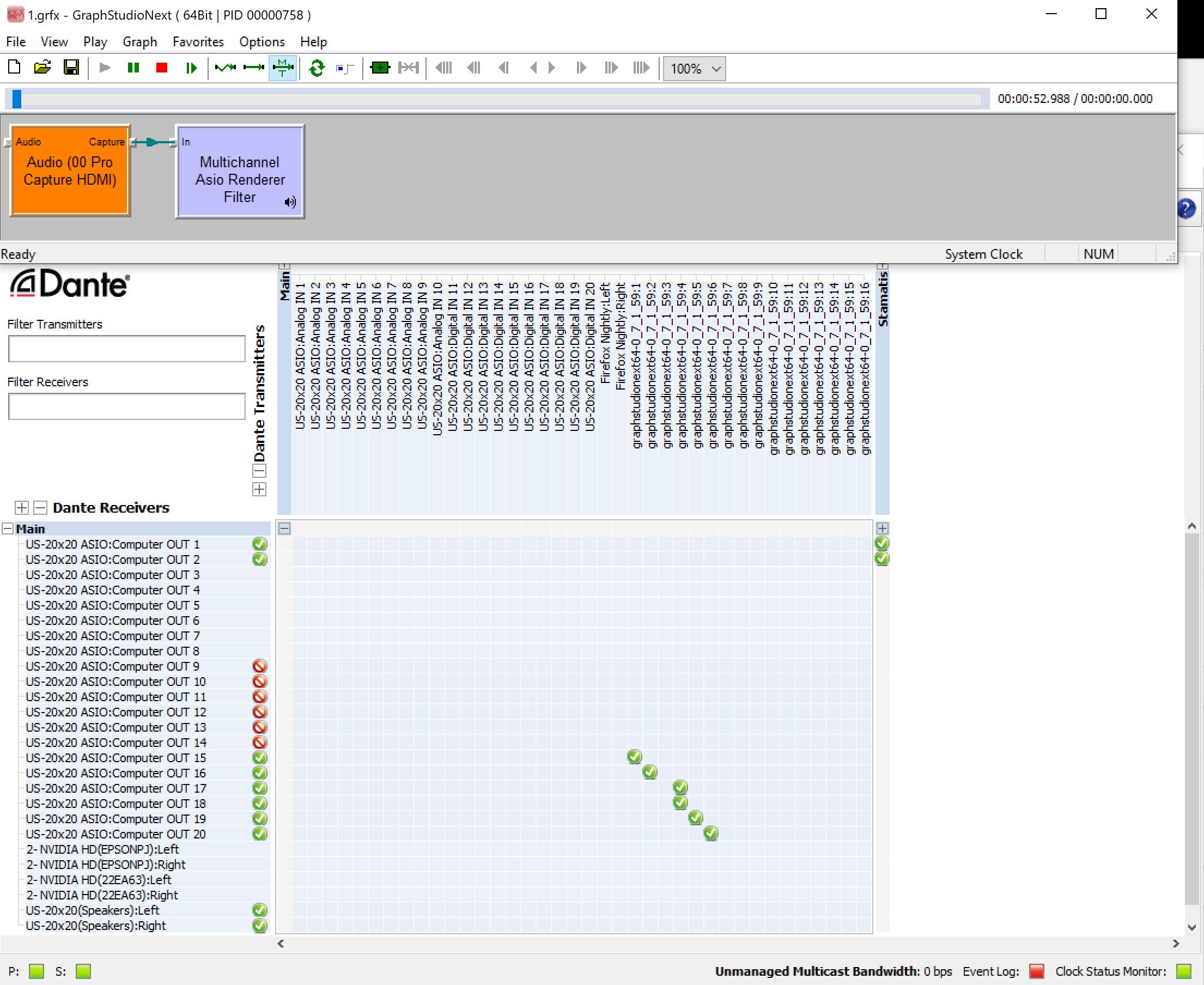

    [Attachment 52033 - Click to enlarge]
    Which is a shame really because the 8 channels ARE THERE! You can even see their waveforms!
    In terms of output the Capture pro is recognized as 2 channel device.
    I cannot get it to be recognized as 8 channel audio.
    I can see that the 8 channels are being succesfully captured but I take as output only the front left/right when using Capture Express or MultiAudioCapture.
    Using the DS graph I get a downmixed 2 channel output.
    Again, pls see the second screenshot in Dante Controller, where even the JRiver Media Center, which is merely a software engine, can be recognized as 6 channel device, and it works pretty well too.
    What really puzzles me is the fact that even using the SDK included 'MultiAudioCapture' example, the multichannel LPCM signals are being captured succesfully but only the front 2 are destined to the output.
    I had a look at the multichannel enabling directions but I am not a developer, I am a field-application guy, so I can hardly read these, let alone to understand them.

    I'm not sure what might be happening.
    Recording works fine with several tools multiaudiocapture, magewell capture express, virtualdub2 , graph studio next, etc
    Have in mind that there are two audio capture pins in the card and for multi channel audio only the wdm do works.
    Perhaps dante and other applications are connecting to the default pin that doesn't do multichannel.

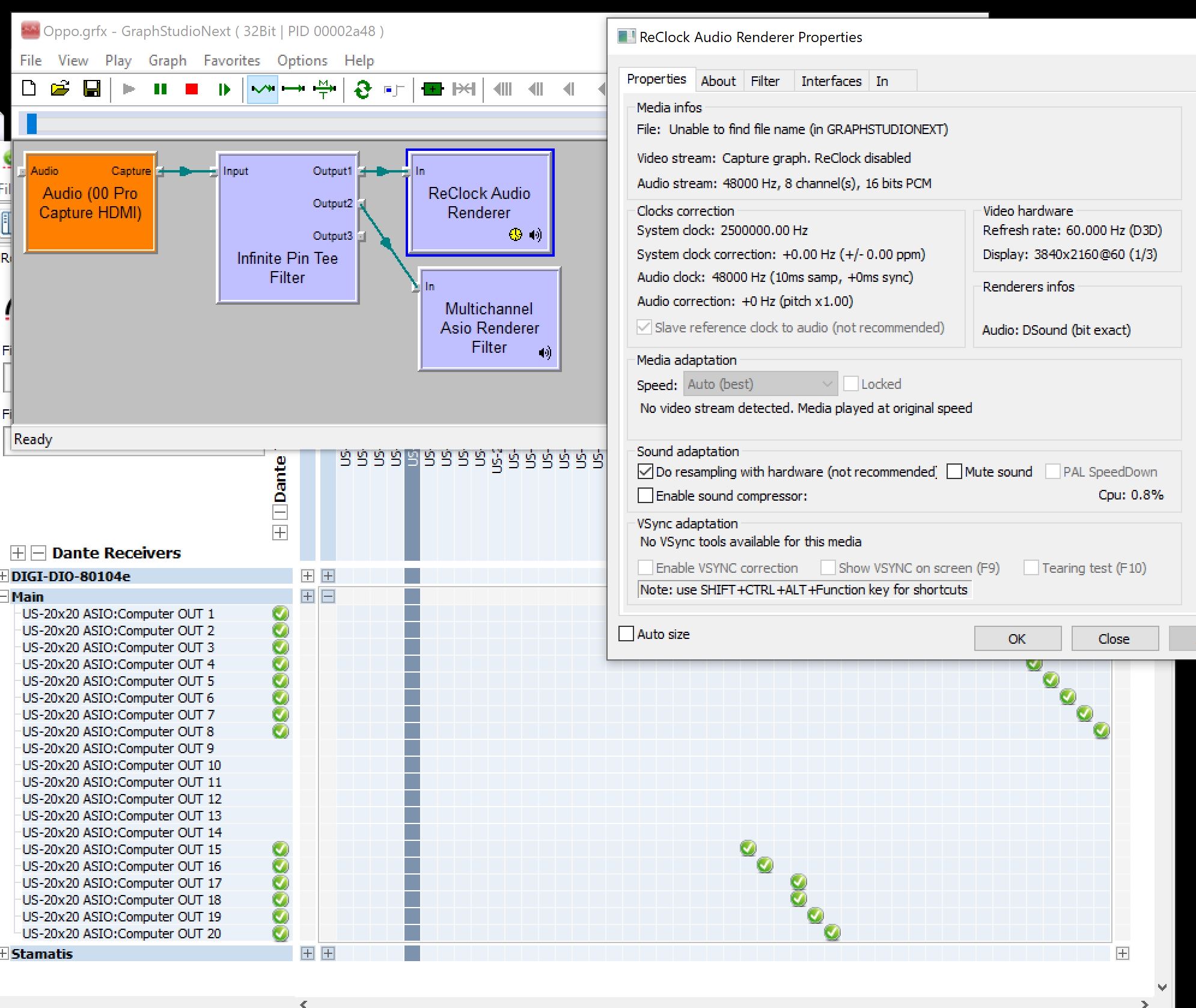

    After a frustrating period I found the solution. This magic driver which, apparently, was quite ironycally already on this site https://www.videohelp.com/software/Multichannel-ASIO-DirectShow-Renderer
    [Attachment 52216 - Click to enlarge]
    The driver when loaded will present not just 8 but 16 channels on my DANTE controller. All channels are normally seperated, it is a true multichannel streamer and, moreover, it is ASIO.
    BUT
    There still is another serious problem. After some time of operation (15 maybe 20 minutes) the sound gets distorted. It starts with fragmented pops and clicks and soon enough becomes seriously distorted, as if you play in very high levels.
    I have to stop the studiographnext, close it down and open it again. After relaunching the sound is perfect again, then after some minutes you start to get pops and clicks > distortion etc...
    It is as if you try to reproduce an audio file with very small buffer size and the device cannot handle it.
    Any clues?

  14. I am streaming @ 8 channels for a couple of hours now with this configuration.
    No phase shifts.
    No glitches or other distortion at all.
    I will report again.Image
    [Attachment 52375 - Click to enlarge]

  16. New configuration.
    Approx 6-7 hours of streaming witho NO phase shifts, just very rare pops, in fact none during the last hour.
    [Attachment 52380 - Click to enlarge]
    However, there seems to be enormous processing as shown there in sync correction. Cpu usage 7% to 8% (!) and my processor is an i7 7700K..
