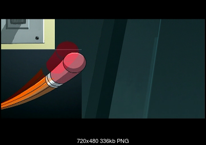

    Originally Posted by end-user View Post
    I'm not sure how I'd even recognize mangled chroma if it existed. How would I?
    Bob the video then look for blurred and/or striped colors on moving colored objects. It's especially visible in cartoons because of the saturated colors and large movements from frame to frame. Here the pencil is moving but the chroma is a striped mix of colors from the current field and the next field:
    are you suggesting that a BT.601 recording of a BT.709 broadcast is not actually lossless?
    I believe this is only a matter of how the video is flagged when it's output. Internally it probably handles them exactly the same.

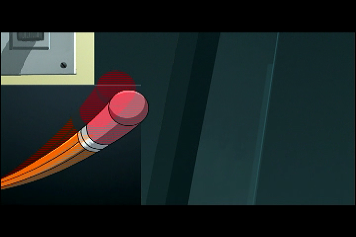

  22. Originally Posted by end-user View Post
    jagabo, when you say to "Bob the video", do you mean shake the recording window up and down when it's recording? Or during playback? Or during pause (when on playback)?
    I meant to apply a bob filter. The two fields are separated and then the missing scan lines are simply interpolated lines above and below. This is a simple and fast method of deinterlacing, though not the best visually as the picture appears to bob up and down by a scanline when viewed.
    In this other thread post #33, you mention that the chroma in the mp4 that jaibubwan provided in post #32 (clip from Denzel Washington movie) is messed up, but I can't recreate the blurred kind of image in your example above. How can you tell the chroma is messed up in his clip?
    It's hard to detect in that video as there isn't a lot of motion. But here's a crop from near the top left of the frame, early in the video, bobbed, speed reduced to 2 fps, with the saturation cranked up to make the colors more visible:
    Name:  XSPLIT TFF FULL.mp4.gif
    You can see that the colors are moving independently of the luma so they don't align correctly. You don't always see the stripes like in my earlier post depending on exactly what's going on.
