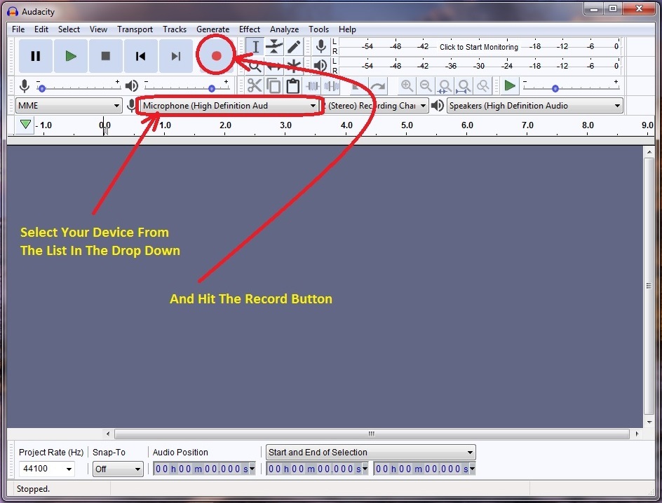

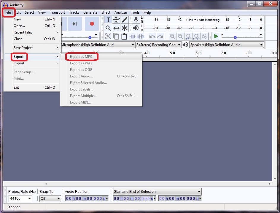

    Audacity is not complicated, Just select your USB audio capture device from the list and hit record, At the end of the track hit STOP, Then go to file, export as MP3. That's all.
    It gets complicated with any software not just Audacity when you want to automatize the process to save time especially if you have several tapes, There where you need to capture the whole tape side and divide into separate tracks, Set the gain ...etc
