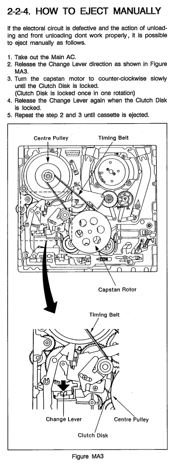

    Looks like a PITA on this model since the capstan motor drives load/unload. You have to take off the bottom case panel and turn the capstan flywheel by hand, releasing a lock at every turn. Here is the apposite page from the service manual.
    [Attachment 48156 - Click to enlarge]
    Nov 2011
    USA
    That matched perfectly. Like in the instructions I pressed the lever and turned counter clockwise till the clutch disk stopped but it didn't fix my issue. VCR still detects a nonexistent tape. I think Cassette tray lock is out of place as the cassette tray doesn't lock into place when pushed back and down.. Maybe that out of place tray lever causing a nonexistent cassette detection.
    Aug 2010
    San Francisco, California
    You don't turn the motor just once. You have to turn it and press the lever, turn it and press the lever, and so on, probably many times, until the eject cycle completes. Which means you have to watch the top part of the deck to see what's happening with the loader.

    Question how do I tell if there is not tape at all? I am suppose to repeat until? In my case there no tape and the tray is up so how would I know it completed it?
    UPDATE:
    I repeated until each spin got tighter until I heard a pop. The cassette tray lock was released and now locked in place with cassette but I don't think it fixed my problem yet. I will repeat this procedure with tape inside.
