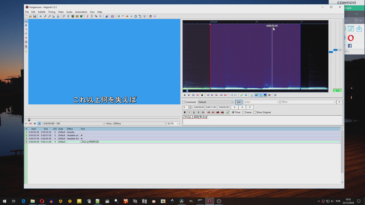

I'm using full range because all my equipment can deal with it unless it require a limited range or the source comes from a limited source.
No I did not.
My main concern was rendering time, rendering speed, file size and all the things we were talking about. Also, any of my playback equipment, besides my computer, can handle 4:2:2, my idea was to use the OP settings and see how it goes, so I didn't even care for levels or color matrix. My encodings are limited to YV12 4:2:0 and my AVS I use the propper conversion like:

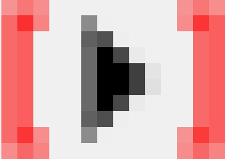

Since you asked, yes the levels are different and all the rest is a big mess.Code:ConvertToYV12(matrix="Rec709")
RGB Source
Converted
Gettings a close up we can see the mess:
RGB Source
Converted
I don't use this settings so I don't care too much about it, but fell free to show us a correct use or a sollution, I'm sure everybody will learn from it, including me.
That is why I don't use it and don't like it for video encodings, I use it for small stuff but never for audio or video encoding. The joke about "-color_range" was to show how deep inside the rabbit hole you have to go and when you get down there, it might not even be what you want or need. As I've demonstrated, genral users are gonna get wrong results and not even notice untill years latter.
I like it simple to avoid unnecessary mess and more problems.
