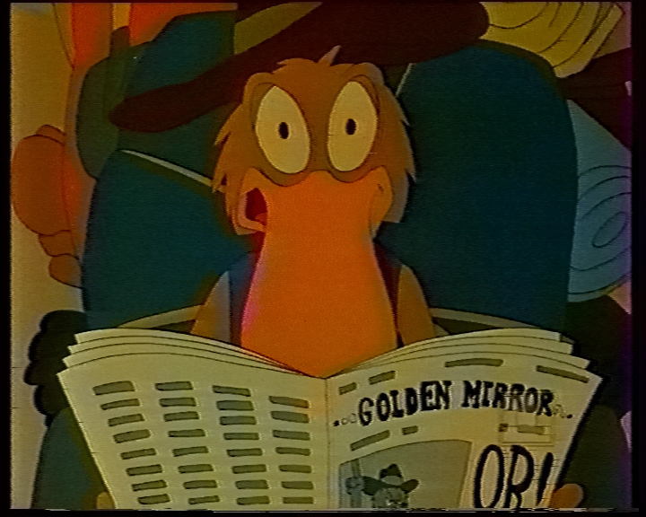

    Hi everybody! I'm from Russia, and this cassette was recorded in MESECAM. There is a problem - it has a lot of chroma noise, such as these pink spots:
    [Attachment 47239 - Click to enlarge]
    Is it possible to clean these spots? This video has another problem like chroma shifting, color bleeding - I corrected them as I could:

  2. Try this, it works great with cartoons generally; require the filters: TTempSmooth, variable blur, KNLMeansCL, camcorder color denoise (vdub):

  3. filtered / original:

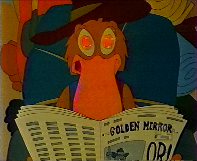

    Thank you so much! That is much better. But on the first frames pink spots still there. How can I set more stronger filtration? I tried to set more higher values for binomialblur - is it right?
    binomialblur(5)
    [Attachment 47260 - Click to enlarge]
    binomialblur(50)
    [Attachment 47261 - Click to enlarge]
    And is it possible to clean purple stripe on right side?
  5. These are strong settings already. You can try to increase the value for ccd such as
    CCD(30,1)
    or
    ttempsmooth (strength=8)
    (that's the maximum), and
    KNLMeansCL(h=8)
    or higher
