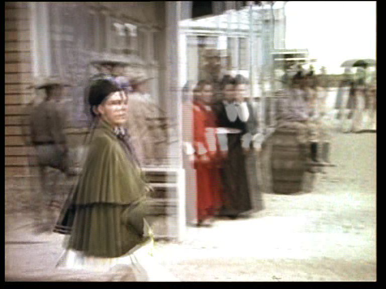

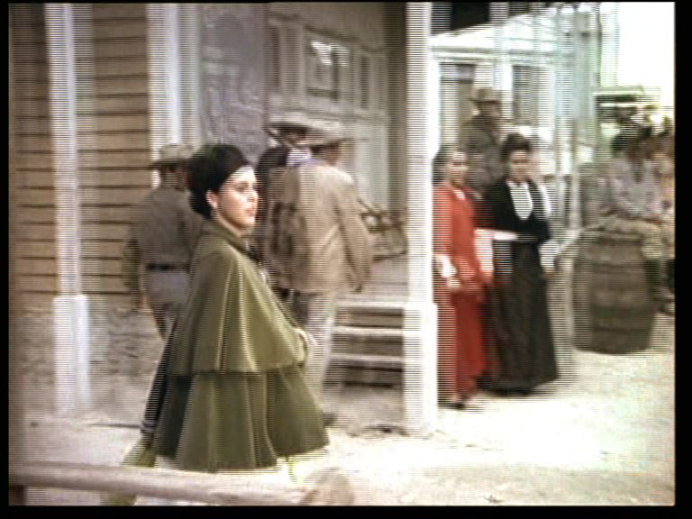

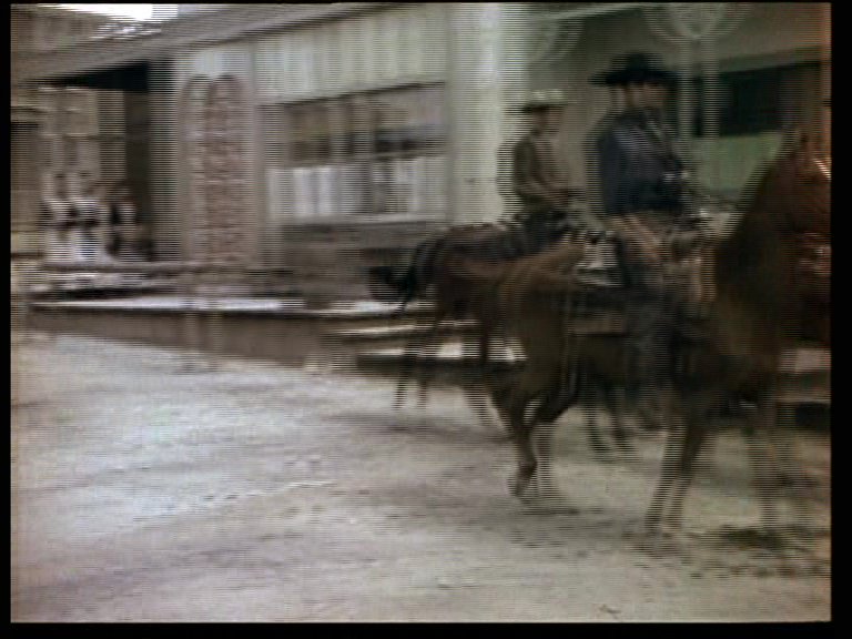

Hello - looking for some assistance on the best way to clean up this video, which is sourced to a PAL DVD and seems to have been poorly converted from unknown source.
There is a lot of what looks to me like frame blending or ghosting on most movement, along with combing. I'm not sure if this DVD was captured from an interlaced source and converted to PAL or what. I've attached a short clip and including some screenshots. I can provide a different sample if it would help.
I'm not concerned with any noise or other picture issues, I'd just like to improve the problems with the frame blending. Based on what I've read so far, smart bob followed by SRestore() may be the way to go. Although I've done a lot of encoding and editing of DVDs/videos, I still don't have any experience with running AVIsynth scripts to do this kind of work, so wanted to ask for any help/guidance before proceeding. Thanks!

You want a good double frame rate deinterlace followed by SRestore: The basic script:
Code:Mpeg2Source("test clip2.d2v", Info=3) Yadif(mode=1) # or better but much slower: QTGMC() SRestore() -
