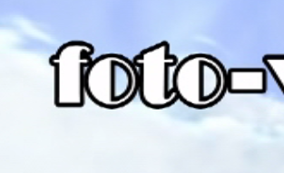

    Original DVD:
    [Attachment 43783 - Click to enlarge]

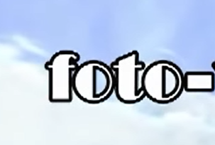

    Ripped mp4 (same resolution):
    [Attachment 43784 - Click to enlarge]
    Probably on the original DVD there is something like a blur filter (am I right?) and after ripping it's disapearing. Is there any method to keep the quality as the original DVD? Maybe upscaling or add some filters?
    Thanks.

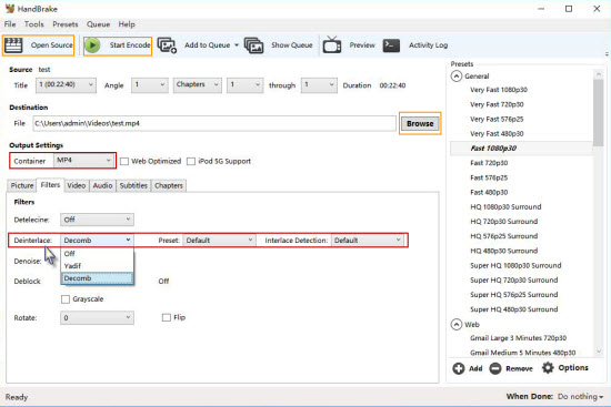

  20. It seems that your video was badly deinterlaced. You can try Handbrake and deinterlace your DVD better. Click image for larger version
