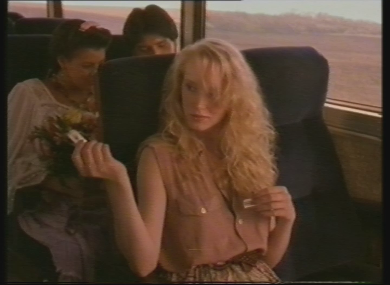

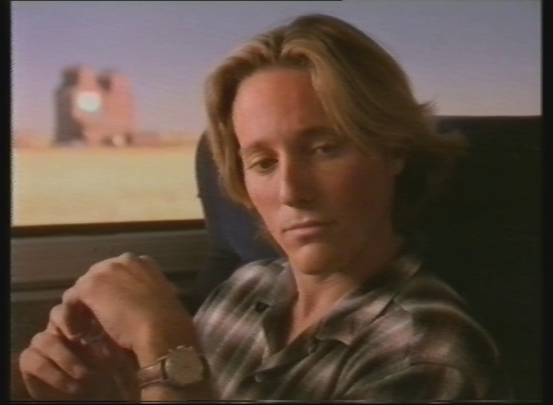

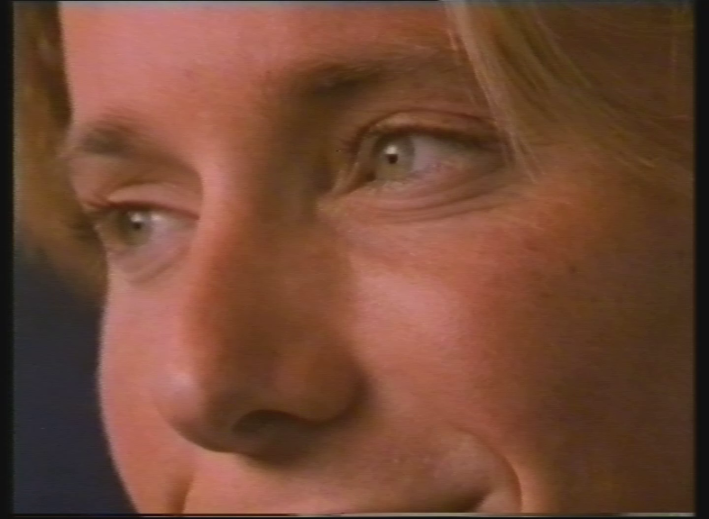

  1. Hi I've been digitising some old video8 tapes but have noticed some artefacts occurring which is making me hesitant about continuing until I can figure out what is causing the issue. I was originally going via premiere using pal avi capture but I wasn't sure if it was a poor deinterlace that was occurring on capture so tried via da vinci resolve using dpx frame capture but seem to get similar results. Areas of concern are around the faces and arms of the guy and girl in the video where theres just a rough edge that doesn't look quite right.
    The capture is off a Sony SLV-T2000 with a line tbc and dmr-es15 frame tbc going into a blackmagic ultrastudio express via s-video bnc connections.
    Any ideas at all?
    [Attachment 46951 - Click to enlarge]
    [Attachment 46952 - Click to enlarge]
    [Attachment 46953 - Click to enlarge]
    Thanks in advance

  3. Original res was 720x576 upon capture, the artifacts are the same on the source prior to any export, this was just a quick preview to demonstrate the point.

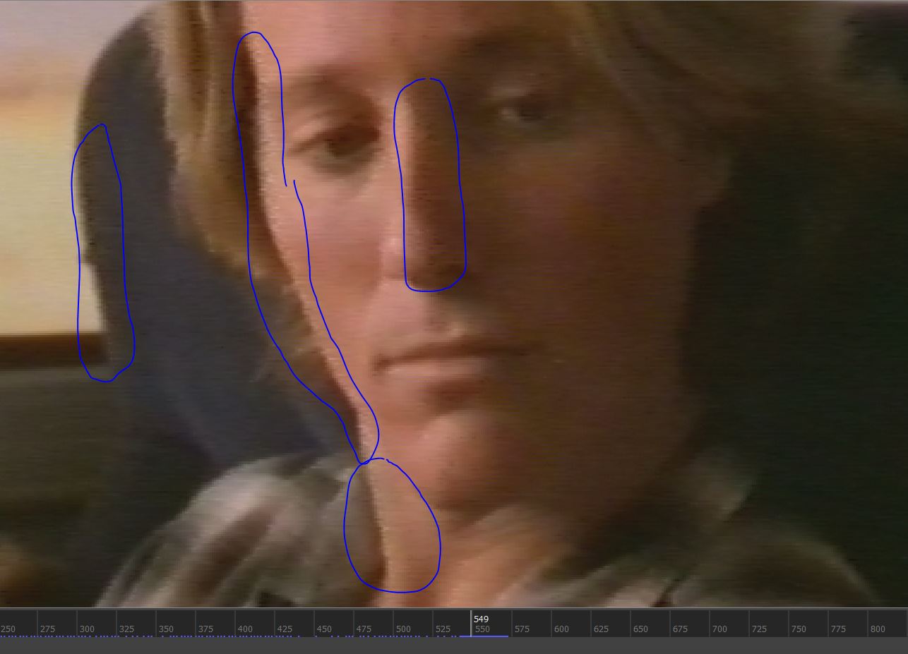

  7. Sorry maybe hard to see unless on a large monitor I've highlighted a zoomed in shot to show the areas I'm talking about. Image

  9. Member Bernix's Avatar
    Apr 2016
    Europe
    But it is on whole picture, just more noticeable on edges.
    Bernix
  10. Yea whole image agreed, problem is even though I can get rid of the rest with artefact removal and deinterlacing, it isn't removing these edges from what I've managed. As I understand it the interlacing on video8s is vertical correct? Would this cause issues if the deinterlacer is trying to deal with the video as if it has horizontal lines?

  12. Turn off any sharpening or noise reduction controls in the VHS deck, ES15, and capture device. You can get much better results with software.
    Avoiding it is best of course, but if you're stuck with it... Attached is a sample where it's largely cleaned without damaging the rest of the video too much. <edit> To be clear, I applied heavy noise reduction around edges, and light NR over the rest of the image. I also adjusted levels and eliminated interlacing on some frames. </edit>
    You also have bad levels. Make sure the es15's levels are set to input lighter, output darker. Then adjust the capture device's proc amp to get decent black and white levels.
