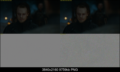

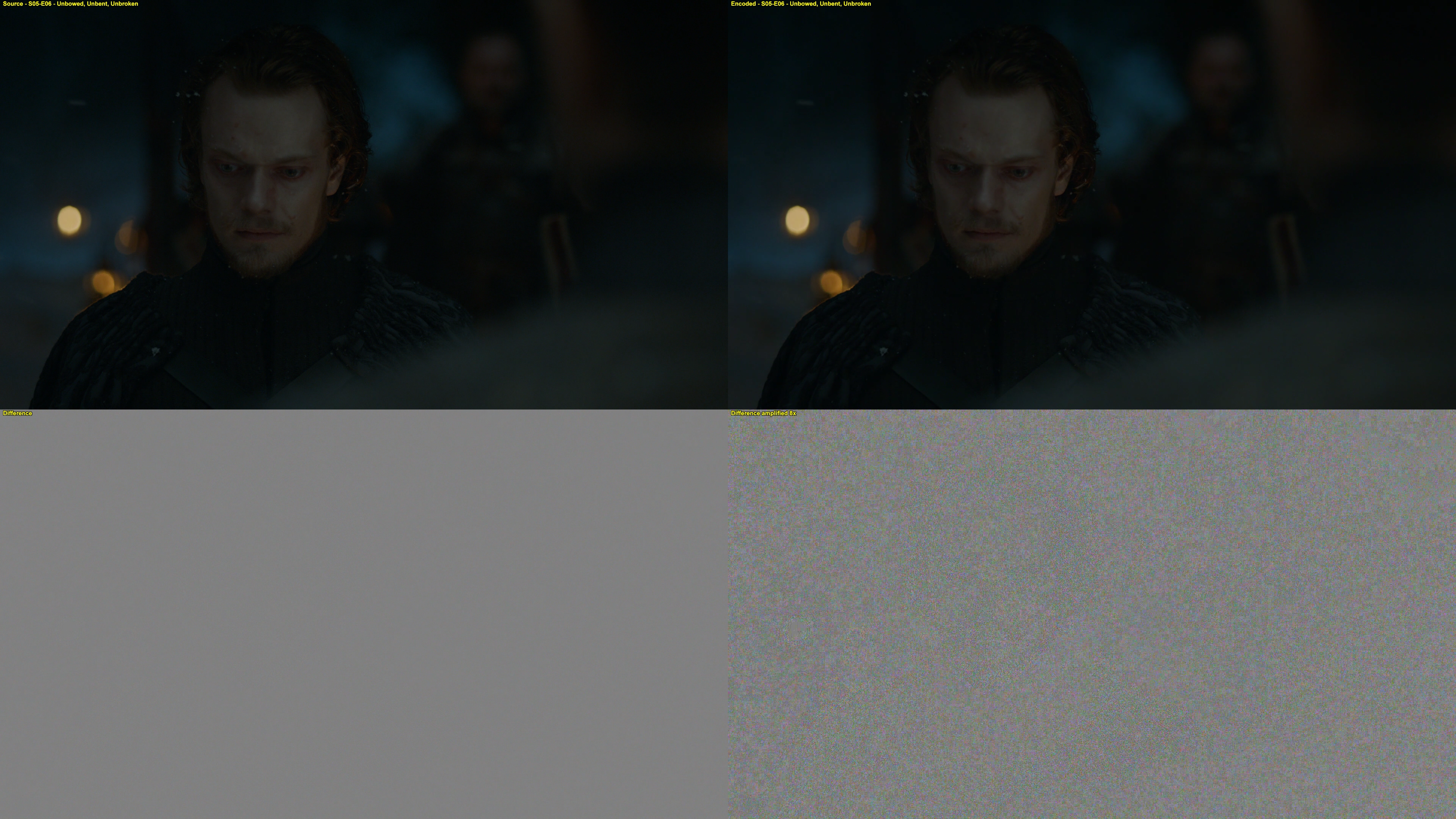

    I ran some tests on some clips and decided to post some results.
    See if you can guess which was encoded with x264 and which was Quick Sync.
    The Quick Sync file size
    File sizes:
    x264: 122 MB (128,698,912 bytes)
    Quick Sync: 126 MB (132,870,731 bytes)
    These are the x264 settings I used, I think they provide a reasonable quality encode.
    cabac=1 / ref=4 / deblock=1:-1:-1 / analyse=0x3:0x133 / me=umh / subme=10 / psy=1 / psy_rd=1.00:0.15 / mixed_ref=1 / me_range=24 / chroma_me=1 / trellis=2 / 8x8dct=1 / cqm=0 / deadzone=21,11 / fast_pskip=1 / chroma_qp_offset=-3 / threads=18 / lookahead_threads=3 / sliced_threads=0 / nr=0 / decimate=1 / interlaced=0 / bluray_compat=0 / constrained_intra=0 / bframes=8 / b_pyramid=2 / b_adapt=2 / b_bias=0 / direct=3 / weightb=1 / open_gop=0 / weightp=2 / keyint=240 / keyint_min=23 / scenecut=40 / intra_refresh=0 / rc_lookahead=60 / rc=crf / mbtree=1 / crf=19.9 / qcomp=0.60 / qpmin=0 / qpmax=69 / qpstep=4 / ip_ratio=1.40 / aq=1:1.00
    Sorry about the file size of the screenshots, I didn't want to change anything, just save the screenshot with MS Paint as is.
    x264 vs Quick Sync Comparison 1
Name:	x264 vs Quick Sync Comparison 1.png
    x264 vs Quick Sync Comparison 2
Name:	x264 vs Quick Sync Comparison 2.png

  2. The second image is QS. All the small low contrast detail is gone.

    Yeah "x264 vs Quick Sync Comparison 2" is the QS.
  4. By the way, you should always post the original image along with the encoded images.

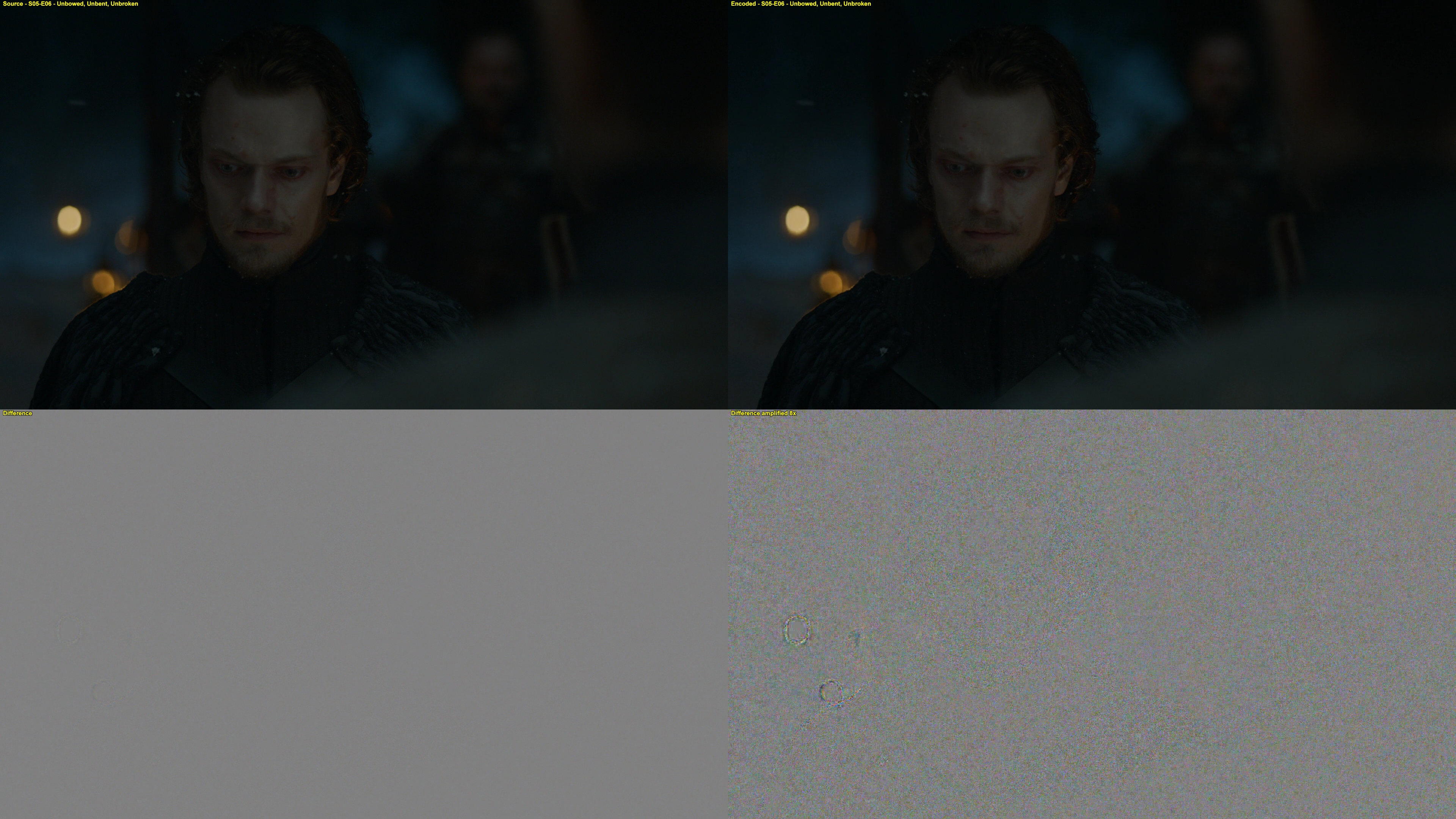

  17. It's basically the same as the other thread . There are some good tips in that thread on how to "see" differences if your eyes are not used to seeing these types of things, or if your display is hiding things or calibrated differently
    If you brighten up the encodes , you will see right away, there are significant differences. The fine details, grain are smoothed away in the QS encode . You would need significantly higher bitrate (or perhaps better settings might help a bit ) to be closer
    I like to use avspmod, so I can swap between them with the number keys. You can load original, A,B, etc... in different tabs, and they are aligned . You can use something like hdragc or levels to brighten it up if you need to

    One of the big reasons it's important to retain small low contrast detail (aside from the fact that the job of the encoder is to reproduce the source as accurately as possible given whatever constraints are imposed upon it) is to prevent posterization. This can be seen in shallow gradients, especially in long, low motion, shots, harder to see in a bunch of half second high motion shots.
    One "weakness" with x264 is that it tends to distort fast moving edges. But this is an intentional tradeoff. The warping is visible when you A/B flip but not during real time playback. If the slight distortion isn't visible with normal viewing, but saves significantly on bitrate, this may be a good tradeoff.
    I've also examined motion vectors when comparing QS and x264 videos (some decoders like ffdshow can show them). QS often finds far fewer for some reason. Even at times when you think it should have no trouble seeing them.

    It's not like "close" or a few frames here and there that are very close... every frame is substantially worse in the QSV encode . You probably don't even have to label it
    e.g. interleave (in this example, I didn't include source, but you should always compare to source at some point too). hdragc is used to boost the levels, brighten the shadows preferentially
    q=FFVideoSource("S05-E06 - Unbowed, Unbent, Unbroken.mkv").hdragc().subtitle("quicksync")
    x=FFVideoSource("S05-E06 - Unbowed, Unbent, Unbroken x264-19.9.mkv").hdragc().subtitle("x264")
    interleave(q,x)
    If you wanted to, you can use FFInfo() to get info on , the type of frame (I,B,P) for your analysis . The info can be helpful for comparisions maybe tweaking settings (where is an encoder weak, maybe some I:P:B ratio and/orquantizer can be adjusted, maybe more or fewer B-frames , etc...)

  23. I cross posted with jagabo there , but he suggested the same interleave method
    I think you should add the hdragc (or something similar) , because I have a feeling your eyes aren't used to seeing this sort of thing, or your display is setup to crush dark details , maybe it's a lower bit panel, or calibrated a bit funky, or something

    In my initial post, I showed two screenshots and a script showing how I compared them.
    The initial response was:
    For someone like me, who only occasionally works with video, that statement doesn't mean much.
    Now, if jagabo's initial response had been something like:
    You can see the difference clearly by using the following:
    source = WhateverSource("source.ext")
    enc1 = WhateverSource("enc1.ext")
    enc2 = WhateverSource("enc2.ext")
    Interleave(source, enc1, enc2, source)
    Or by using some other methods such as the ones described in posts #19 and #20, neither of which I've ever seen before. That would make a much better response than by simply stating what is wrong with it.
    A simple explanation on how one derives a conclusion is all that's needed. But that's just me.
    Now, the question remains; do I follow any suggestion for comparing clips? For all I know, the scripts could be crap offered up by someone who's messing with me and sending me on a wild goose chase; credibility of that person already in question... why should I trust the advice now?

    I took a look at the x264 and QS AVC videos, which I made into a lossless comparison. Due to me using lossless video I got rid of 29 out of 30 frames and made it play at 1fps. It comes out to 192 frames. I probably should have done 1 out of 24 frames but whatever. The top left and bottom right squares are QS, and the top right and bottom left is the x264 sample. Encoded with lossless FFV1.
    As a AVC Hardware encoder it certainly looks like one of the best around and would certainly use it for realtime streaming or whatever. But if you have the time, x264 will still look better at any given bitrate (assuming you use some of the slower x264 presets).
    LoadPlugin(".........LSMASHSource.dll")
    A=LWLibavVideoSource("............S05-E06 - Unbowed, Unbent, Unbroken x264-19.9.mkv").crop(962,0,0,-542).AddBorders(2,0,0,2).subtitle(align=9, "x264", text_color=$7CFC00)
    B=LWLibavVideoSource("............S05-E06 - Unbowed, Unbent, Unbroken.mkv").crop(0,0,-960,-542).AddBorders(0,0,0,2).subtitle(align=7, "QS")
    AA=LWLibavVideoSource("...........S05-E06 - Unbowed, Unbent, Unbroken x264-19.9.mkv").crop(0,540,-960,0).AddBorders(0,0,2,0).subtitle(align=1, "x264", text_color=$7CFC00)
    BB=LWLibavVideoSource("..........S05-E06 - Unbowed, Unbent, Unbroken.mkv").crop(962,540,0,0).subtitle(align=3, "QS")
    N=StackHorizontal(B,A)
    S=StackHorizontal(AA,BB)
    StackVertical(N,S).SelectEvery(30, 0).AssumeFPS(1)
