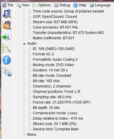

[Attachment 46414 - Click to enlarge]
It seems there is a delay already in the MTS, and maybe this is what causes the problem. But I just don't know how to handle this in my case? I never dealt with this delay so far, but as I mentioned on computer the DVDs I created played fine. It is only problem on the desktop player. This is weird. How can the DVD play fine on the computer, when it seems this delay should have been added??? What do you suggest to do now?

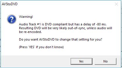

And two other thins that makes me unable to stick to AVStoDVD now, though I wouldn't mind using it:
1. it detects the delay in case I feed the raw file, but in case I import the Sony Vegas project export mp4, it just writes different error notifications about channels and that the DVD will likely to be out of sync. So in this case I have no information about how much delay should be set, nor the software. This is not a good way to go.

Since you did re-encode the audio 256 kbps >> 192 kbps there seems little harm in letting avstodvd do that as suggested. You just need to set the bitrate in the dvd edit section.
Now I was fooled by the mediainfo reports and avstodvd is likewise. But there is a avisynth script lurking in the edit section and I would have thought if you edited out all the lines that talk about field-order, field-splitting etc. you will create a progressive dvd regardless.
One thing you may also wish to revaluate is how you ended up with a wrongly reported source. If this is something you did then it may be possible to correct and programs will then not be 'fooled' -
So that indicates an muxing / authoring issue. Because the delay offset is set in the muxer. You might be able to fiddle with the delay in those other authoring programs too , but I think they might have other problems

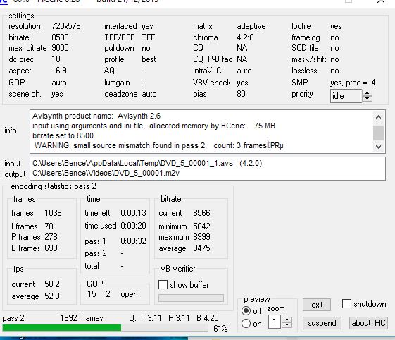

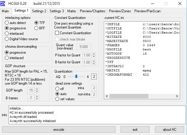

On the other hand, AVStoDVD uses different settings then me in HCEnc, I will try to implement those and see what happens. Maybe that is causing the problems.

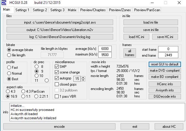

This is mine:
[Attachment 46421 - Click to enlarge]
[Attachment 46422 - Click to enlarge]
This is AVStoDVD

But there is something I still want to try. In AVStoDVD, where is the option to set audio delay? I examined a factory made DVD that plays fine both on my computer and desktop player and I noticed a difference: in Media Info I can read it has an audiodelay set. In case of my DVD's there is no such flag. How can you add this in AVStoDVD. I want to set it to see that maybe this is the thing that the player is missing.
Factory made DVD with the delay info:
[Attachment 46434 - Click to enlarge] -
Yeah, I found it but this doesn't reflect in the file later. I open the output in mediainfo and no report of delay. I think when you set the value in avisynth the muxer just cuts the audio accordingly. I would like to achieve that the delay would be reflected in the vob mediainfo. I wonder how they save this info to the file in the factory...
The old adage says "If it is not there then it can not be reported". I looked at 2 commercial dvds and neither show any audio delay.
