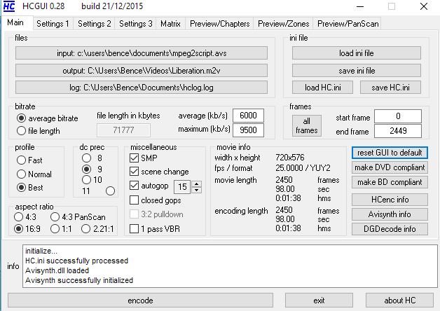

    HCGui settings:
    [Attachment 46186 - Click to enlarge]
    [Attachment 46187 - Click to enlarge]
    All the other settings are on default

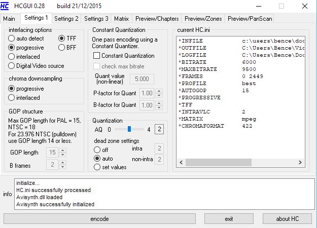

    I don't think the Chroma sampling should be 4:2:2 this is not standard for DVD, it should be 4:2:0.
    Not sure where this is coming from, possibly the Avisource codec, or the source file
    You could try adding ConvertToYV12() to the script (perhaps before the resize) and see
    if the ChromaFormat line disappears from the "current HC.ini" on the settings 1 tab
  10. Yes, few devices will support MPEG 2 with 4:2:2 chroma subsampling. Specify 4:2:0. On my computer the source filter was putting out 4:2:0 so I didn't have to specify it. Add ConvertToYV12() to the end of the script. Also check the Settings 3 tab on HCGui. And try pressing the Make DVD Compliant button on the Main tab.

    I modified the code and set the settings to 4:2:0, and now the video starts without problems on all TVs. However there is still a problem. On computer and on one of my Philips TVs, the file plays perfect and the image is good. However on my other Philips TV the image is bad. That is, the edges, especially the strings on the guitar are jagged, just like in a badly resized interlced video. What can cause this? Isn't it because the HCEnc output file has BFF flag, and the TV interprets it as interlaced, in spite of that it is progressive (I selected it in the settings)?
